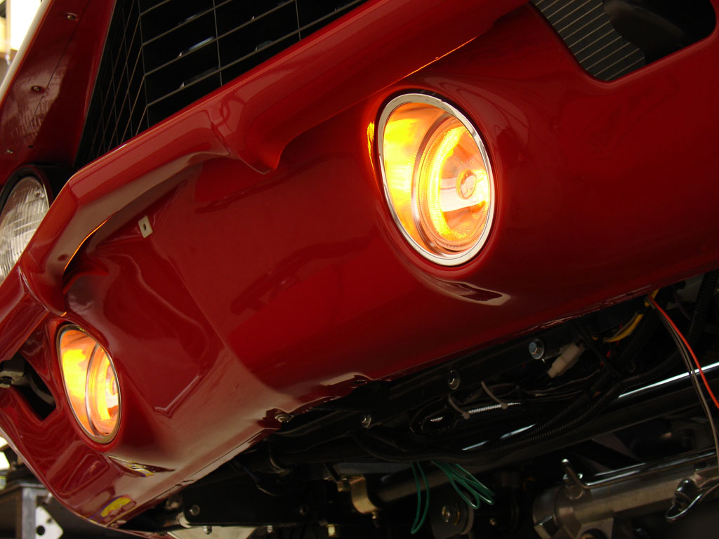

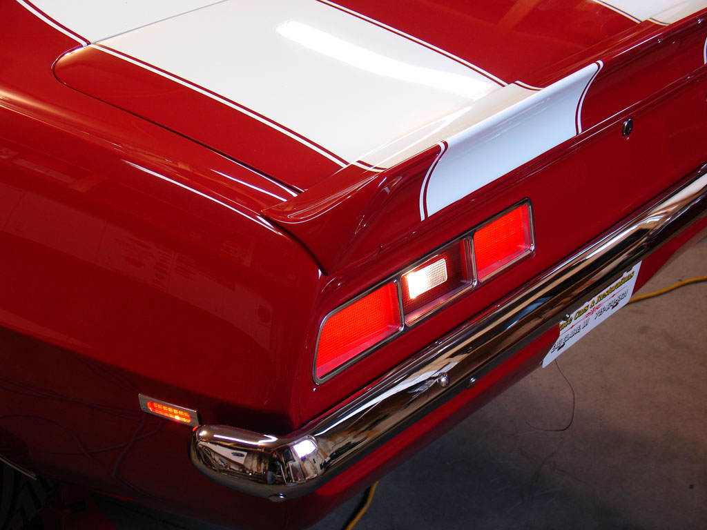

Progess on the wiring, marker lights and
reverse light test:
Digitails LED tail lights:

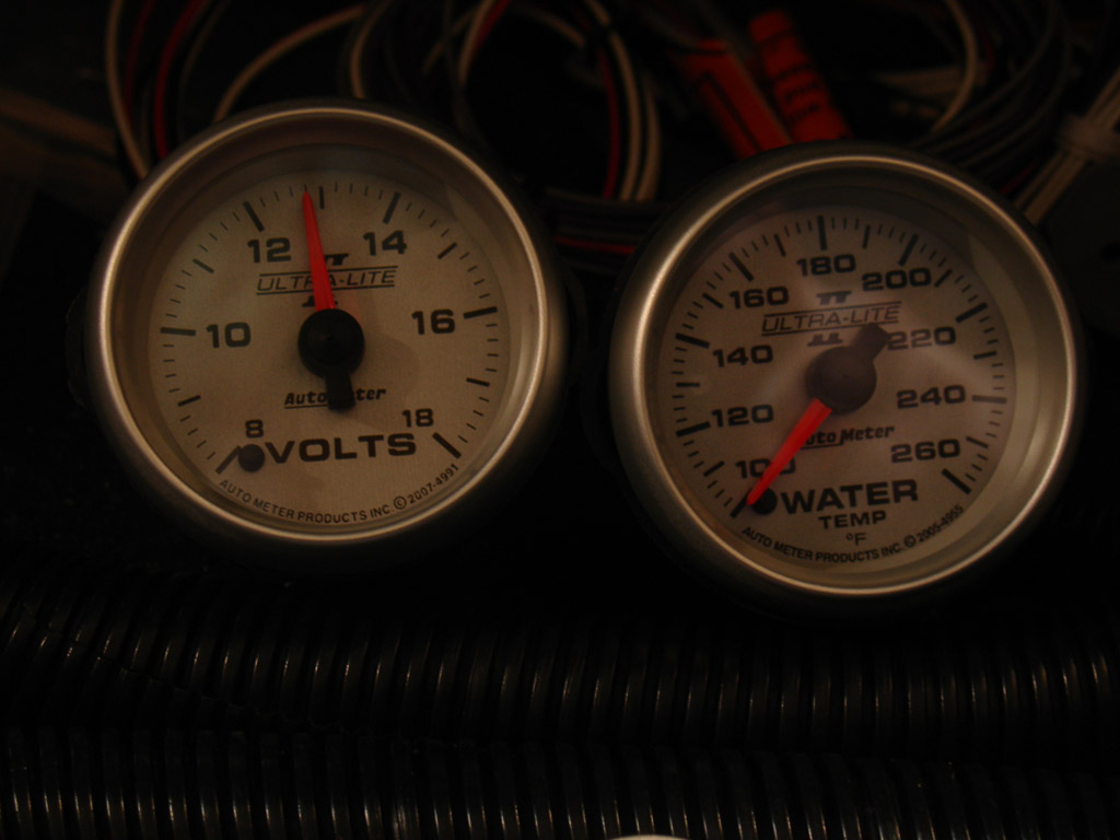

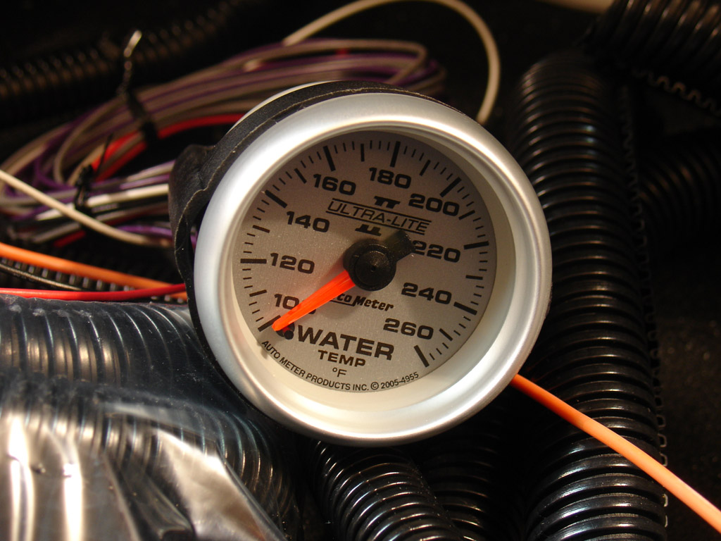

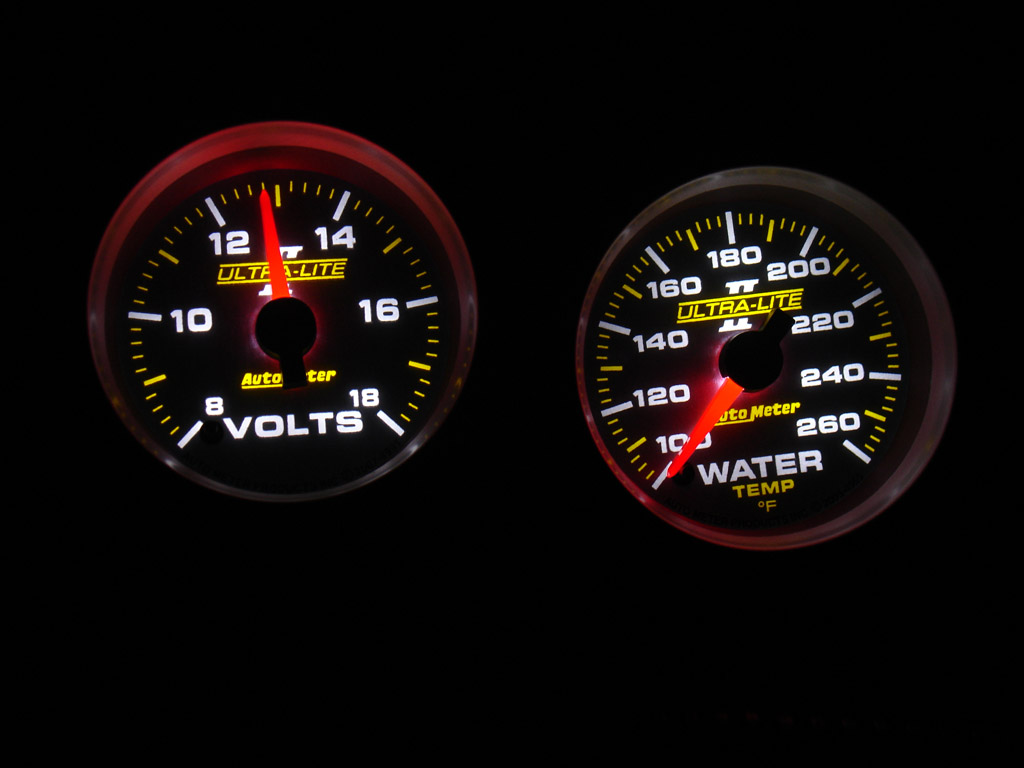

Lighting test for the new Auto Meter Ultra
Lite II gauges which use LED lighting.

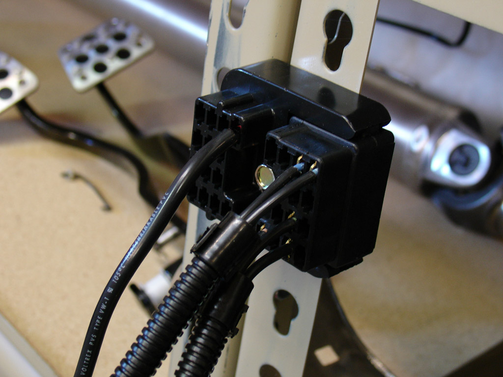

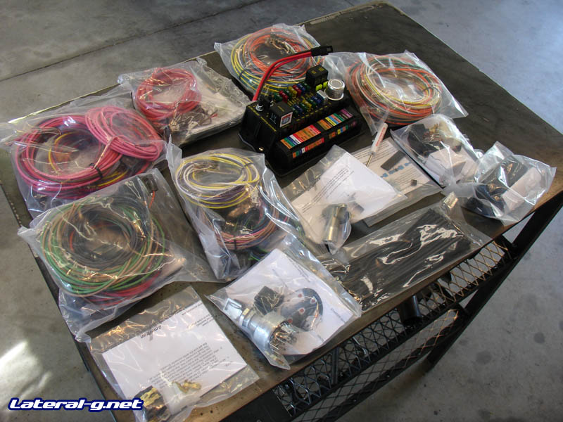

I'm using an
American Autowire Classic Update kit.

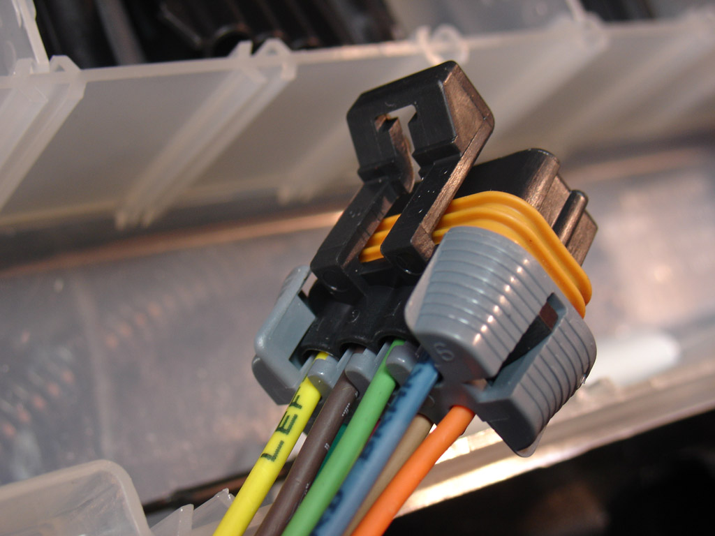

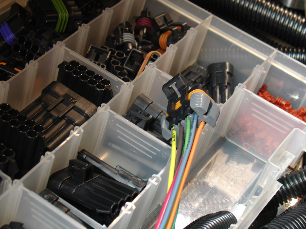

I'm using metripak connectors for most of
the connections.

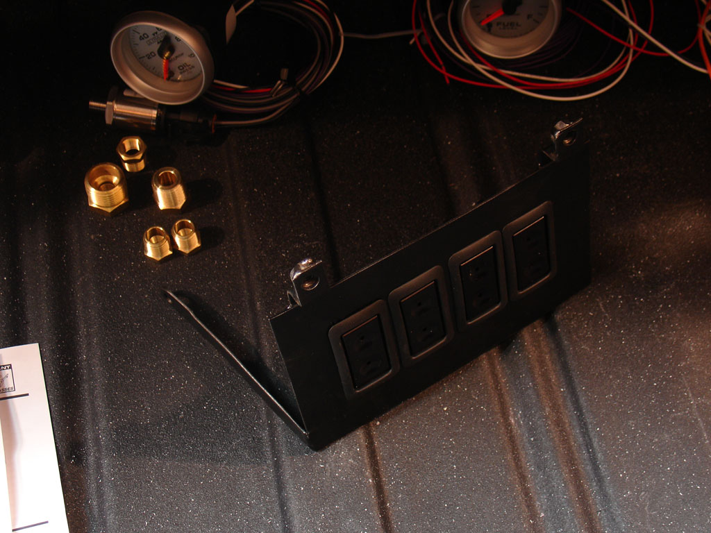

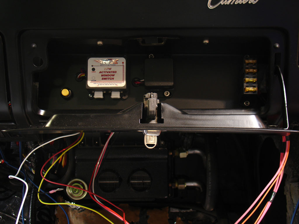

I removed the glovebox and fab'd a
sheetmetal insert to mount the electric
trunk release button, NX window switch, NX
throttle position sensor module for sensing
WOT on the throttle by wire, and a place to
mount the fuse block for the ECM, fuel pump,
etc. I'll probably mount the OBDII
connector inside as well.

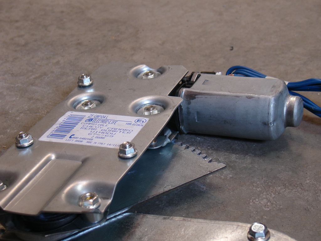

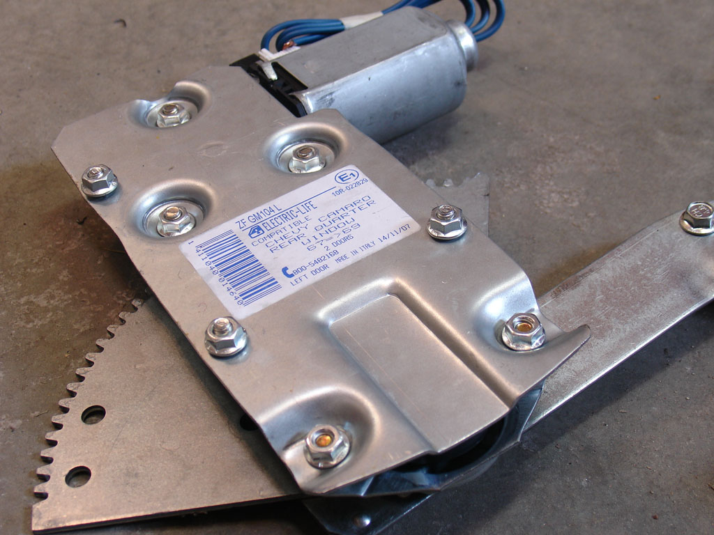

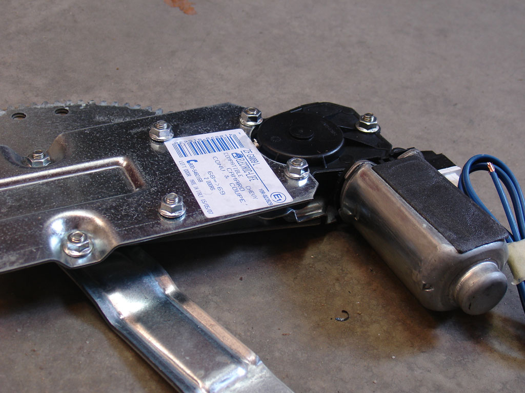

Electric Life power window operators and
switch bracket I made for mounting the
switches flush under the dash.

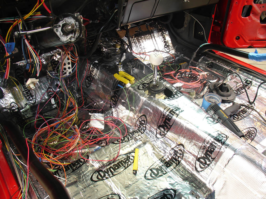

Door looms for the power window harnesses.
Harness going in.
Anything that went through the stock
bulkhead that wasn't needed was removed.
