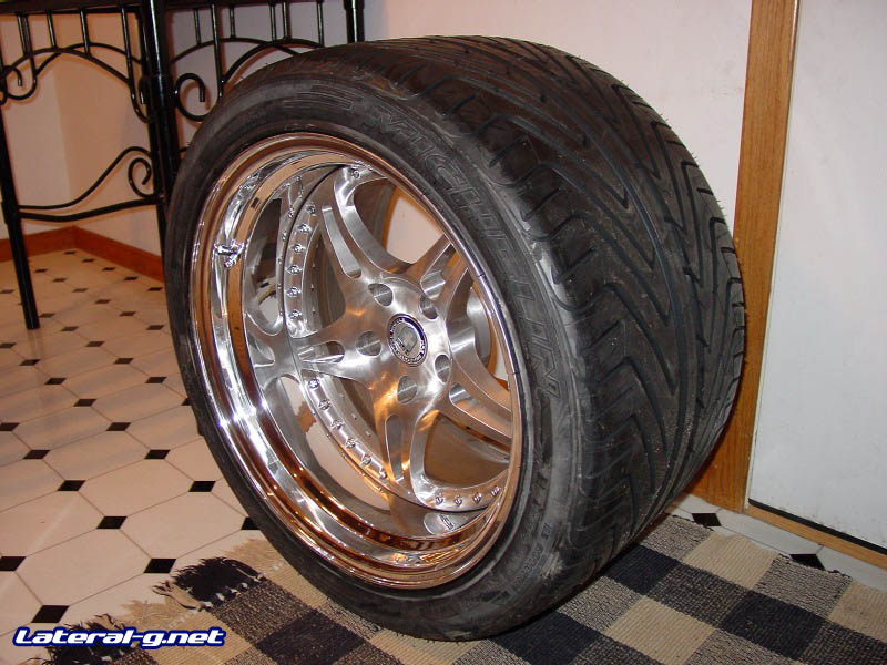

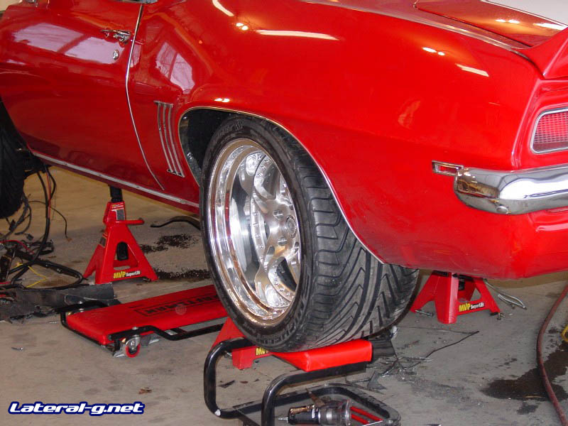

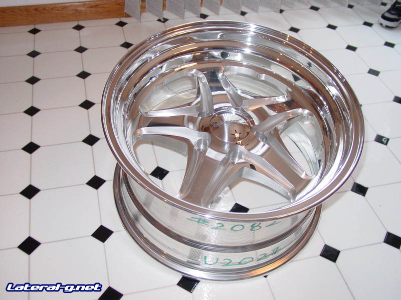

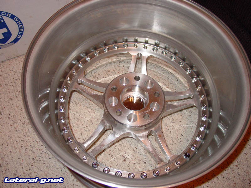

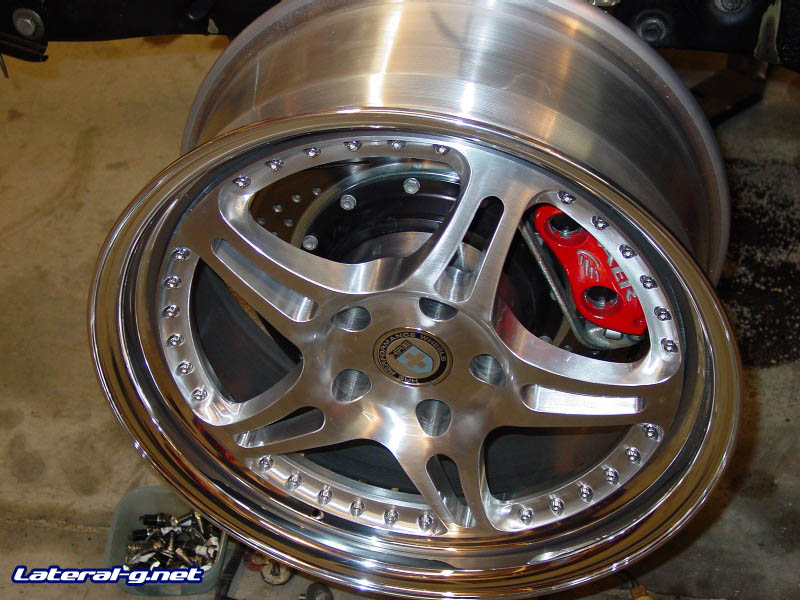

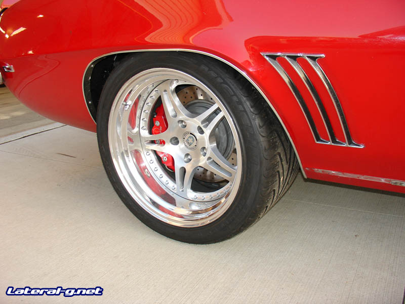

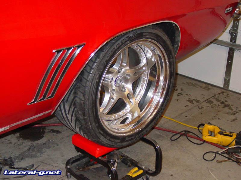

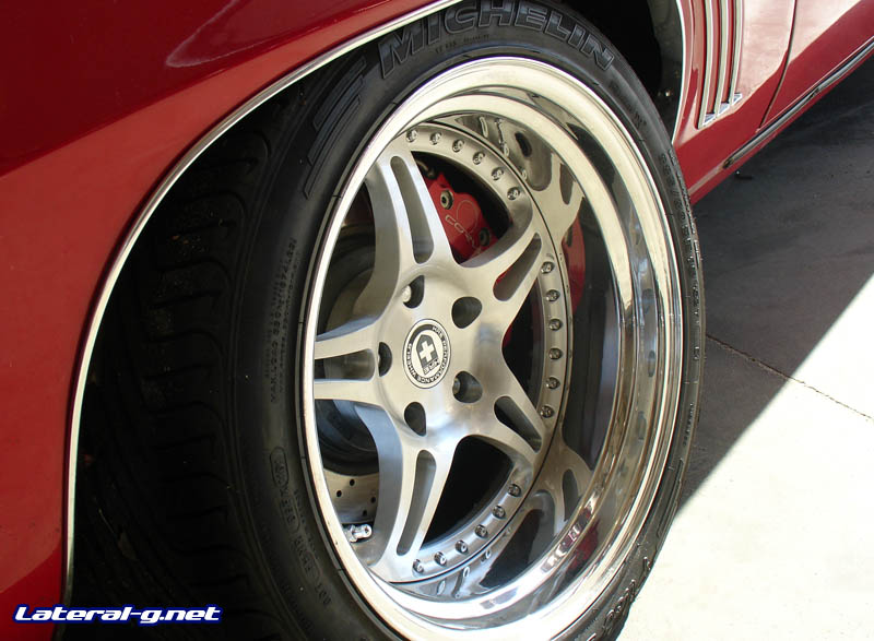

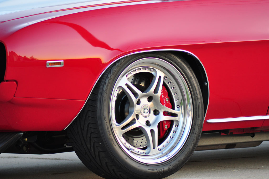

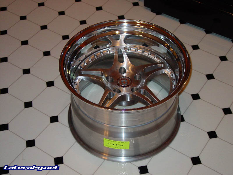

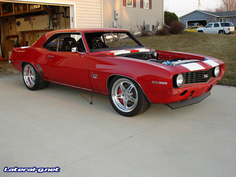

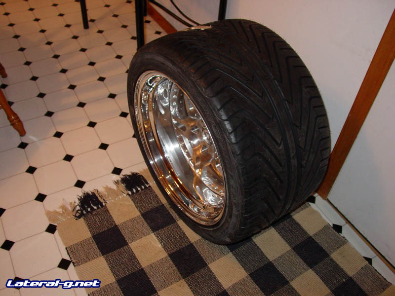

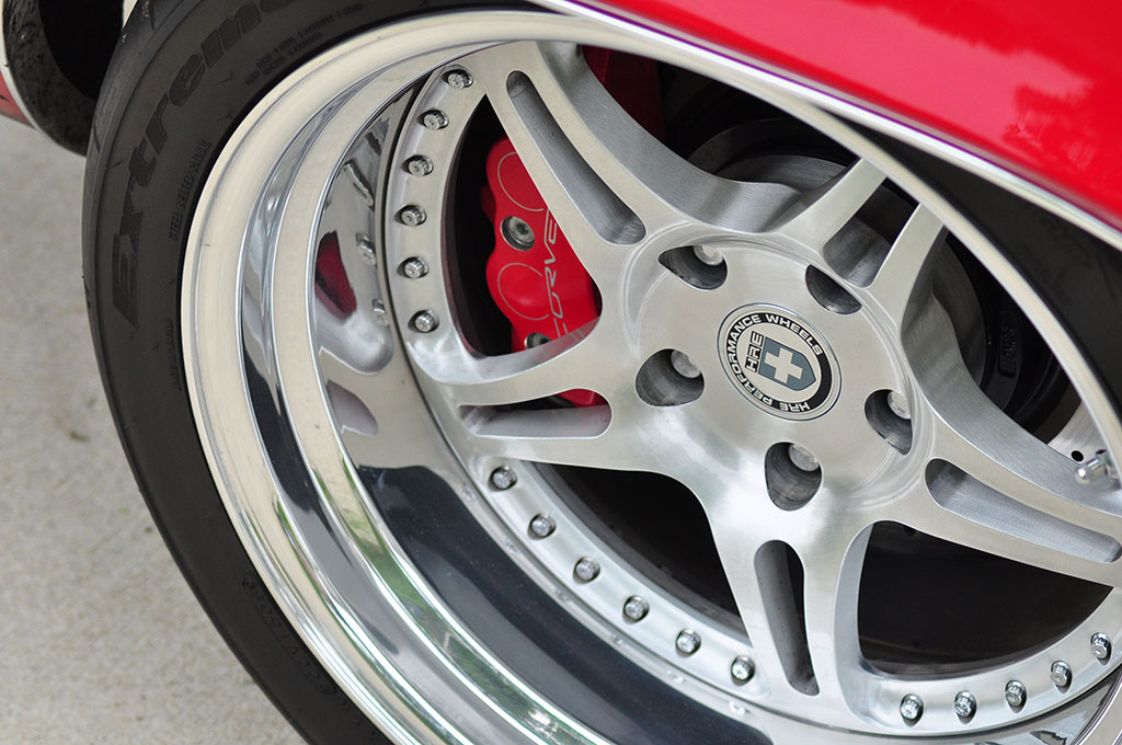

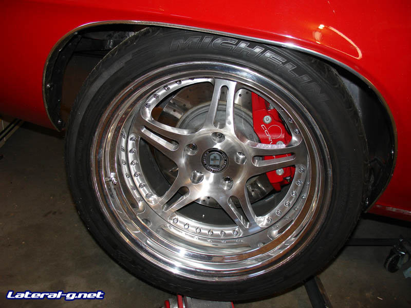

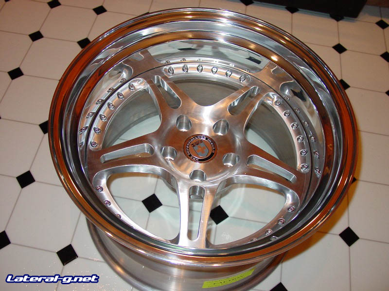

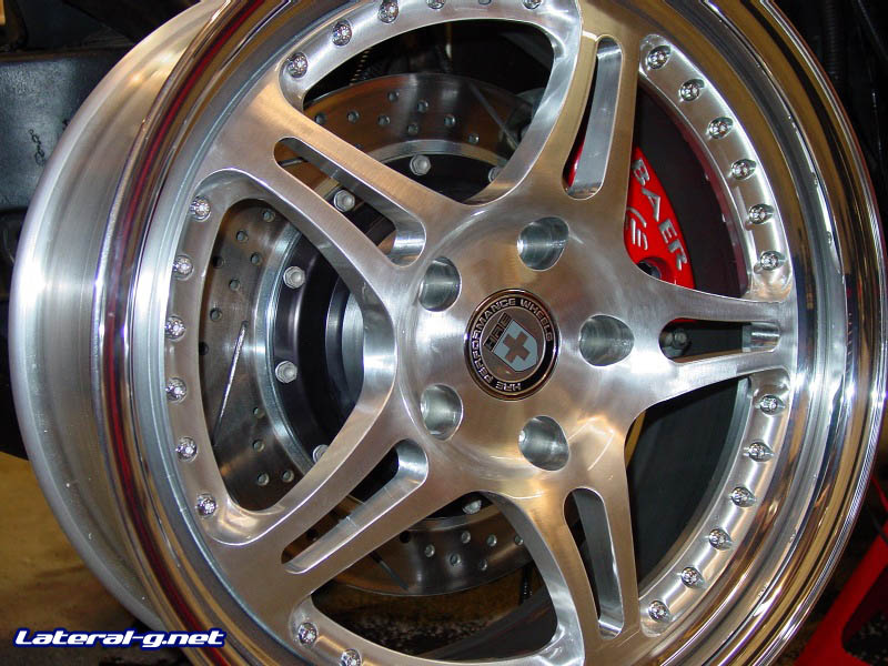

HRE 547 wheels with brushed and clear coated centers.  They are 3 piece forged with polished hoops.  The wheel sizes are 18x12 and 18x9.5.  The tires are Michelin Pilot Sports, 335/30/18 and 275/40/18.

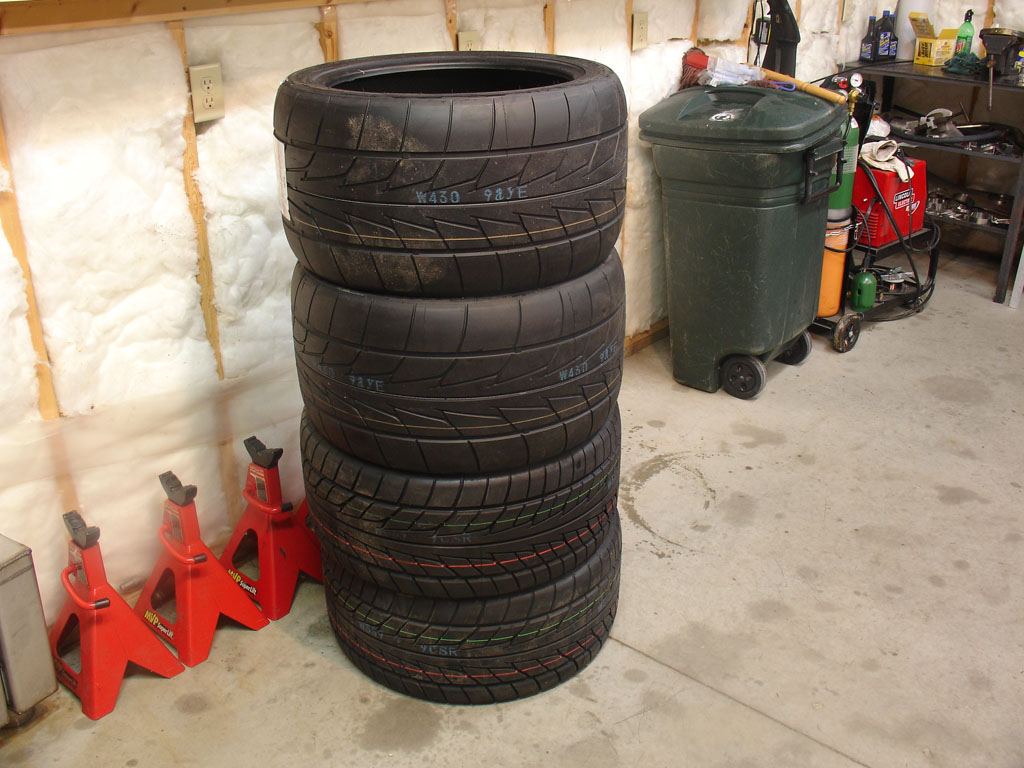

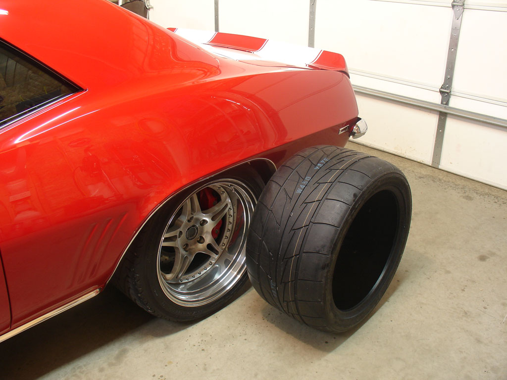

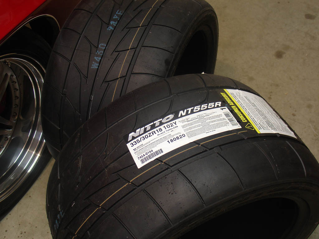

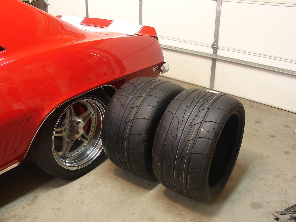

I switched to Nitto 555R's in 335/30/18 and Nitto 555's in 285's.

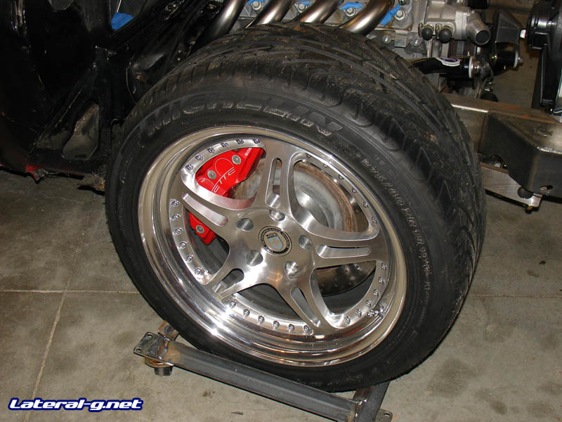

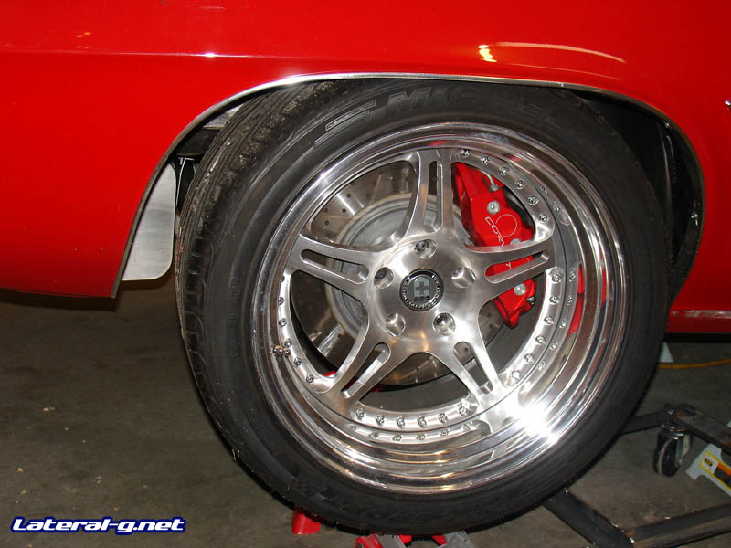

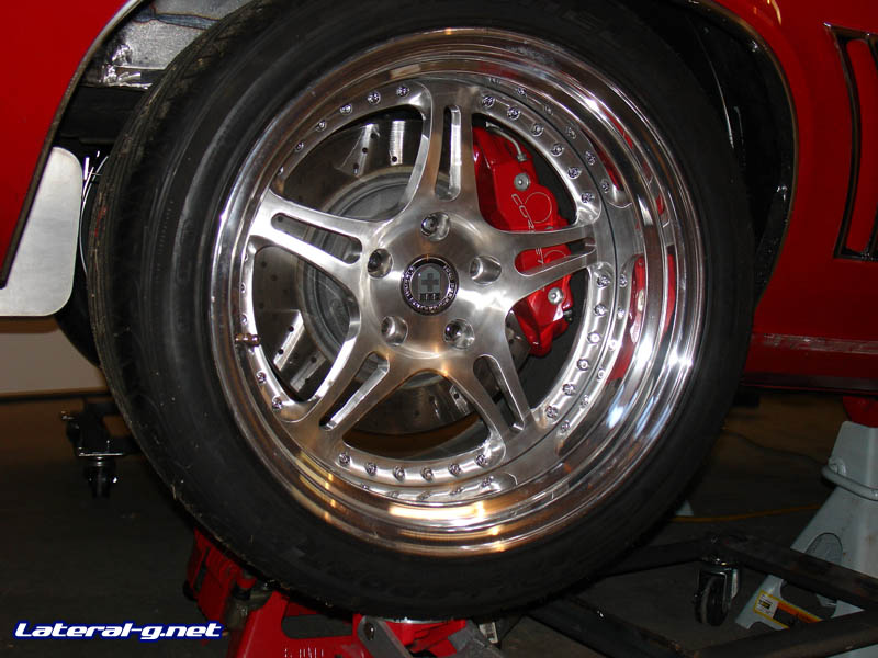

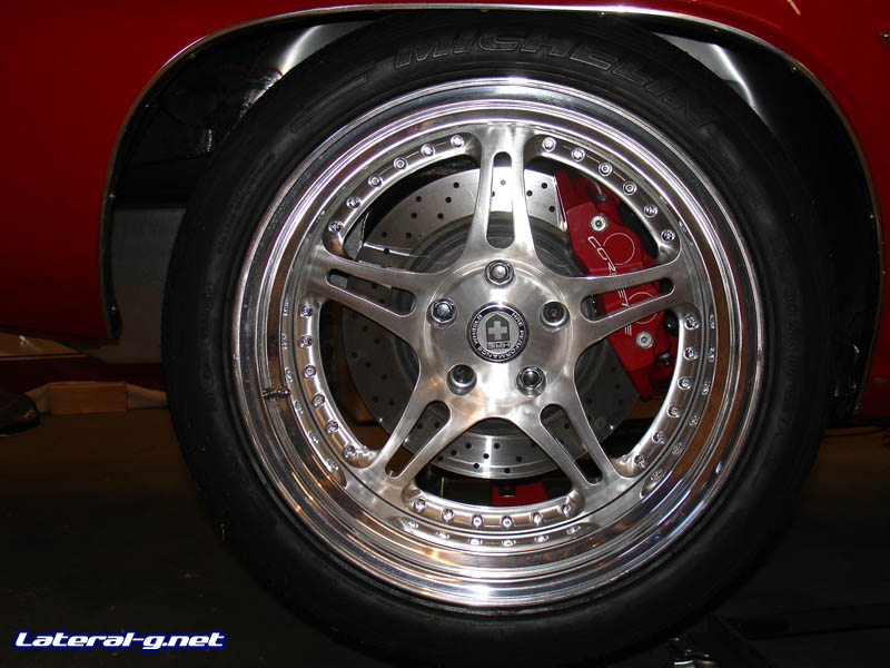

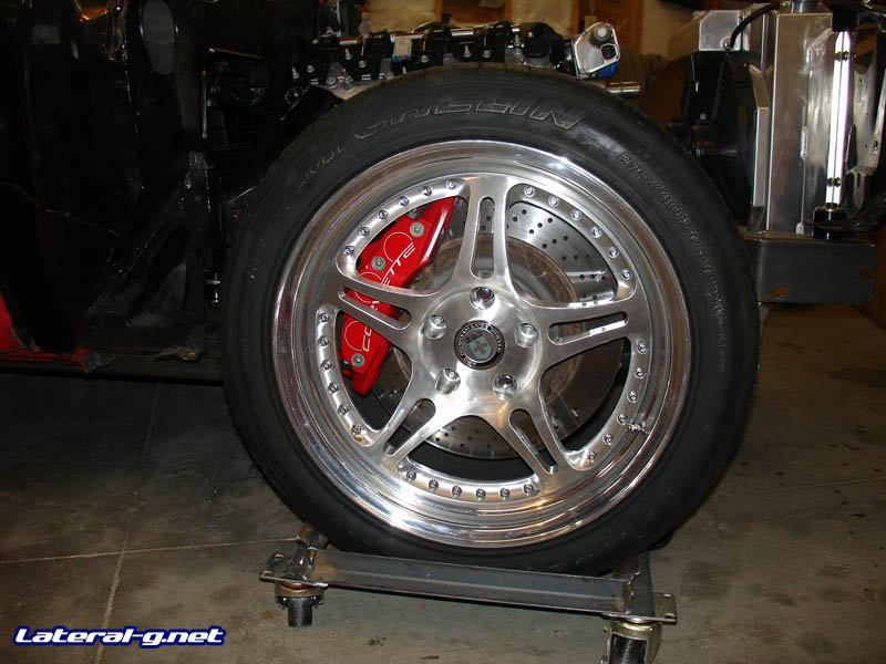

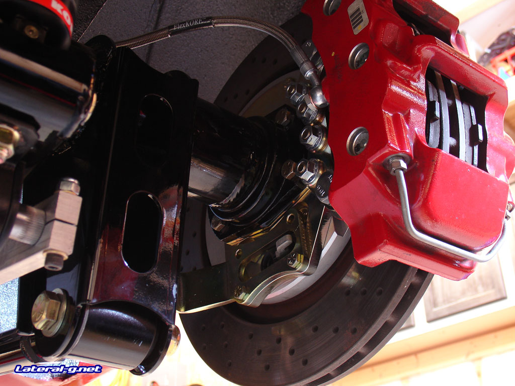

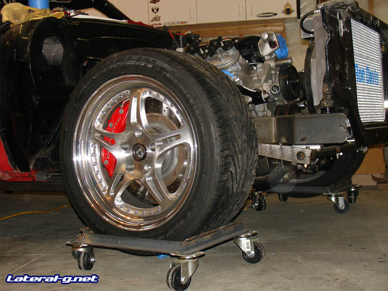

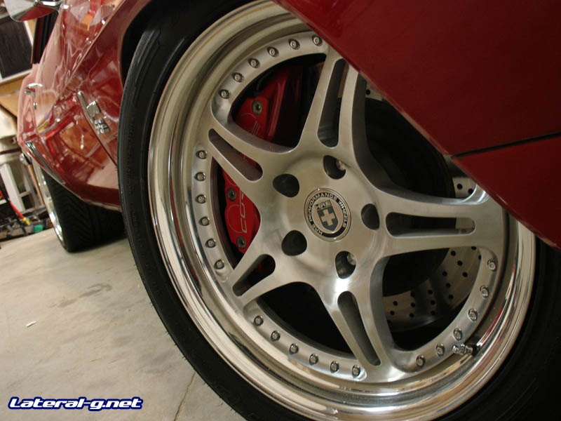

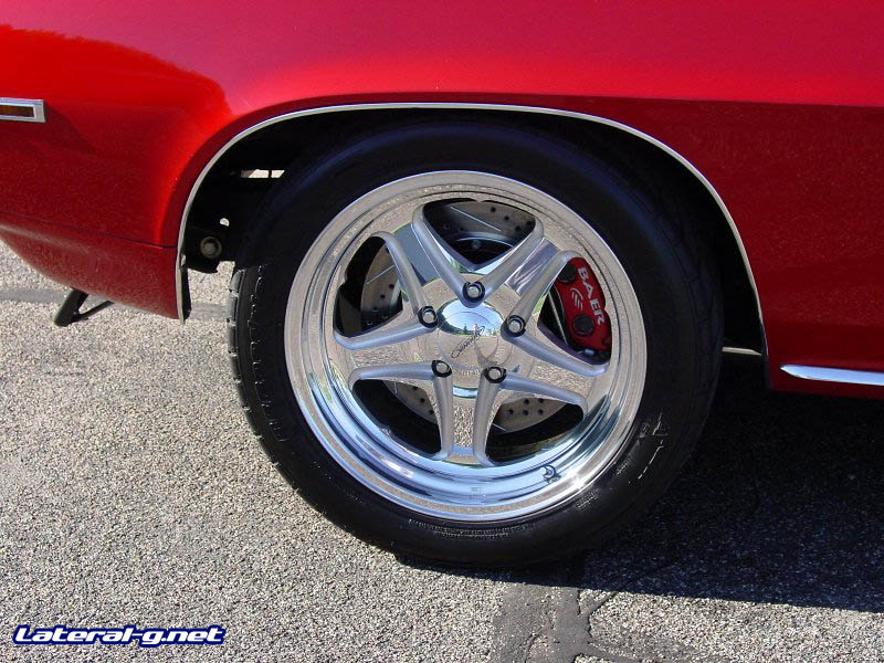

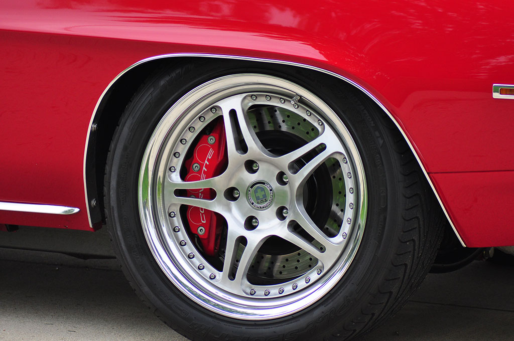

A little eye candy with the new brakes.

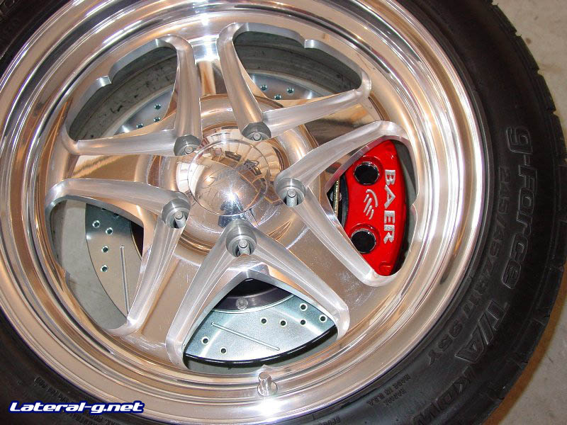

C6 ZO6 brakes.  Fronts have 14" rotors and 6 piston calipers.  The rears have 13.5" rotors and 4 piston calipers.  The Corvette script will be removed.

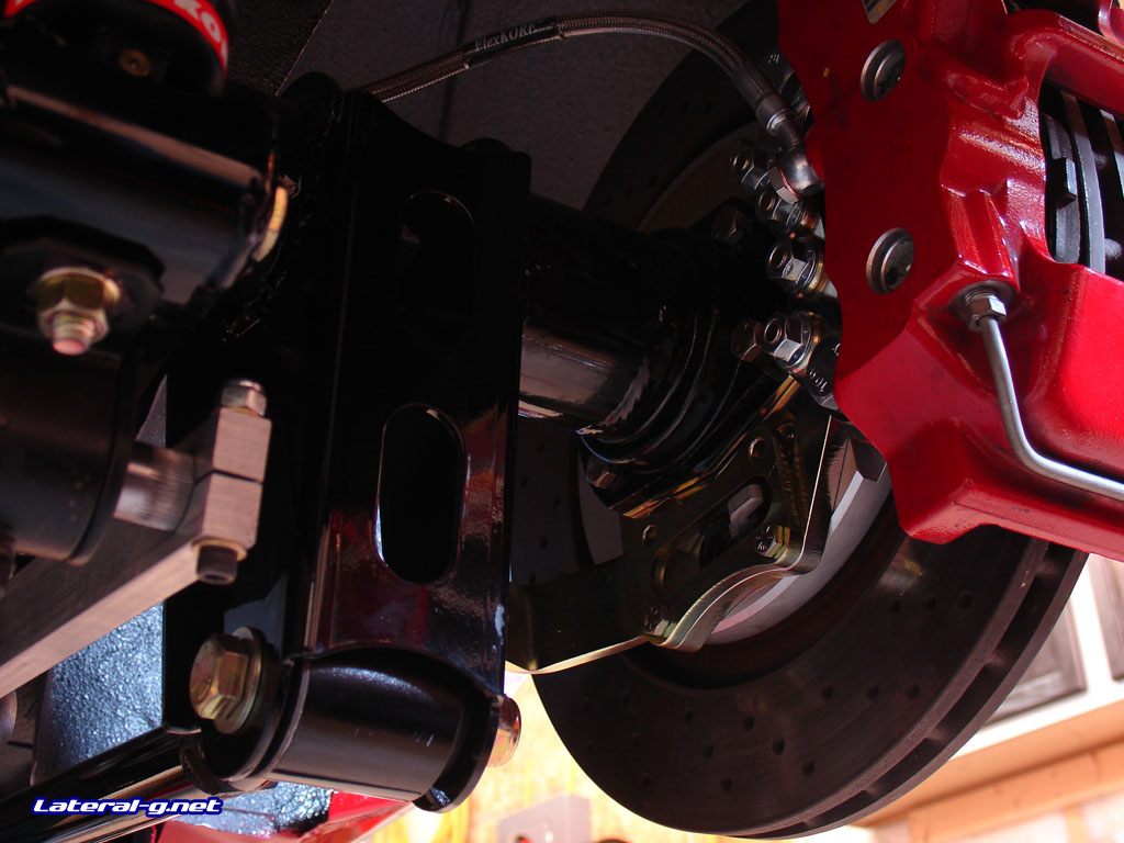

Front:

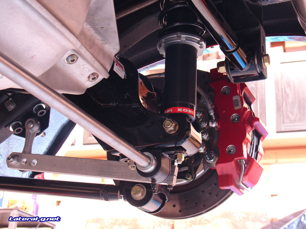

Rear:

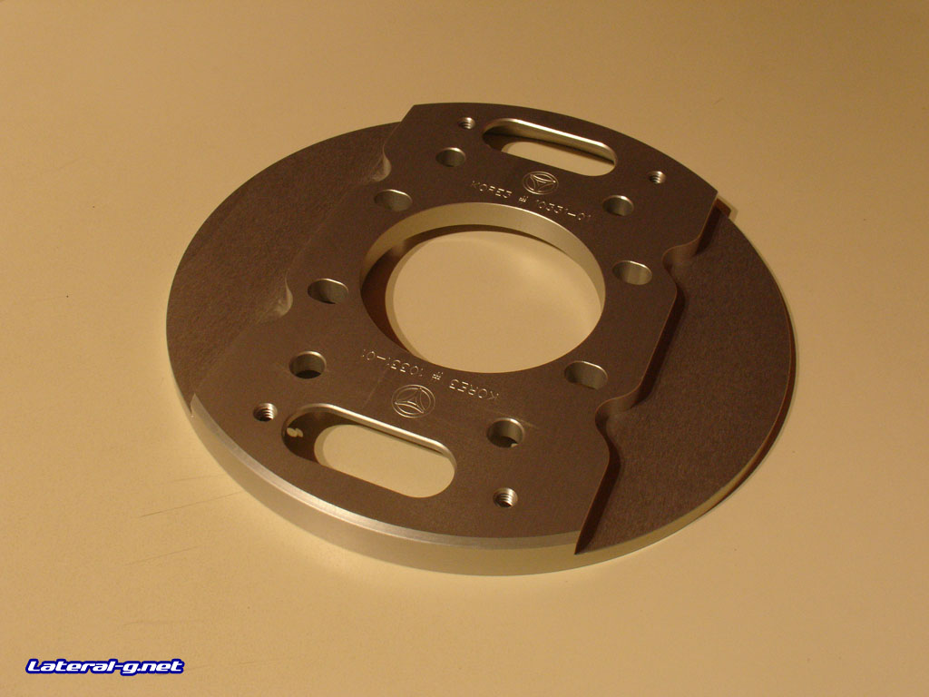

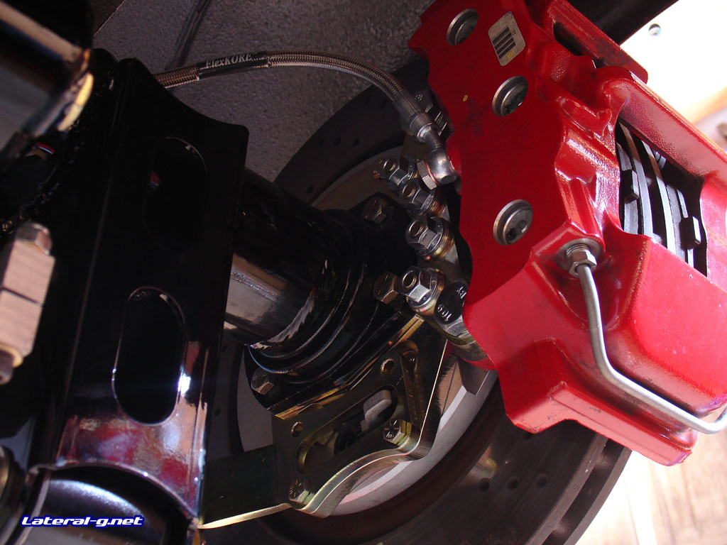

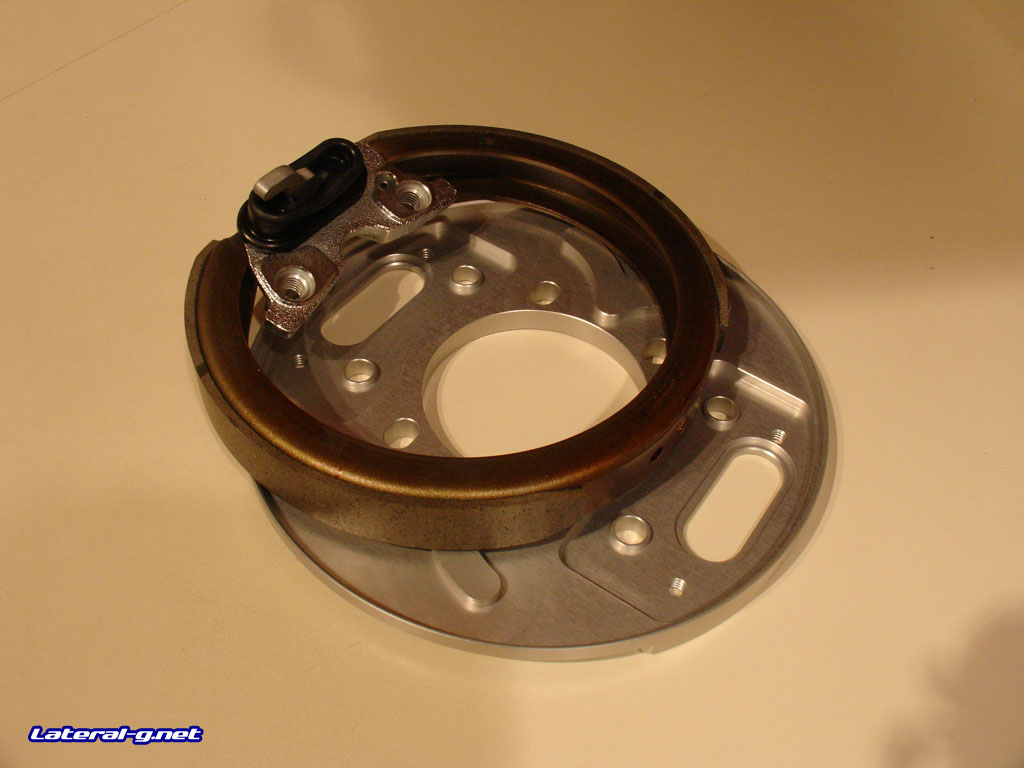

Ford 9" to C6ZO6 caliper and parking brake adapters from Kore Insustries.  These will allow the use of the stock C6ZO6 parking brakes and calipers which will bolt directly to a Ford 9" rear end.

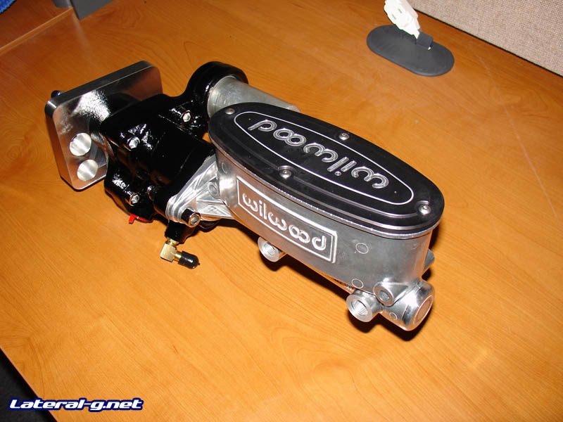

Hydratech Braking Hydroboost unit, billet mounting bracket, media blasted reservoir.

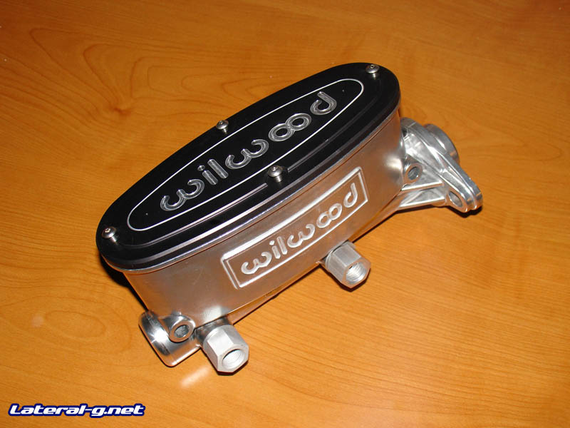

Wilwood aluminum tandem master cylinder with a 1.125" bore

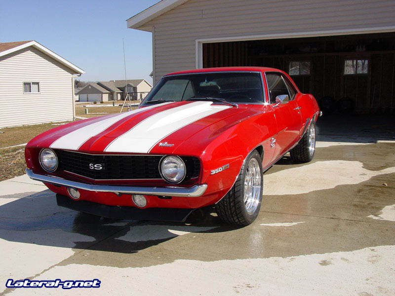

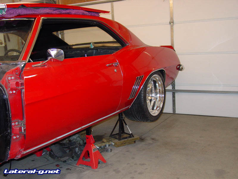

Some old pics before the mini-tubs.  I ran a set of 17" Budnik wheels.
