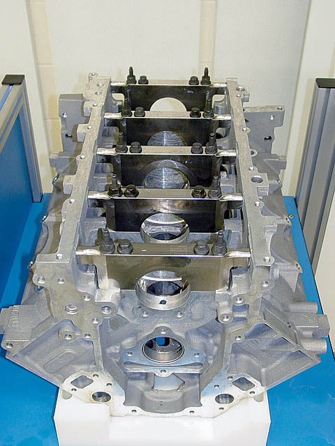

- All aluminum block, heads, pan

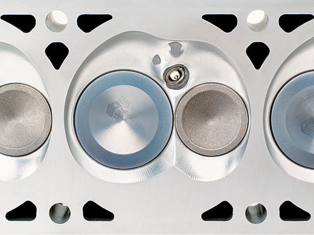

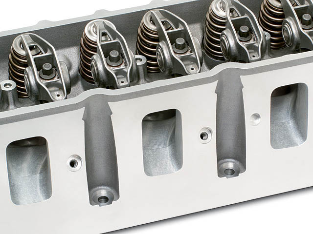

- Heads are 100% CNC'd, all runners and
chambers, on a 5 axis milling machine
- 12* valve angle

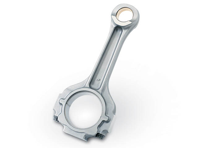

- Titanium rods (480 grams)
- Titanium 2.20" Intake valves
- Sodium filled 1.61" exhaust valves

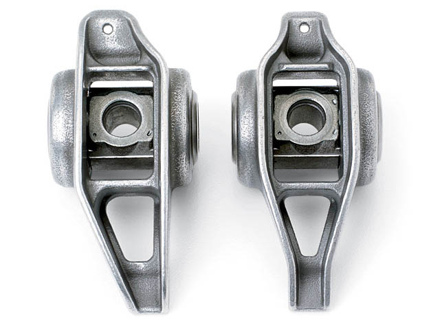

- 1.8:1 roller rockers (offset intake)

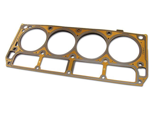

- MLS head gaskets

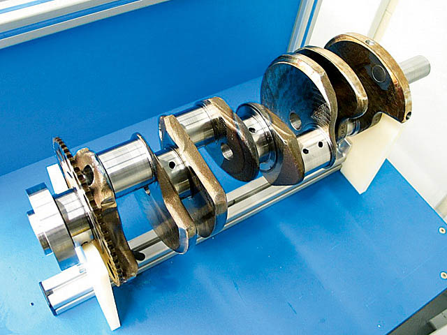

- Crank is forged 4140 chromium
molybdenum steel with rolled fillet radius
journals
- CNCd'd billet forged steel main caps

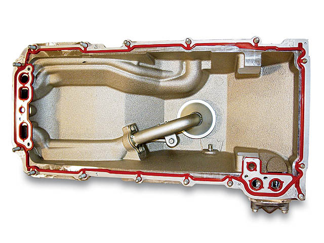

- Dry sump oil system
