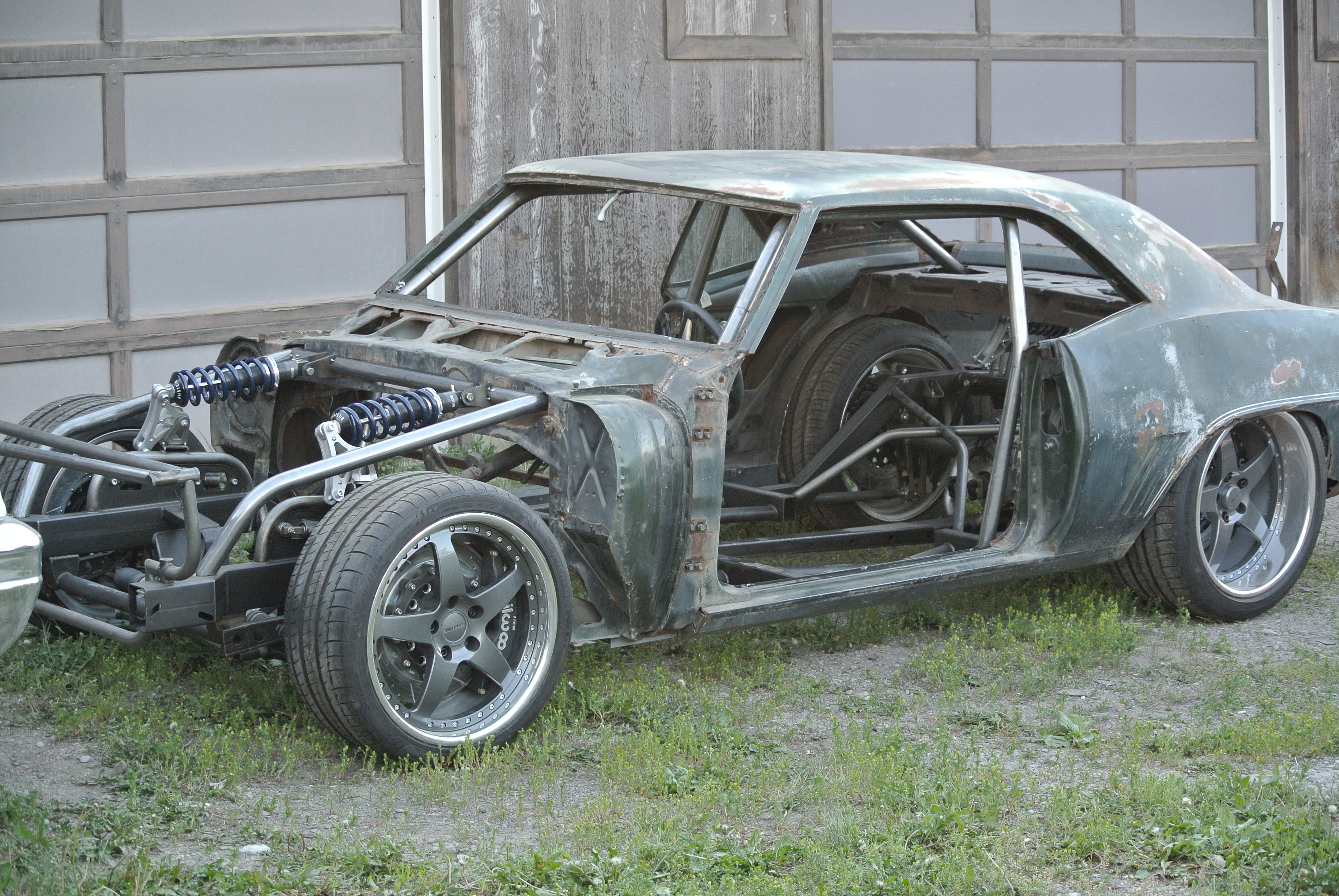

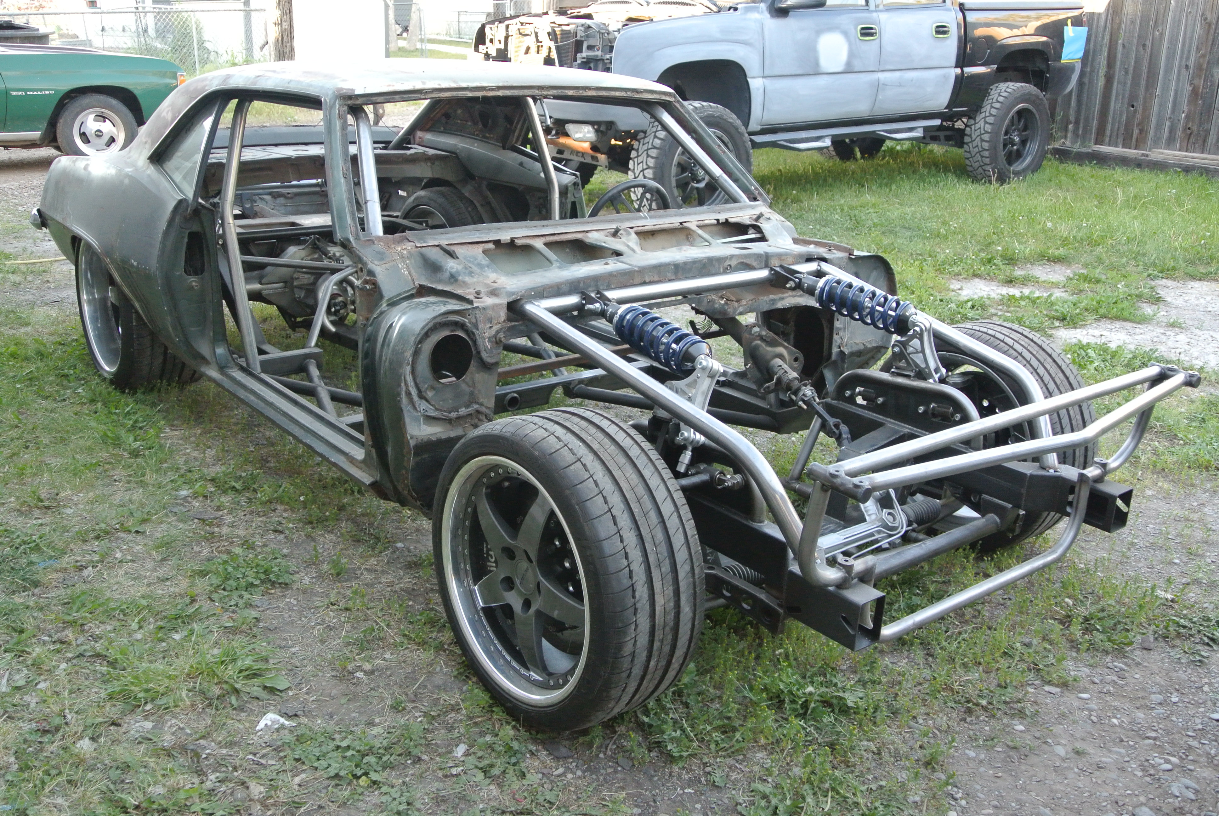

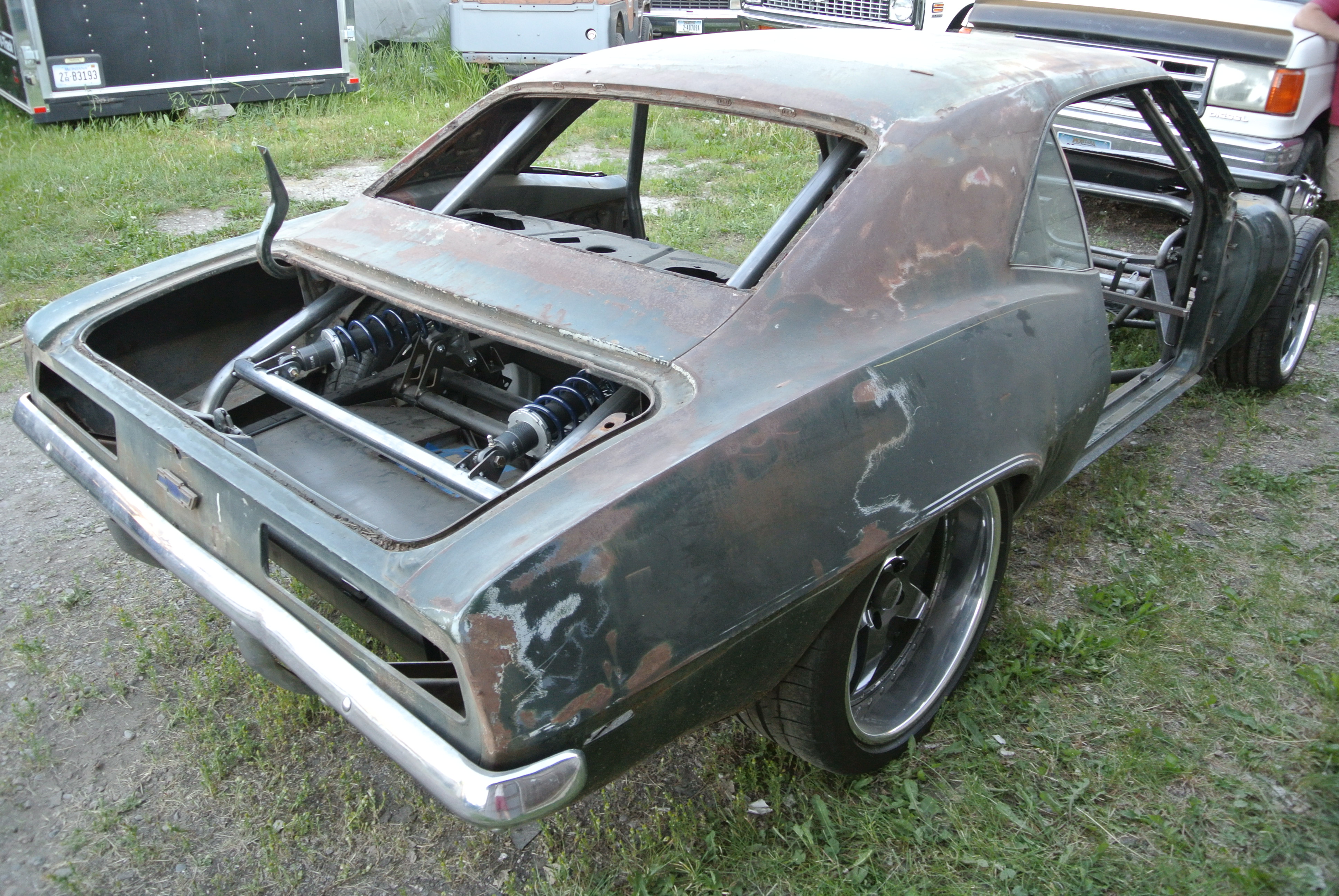

I have a build thread over on protouring.com but didn't realize I don't have one here. It is an excruciatingly slow build, due to family, house, and finishing my 1995 Pontiac Trans Am and my Silverado 1500 (daily driver).
Sorry for the giant pictures, does anyone know how to resize them easily?
https://www.youtube.com/watch?v=jA4JSOlS3b0

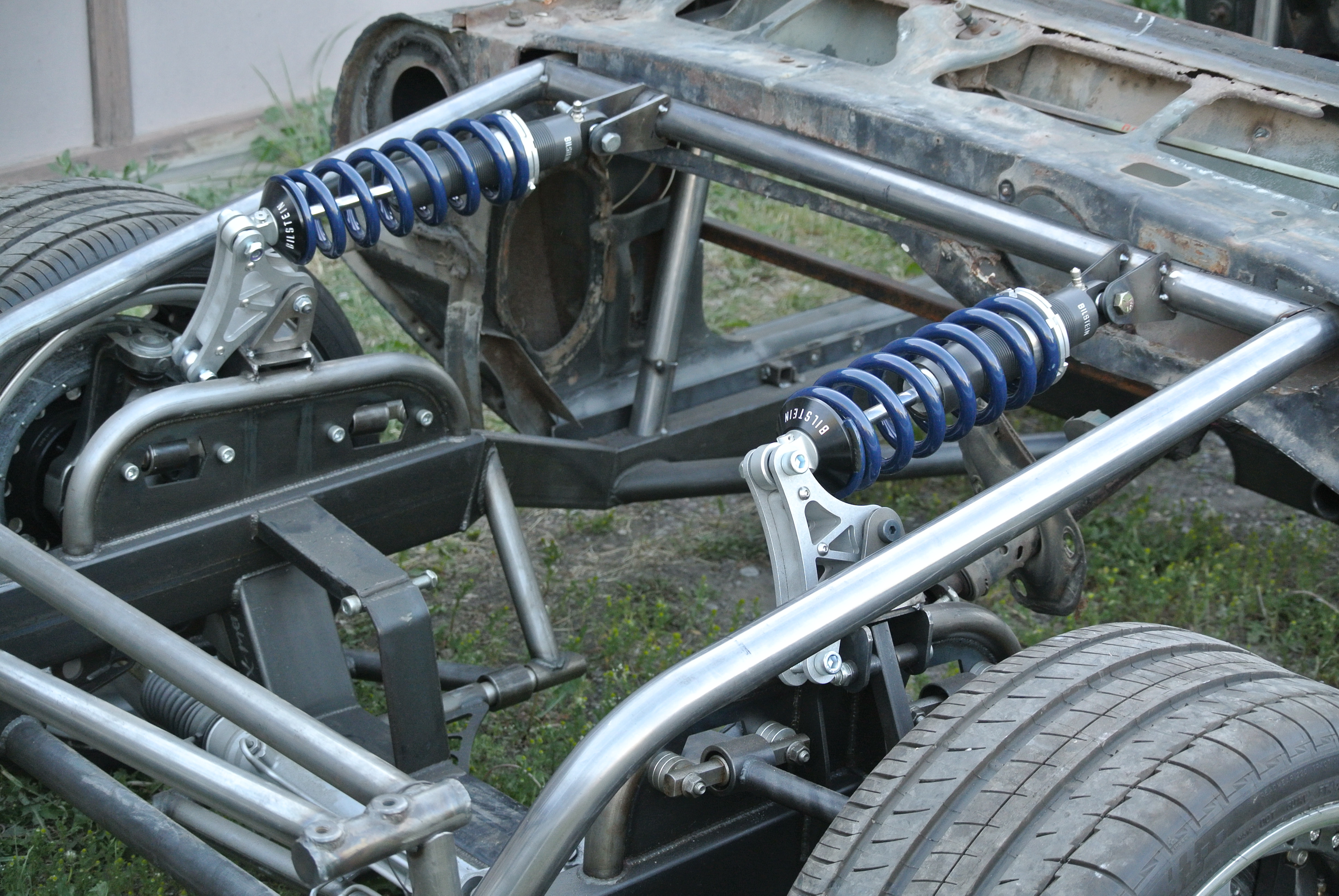

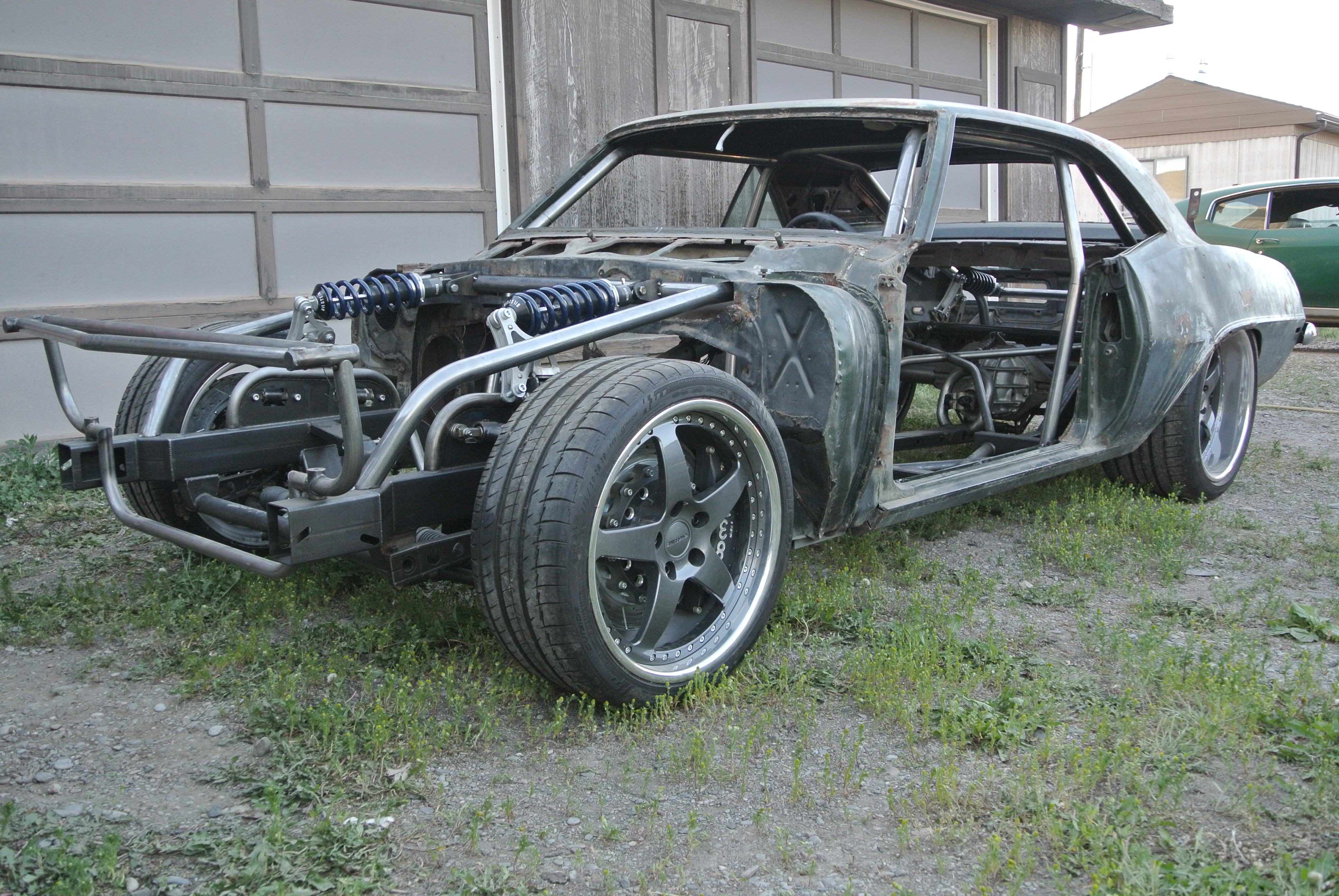

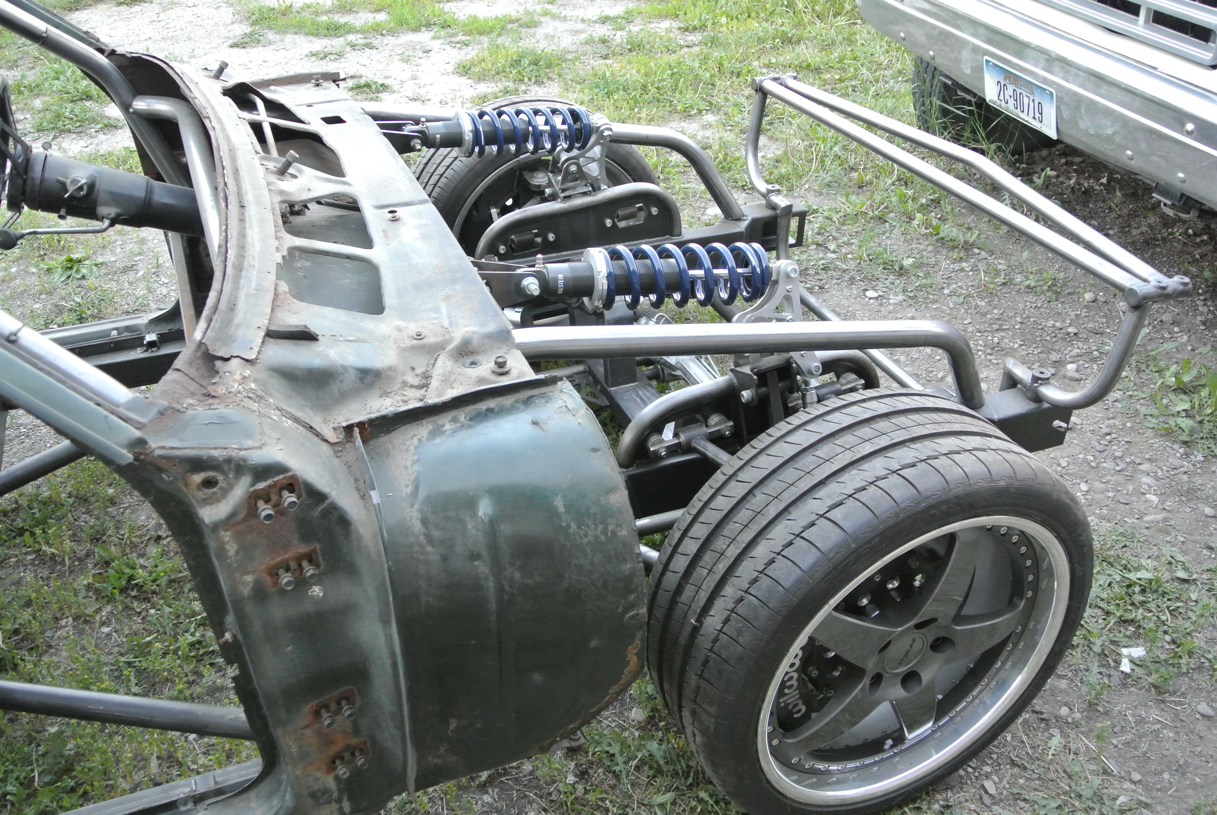

My dad and I are doing all the work ourselves. Here is a list of some of the parts I currently have on the car.
-Custom 2x3 Full Frame with full custom cage
-Full Cantilever suspension front and rear, that I designed
-Tubular Upper and Lower Control Arms (C6 Corvette Geometry)
-C6 Corvette Spindles
-Splined Swaybars front and rear
-Custom Watts Link
-Torque Arm rear end setup
-GMR Fabricated 9" Housing and full floater setup front and rear
-Bilstein Coilovers (Custom Valved)
-Hypercoil Springs
-Strange Aluminum Center Section with 3.90 gears and 35 spline Wavetrac Posi
-19x9.5 w/7.0" Back Space Forgeline So3P 3-piece forged wheels with Graphite Centers, and 275/30 R19 Michelin PS2's
-20x12.5 w/8.0" Back Space Forgeline So3P 3-piece forged wheels with Graphite Centers, and 335/30 R20 Michelin PS2's
-Custom 15" Wilwood Brake Kit
:Front Wilwood TC6 6-piston calipers
:Rear Wilwood TC6 6-piston calipers
:Rear Mr. Parker External E-Brake calipers
Future Plans...
-LT1 or LT4 (the new one!)
-TR6060 Magnum Tranny
-Lots of custom body work (look at my 95 TA build to get an idea what my father and I can do)
Nothing like working in the dirt!

Interesting project! I like the engineering in the suspension.

In for more details on the pushrod suspension...
