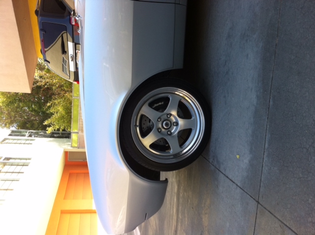

This is where my car sit up front as of now...
I want to go at least 2" lower. I want the front stance to be where the One Lap Camaro is at, so I'd say it's as low as you want to go on the street if not too low...I'm not worried about speed bumps.
I'm aware of the tire wear but the car is a weekend car so I'm no too worried about it and I'll rotate them from time to time.
Looks like the tall drops are a good idea since I'll be able to have minimal negative static camber but better geometry under hard compression.
