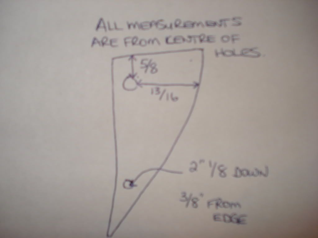

If someone has time I could use a pic for reference to where to drill holes for the bottom of the roofrail seal where it exits the channel(69 camaro). This damn repro metal has no holes in it, and I believe theres another hole just around the corner from the two I just mentioned for the end windshield trim clip. Some how I need to get a small right angle drill to do this since the door is on and finished. I did a quick draw of the spots Im looking for, you can see where I penciled in. If someone could take a similar pic of there shell it woud be very helpful- Thanks Rich

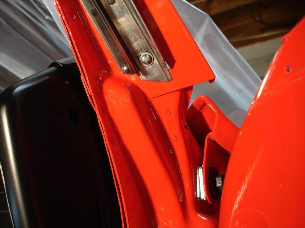

Rich Ill be working on mine tomorrow . Ill see if I can snap some pictures for you...

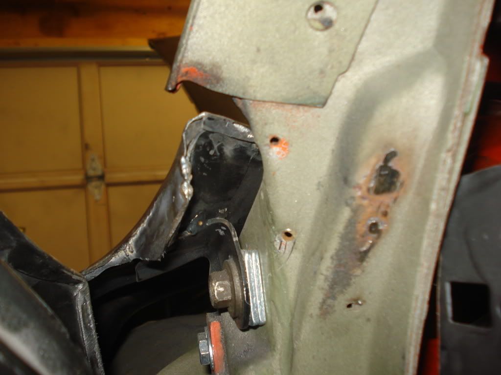

Rich I went out to mine and snapped a couple pics. Sorry I could only get to the driver side.
I hope this helps you out.

aany001, Thank you - very helpful.
Rich
