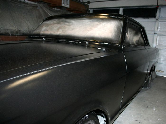

These are pretty smooth. But you dont want that. You dont want to do the work or just would still like to have handles?? I get that really.

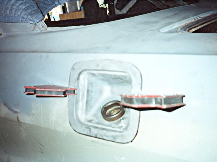

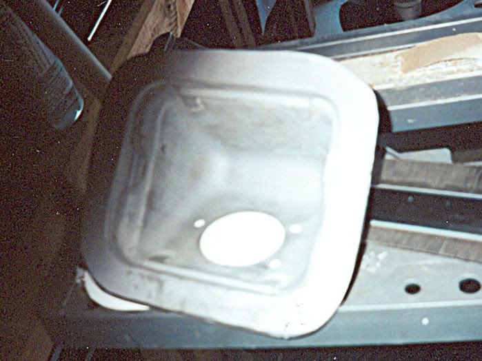

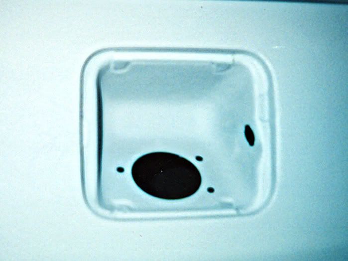

And here is what I meant about taking alot of the donors metal. A handle will have the bucket, just like a fuel filler door. Then you have lots of extra sheetmetal to play with. A door handle will be similar to this install.
You have to match the curves of your door and adjust the curves of the donor.
Then for the mechanicals of the door latch.. A easy fix is to use a bearclaw. They are really strong but smooth latches. Compared to the old stuff thats on the cars. There are prolly better solusions. But for the cost, strength and ease of installation they are pretty good. JR
