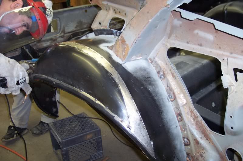

Does anyone have pics of their full quarter panel replacement for first gen Camaros? Also, I saw on the Marquez web sight that they had modified the outer wheel well to achieve a lower stance with wider wheels........has anyone else done this???? Any help would be greatly appreciated.

Redfire, he's reffering to the outer wheel tub, not the inner. Pasqual has performed that on a couple of 69's along with a c notch on the framerail with great success.

Is this what you are looking for?

That is exactly what I'm looking for!! What size wheels did you run and do you have pics? I have 18 x 12 budniks, but, I would like em' tucked under the quarter..just a touch.!! Thanks for your time guys.
I am running a 19x12.5 with a 345/30/19 on the rear and a 18x10 with 285/35/18 on the front.Here is a pic of the car on the ground.

WOW!!!! HATS OFF TO YA, THAT IS THE PERFECT STANCE!!!!!
