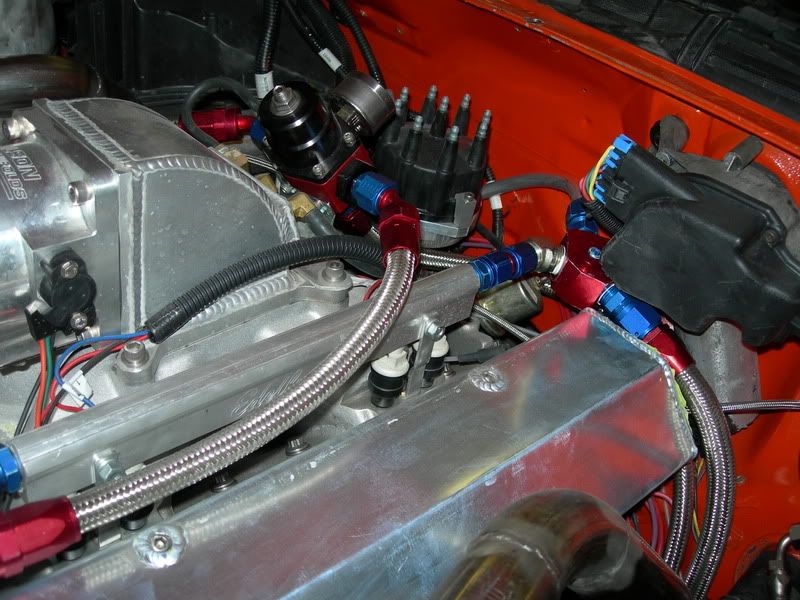

If I just run the fuel line into one of my rails and then run a crossover to the other and then a line out of it to the fuel regulator is that any different then running a Y-block then a line to each rail and then two lines to the regulator?

I'd go with the Y and feed each fuel rail separately, in parallel, the way Aeromotive recommends. Especially if you have a big fuel pump. I plumbed it that way in a twin turbo engined car I had using the same pump as you and never had a problem.

actually made more than that, but that idiot has no idea what he's doing! I've always preferred to Y the lines going into the two rails equally, versus running one side in , crossing over, and feeding the second rail.

run a Y .
helps keep fresh fuel and even line pressure on both sides.

I would recomend using a Y to feed the back of the rails coming out of the front into a T style EFI style regulator, returning to the tank. the large injectors and pump will contribute to hydraulic issues that you wouldn't see with a smaller system. IMHO.
