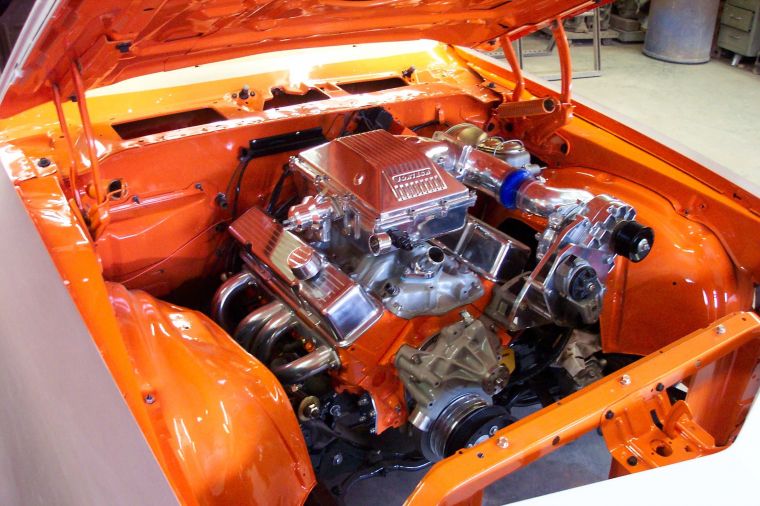

Heres the 500" motor with the F-2 and the EFI manifold set up that will some day make it in the engine compartment. The only diffrence is the bracket is now polished and it has the lowering bracket.

What a beast. Wow.
