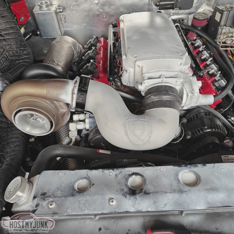

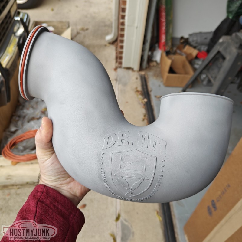

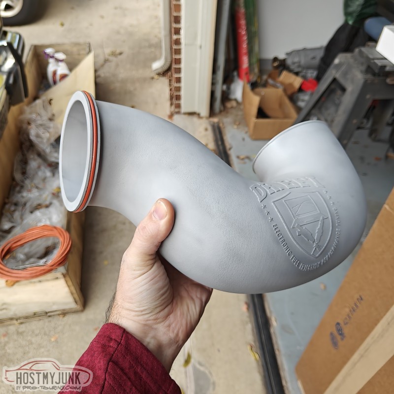

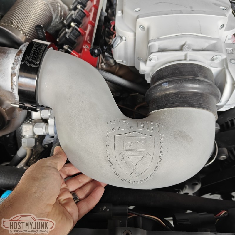

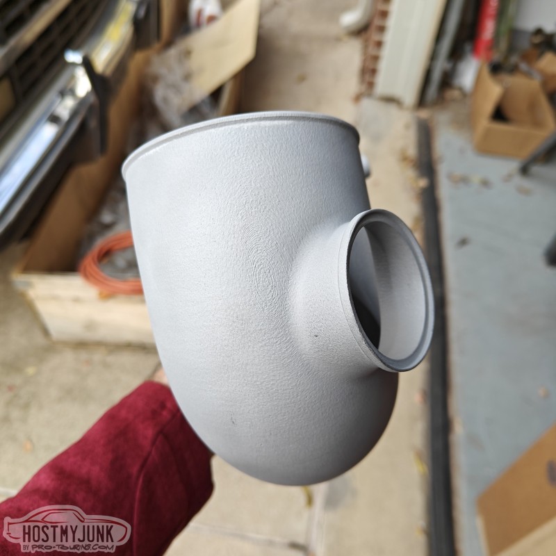

Here is the final raw, 3D printed aluminum charge pipe:

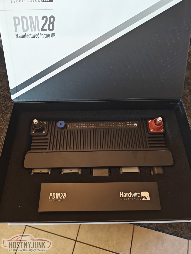

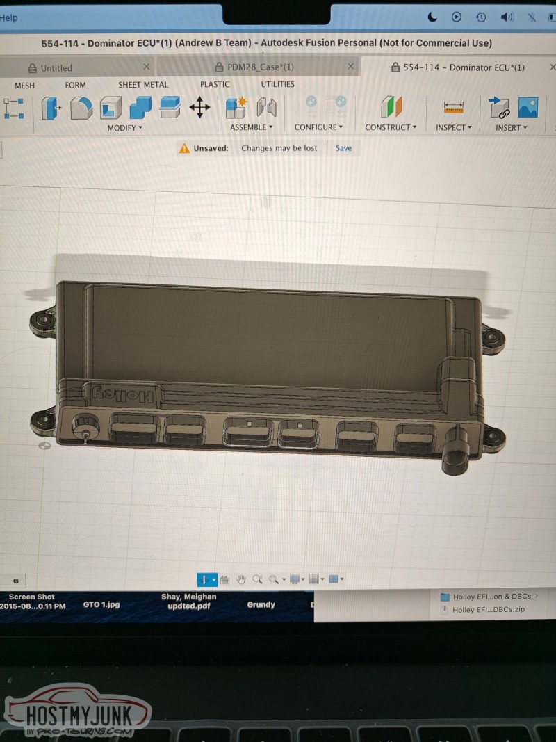

I ran across some videos by Devin Vanderhoof. It seems that he too has discovered the Hardwire Electronics PDM products. In fact, he has become the biggest distributor in the US for Hardwire. As you may recall, I already have a PDM 25 under the dash, but after seeing the videos for the new PDM 28, I knew that's what I needed in the GTO. I will use the PDM 25 in the Cougar or the Suburban.
Here is the PDM 28 as it arrived.

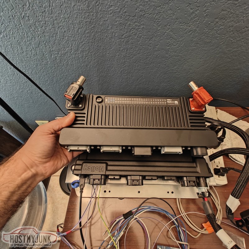

The size of the PDM 28 is substantial. Here you can see it compared to the Holley Dominator ECU. They are roughly the same size.
The reason for choosing the new PDM 28 is that it has two CAN busses. With the release of the Holly CAN documentation, the PDM 28 is fully compatible with Holley EFI.

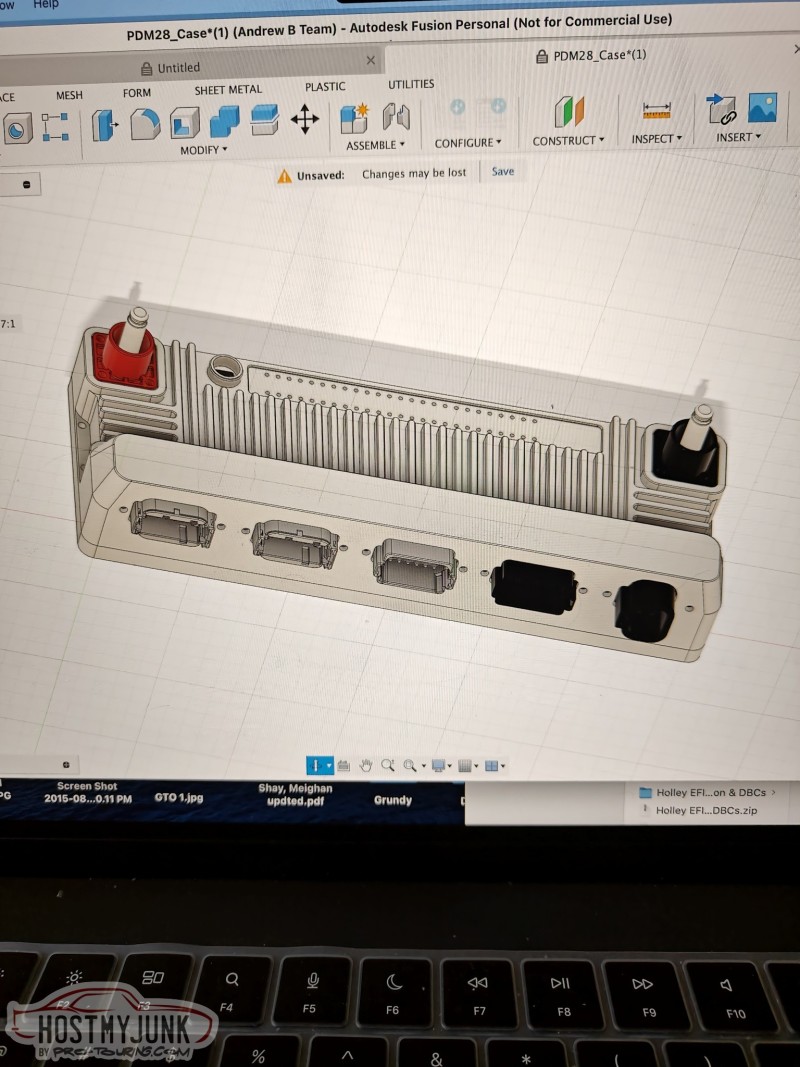

Holley had a 3D model of the Dominator available for download.
An email to Hardwire provided the 3D model of the PDM 28.
I once again used my Shining 3D Einstar 3D scanner and generated a scan of the GTO dash and glove box area.
https://youtube.com/shorts/mhHSHdmFs..._UB9Yk2dgtfszA
The plan is to design a mounting system for the Dominator and the PDM in the area that used to be occupied by the glove box.
