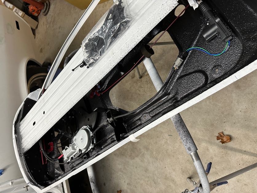

Retrofit power mirrors and doors back on the car The mirrors were a little custom side project. I think they fit the body quite well. I'm happy with the result... at least until I start body working them. Can't seem to post any pictures, sorry. I'll try again later.
Pictures.
