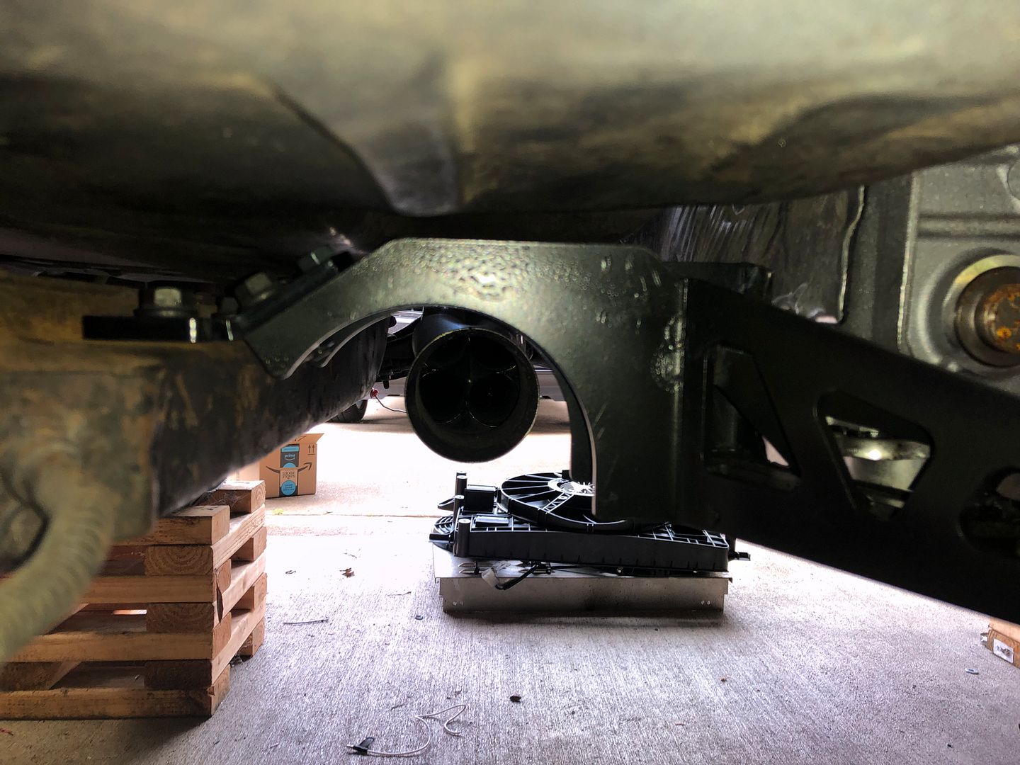

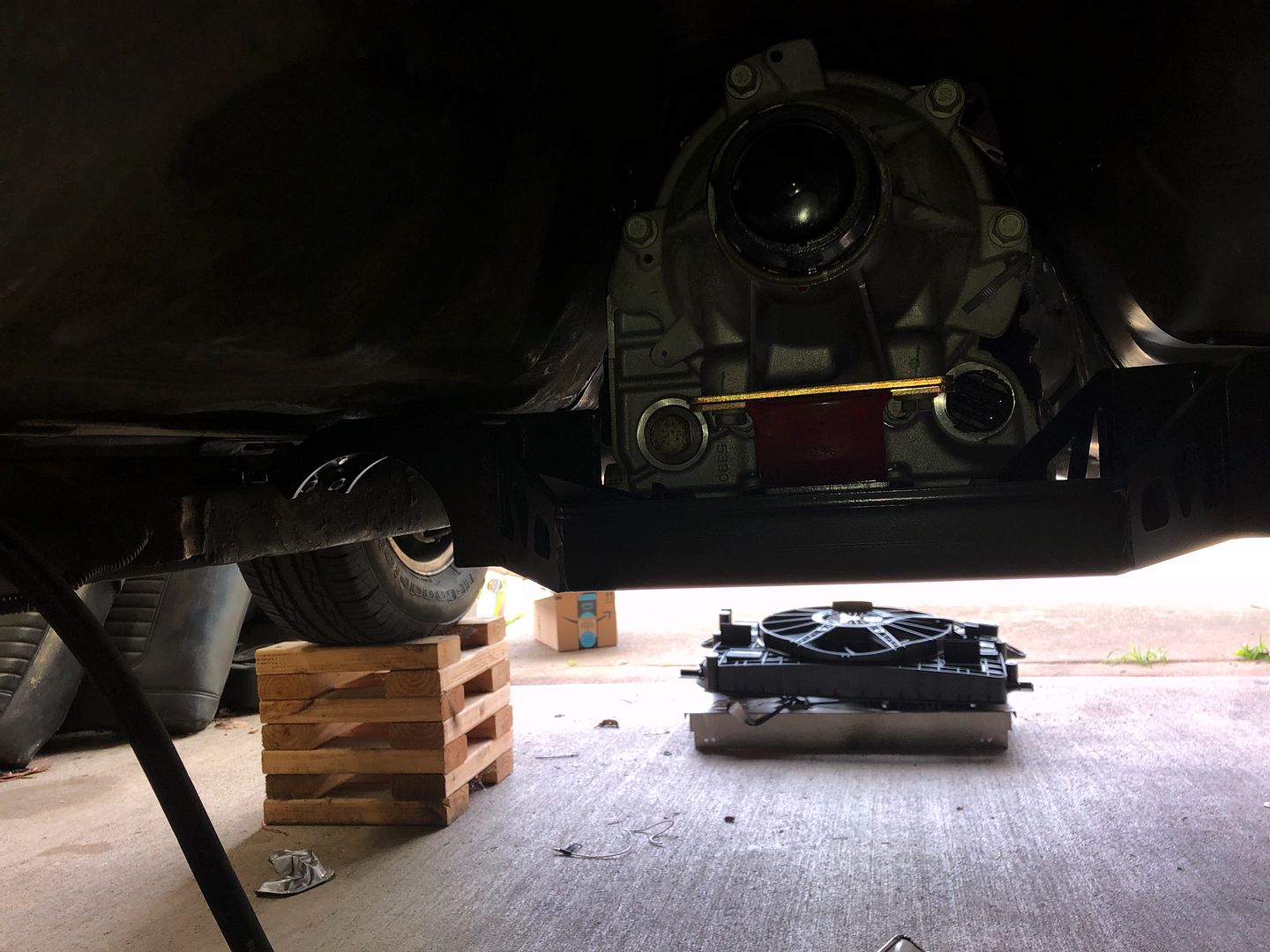

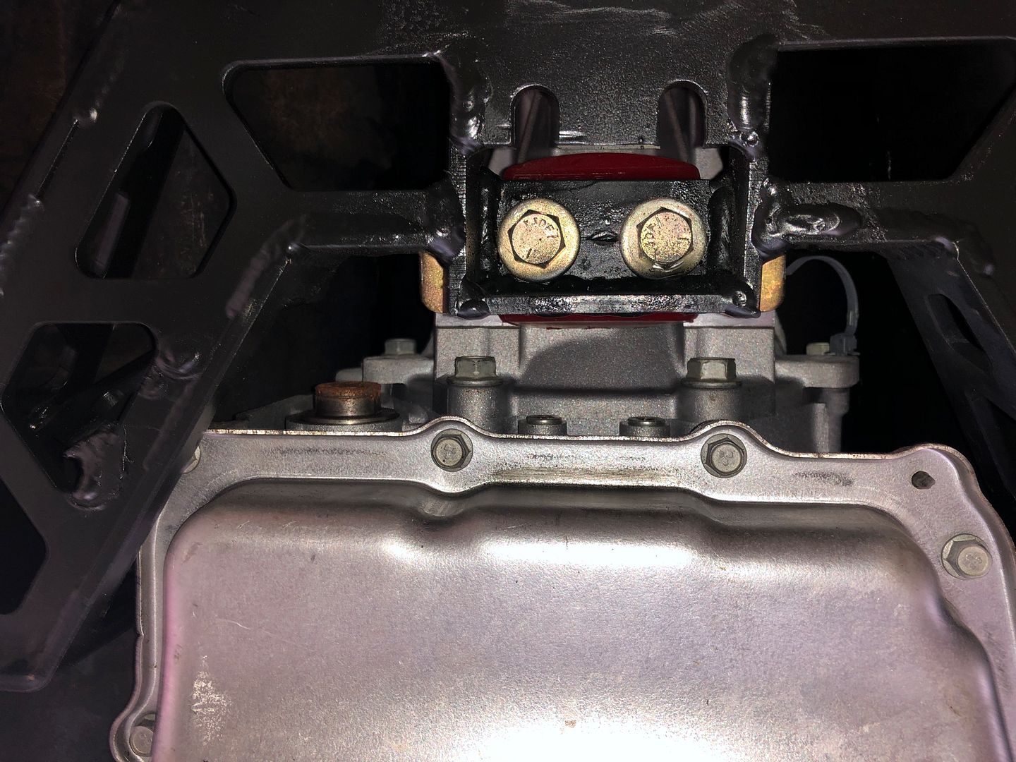

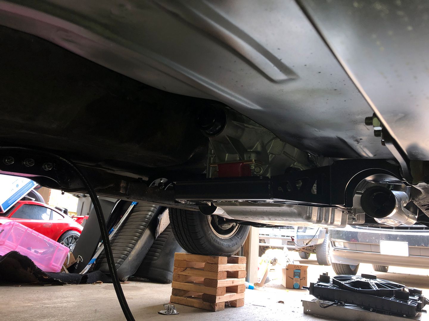

Here are the photos of the trans crossmember installed. As you can see the PS header is tucked in real close and does not line up with the crossmember exhaust relief.
