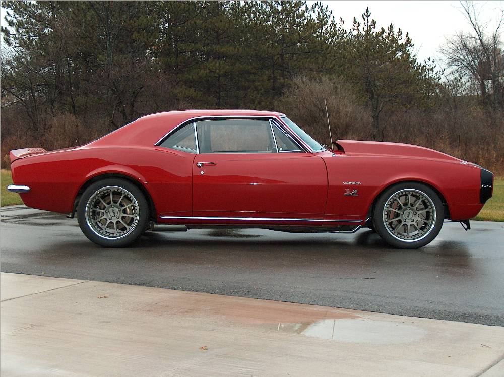

I really like the look of that!
I'd try a 1" lowering block, if the springs do settle, just remove.

Originally Posted by XcYZ
No, they're definitely 3" drop. Did you happen to tighten everything up while on jackstands? (I know, I know, but I had to ask, lol)
It's not my first day on the job No, I left the spring eye bolts and the upper shackle bolts loose and set it down, bounced it a little and even drove down the street and back before final tightening.
Jeff
99 Miata LS6
67 Camaro Street Fighter 599 HP L92-SOLD

Originally Posted by clill
As soon as you fill your trunk on Power tour you will be fine....
I thought of that last night too. In 2003 with my 69, I had the ride height looking great, but when I loaded everything up to go to Nashville for PT, I had problems with tire clearance.
Jeff
99 Miata LS6

Here is what I ended up doing. I raised the front 1/2 inch and took the lowering blocks out of the back. I need to keep it driveable.
Jeff
looks pretty darn good to me
