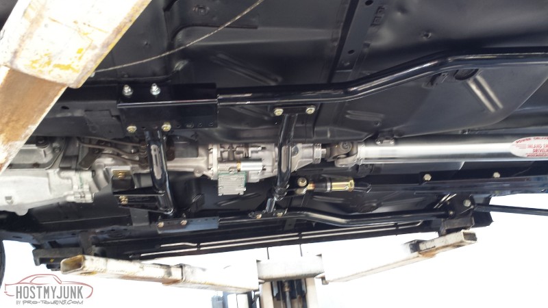

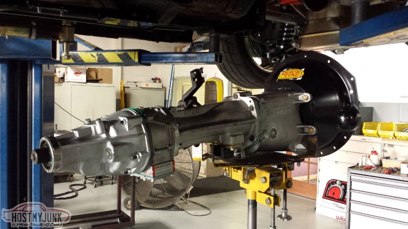

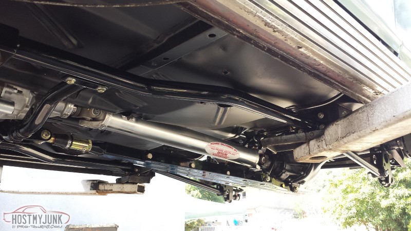

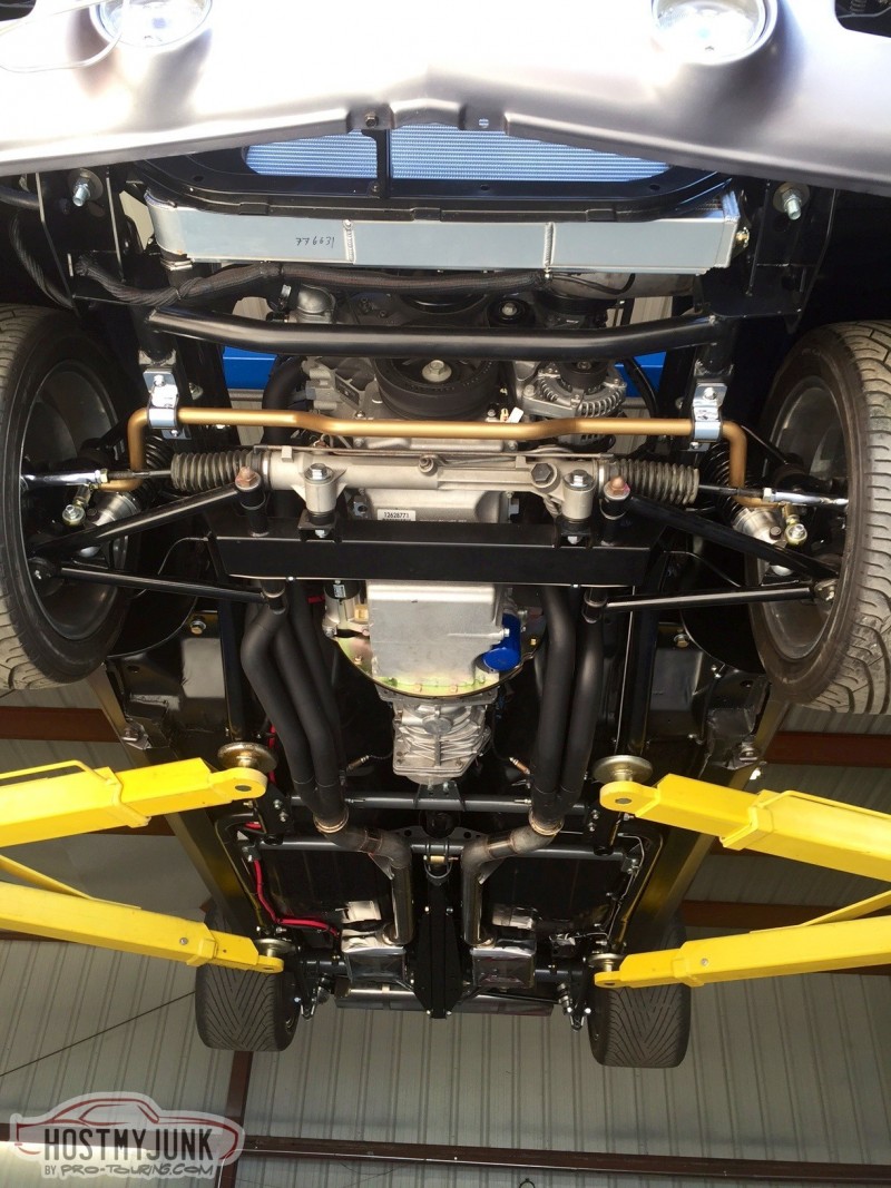

This is our Sales Manager's '63 Nova. He was in our booth in Columbus. Before swapping to the T56 that is currently in the car he had a M21 with gear vendors in it. The only modification he made to the Torque Arm kit was removing the driveshaft loop.

That stuff all looks right in the place where you would run the exhaust on a Camaro.
The Camaro crossmembers tuck up closer to the floorboards at the bends. Evan's car has a full 3" exhaust and his car sits very low.
Can you post pics of the Camaro set-up with exhaust in place for reference?
that would be very helpful!

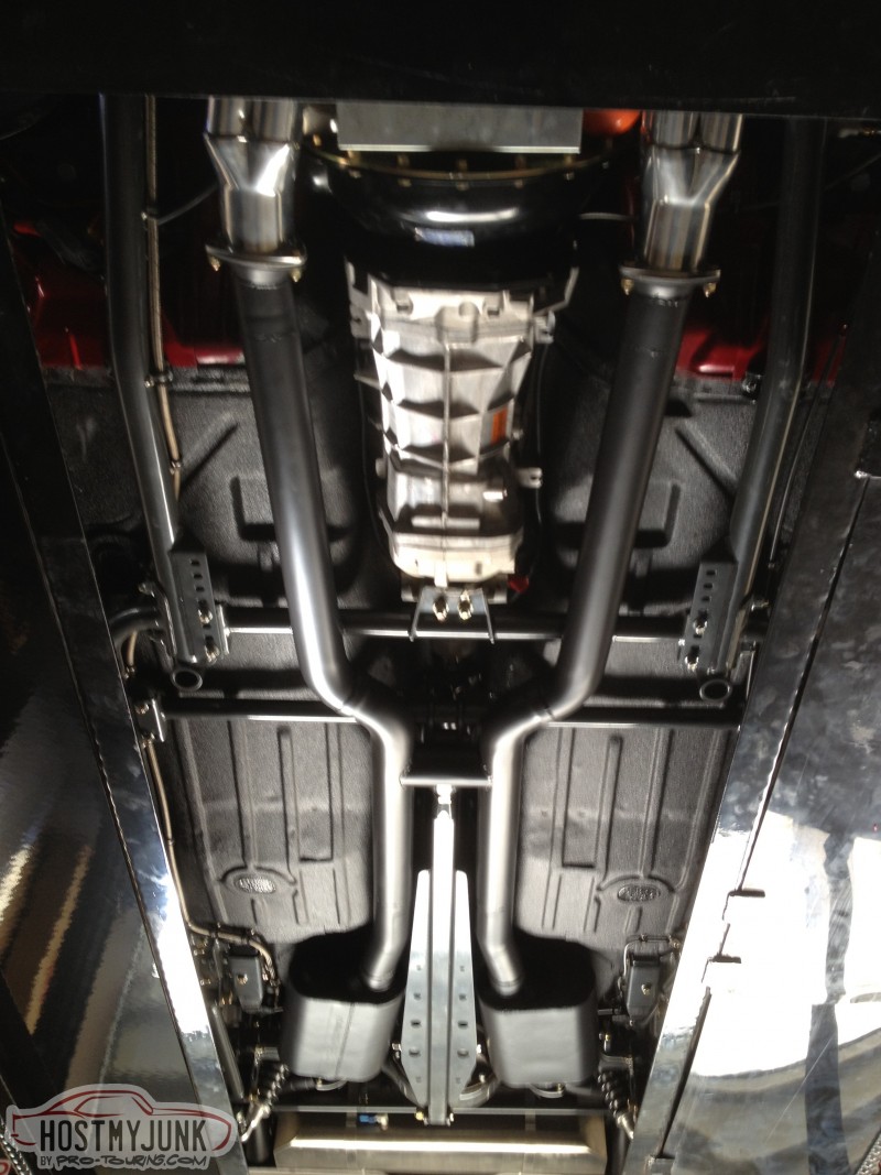

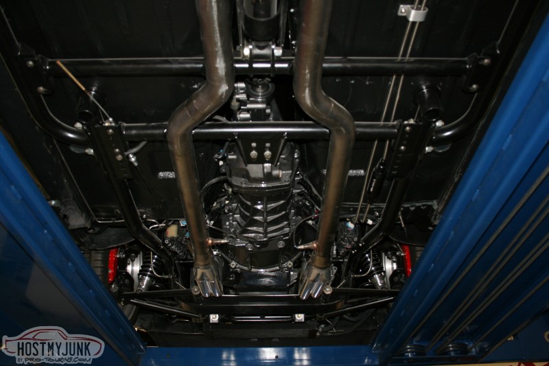

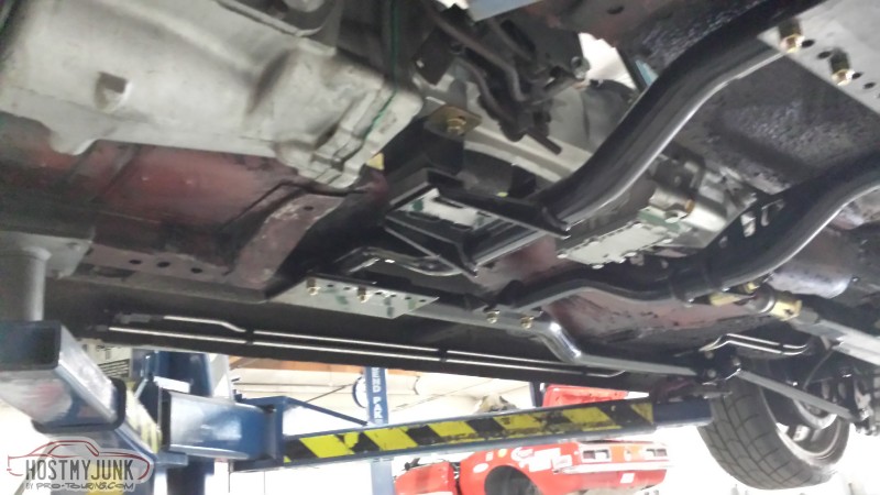

Here are some customer supplied photos that we have in our database. I tried to stick with 3" for this discussion.
& here are last year's Super Chevy entrants, Chad Ryker & Efrain Diaz. Both of which have our full suspension and 3" Mangaflow exhausts. There are pics of the underbellies in the gallery.
http://www.superchevy.com/features/1...ve-every-day#/
http://www.superchevy.com/features/1...day-supremacy/
-J
