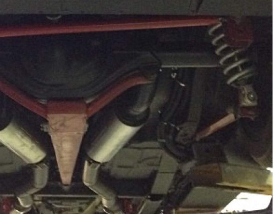

Hi gen 1 camaro ls3 ... Using Ptfe hose and a a vapor worx return less system.
first question I was considering running fuel line aprons the back of the engine. Specifically using resting clips that will bolt to the bellhouing. (Quick time so not to worried about the clutch coming apart and that being dangerous. So what concerns me about that location is the exhaust headers. The line will have to go over the top of them. thoughts or pictures of a si liar setup appreciated
second question ... If I run the line attached to the inside of the chassis it will end up real close to the mufflers eventually. If I run on the outer side of the chassis (think after market subframe And farm connectors) it will end up coming out by the lower suspension arm (where the leaf spring perch is) so what to do? Pics or ideas appreciated
Notice on this pic (not my car but same suspension) if he ran standard shaped mufflers it would be right on the lines ..
