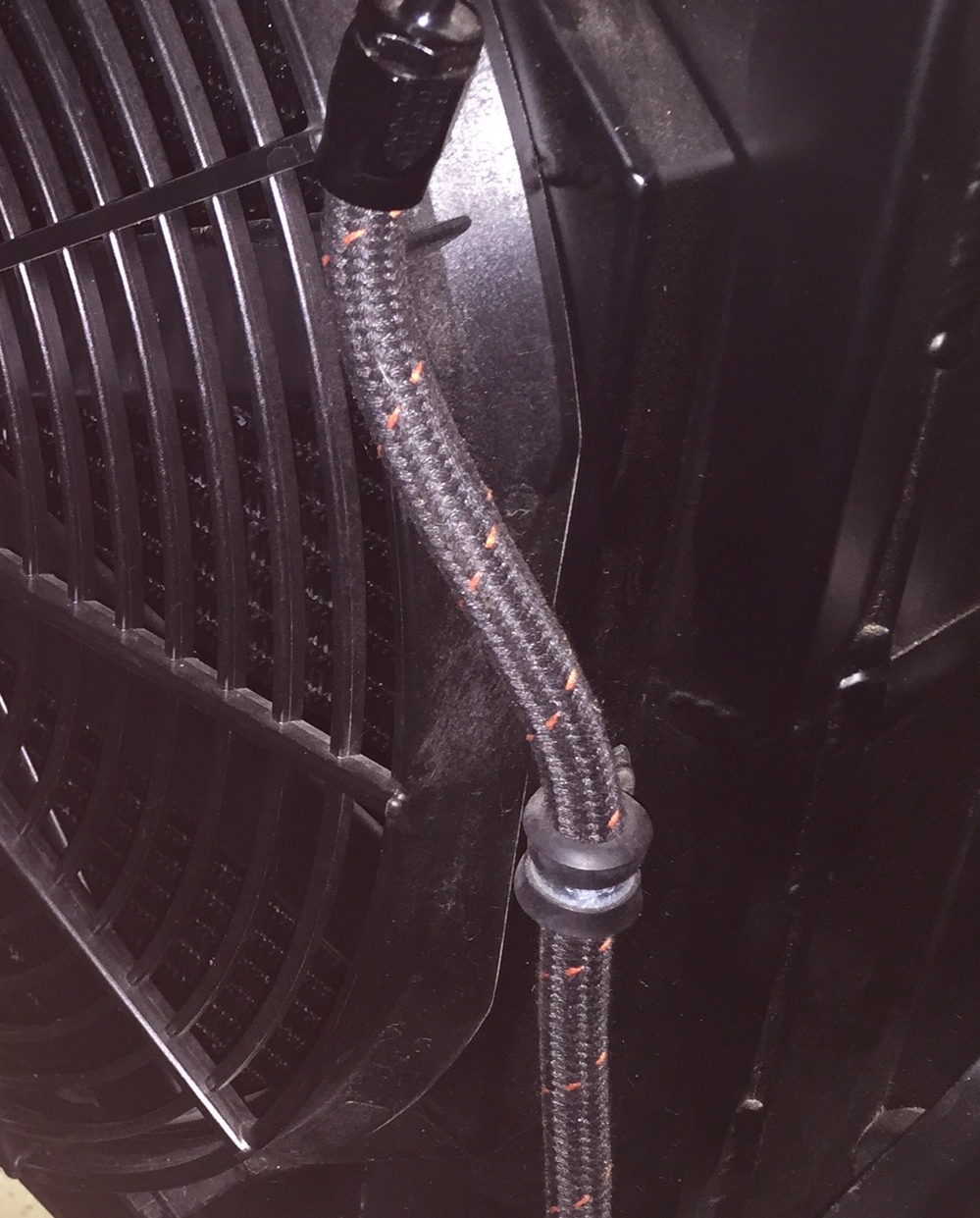

Pic of my fans. Having a hard time getting these sized correctly. As you can see, dual fans, shroud looks good. I think I still have air in the system. Last night I jacked up the front end and ran the engine, this is the first time the lower hose was as hot as the top hose.

Better pic of the shroud...
