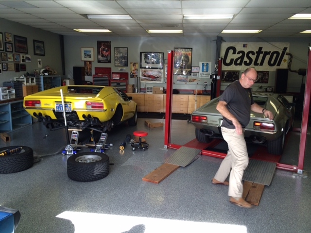

Had a bunch of people stopped by... one new car...
plenty of food.. most of us bench raced and we
did work on three cars
One car got new shocks, swaybars and ends
One car just trans fluid and brake fluid change
One car is still there. figured out the Msd box was
going bad.. it would start to miss above 3000 rpm
we got another msd but the new one is wider so
we need to make another plate for it.. and yes the
previous owner did not install the insulators so we
are sure that made it go bad
