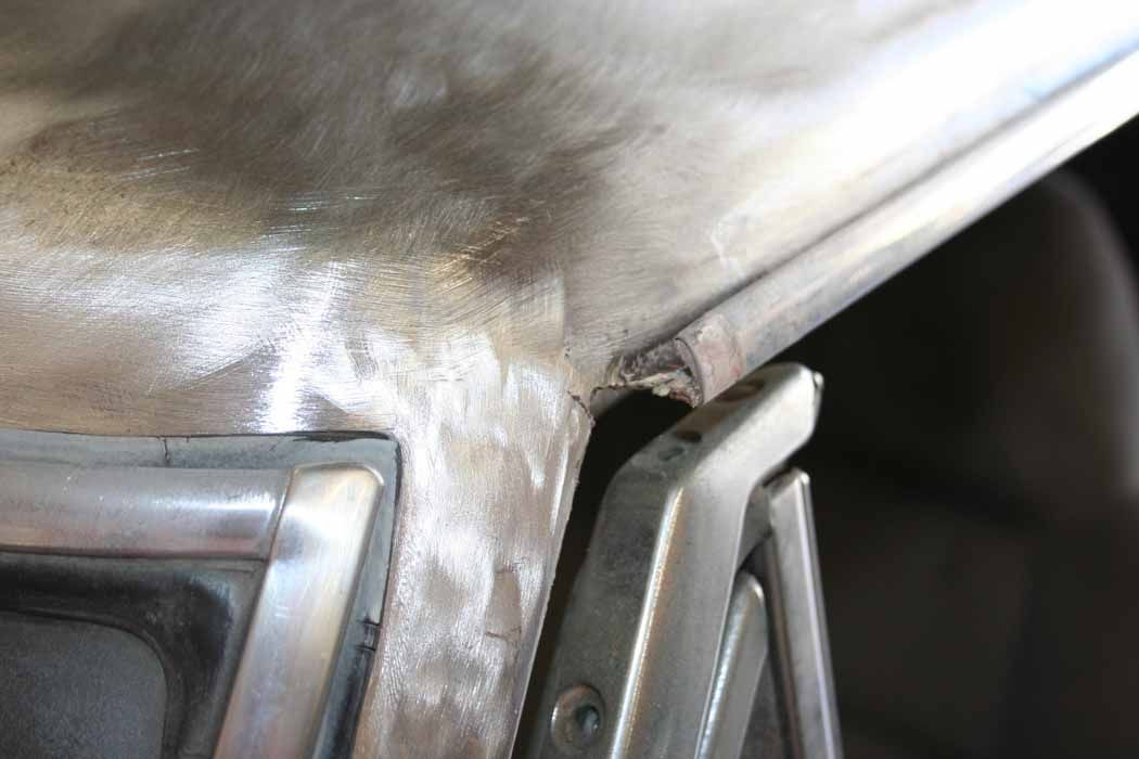

I have a 62 nova and didnt do too much research cause really, there wasnt much info out there. So I just went to town with what I knew. Turned out great. In person its better than the pics show. So, Ill kinda give my opinions and what I did, you may have already seen my thread. But here goes.
On my car the roof panel was folded into the window channel at the factory to produce the drip rail proper then topped off with a stainless trim. And a sort of caulking was laid in the gap between the roof and drip rail (dont know what this was for cause there wasnt any sealing issues. It was a thick, maybe 1/8" caulk. Maybe for looks so the drip rail didnt look so deep.
So my first plan was to remove the caulking. I ground down an old screw driver to the width of the channel and to a nice knife edge to scrape the caulk out. I got lucky, the caulk was old so it came off in nice long lengths, not so sticky after many years and it was stiff. So the lil tool removed all the caulk in a few minutes. And for the stuff that was still a lil sticky I used a narrow wire wheel to remove the residue. Oh, and this happened after I removed the stainless trim. Carefully mind you, some one can use it.
So my idea was to remove the caulk then go in with a thin abrasive cutoff wheel on the air angle grinder and cut off the drip rail, welding a tack every three or four inches to keep the roof from peeling away.
So I started with the wheel and realized real quick I couldnt see my cut line all that well. So I decided to bend the drip rail down about ninety degrees to gain some looksee space. I used channel lock pliers and hooked the rail top with one jaw while the other jaw was braced on the window frame. Pulled down till it was parallel to the ground then moved down a few inches and pulled it down some more till all the drip rail was opened up. MAN!!! Wish I woulda known I was gonna do that from the get go, it would have made cleaning out the caulking easier. Something to think about, learn from my setbacks
So now I am REALLY committed. It looked really bad. I went back to the abrasive wheel, thinking all the while Im not all that good with a cut off wheel, not like all the car and bike building shows you see on TV. I cant do what they do with a cutoff wheel.
They make it look easy. So I start off. I know I need a straight line. And I start off slow, I am using the slight rolled section left as my guide, I taped it off to on the roof for protection. But DAMMM!!! I just couldnt get it (the wheel) to ride a straight line. It would start out ok, then I would get a lil wavy, then it would bounce a lil, nick the roof, then more wavy. OH NO!! I had to stop that hack job. I had visions, of a really bad cut that wandered all over the place. And because its a fairly straight line, at eye level it needs to be good. I stopped hacking after about a minute or two and not even getting much cut, really only an inch of scored, not cut metal. It was gonna take me forever and it would have looked bad.
So, time to turn on the plasma cutter. I already had the MIG welder fired up and ready to go. Tape line was already in place. So you ask why didnt I use the plasma to begin with. Well, to be honest, LAZINESS. Thats my MO. All I needed to do was plug in two air lines, one for the big drier and from that to the machine. Didnt even have to move the machine, just unroll the 20ft torch and turn it on. Talk about lazy. Maybe I watch too much TV and the guys make it look so simple with the cutoff wheel. Not for me...
So I used the curve of the metal from the transition of the roof to the window frame as a mechanical guide for the torch tip.
The tape was a helper for well, not much. But it really did keep alot of the welding gases off the body. I found out the gases are really tenacious on bare metal, the orange brown staining from MIG welding is really hard to remove, even with sanding. Its like an instant rusting for adjacent bare metal. High heat and whatever gases are released from the welding. I imagine its the oxygen in the CO2. I have welded alot but never saw this nasty gas contamination. And I could tell it was the gas, not heat cause the staining flowed up and over the turn on the roof like a gas would, trailed off as the roof went horizontal and the hot gas continued up into the air. Weirdest thing. ANYWAY, where the heck was I LOL
Oh yeah. So with one torch (MIG) drapped over one shoulder and the other (plasma) over the other I made small cuts, looking for three inches of cut, drop the plasma, grab the MIG, spot weld, drop it, grab the plasma, three more inches and swap. Took about a minute for each side, rails gone and roof tacked up solid to the window frame. Auto helmet helps
Then it was a matter of just placing some HOT tacks all along the edge. And it was nice to have only cut three inches at a time. The seam never separated, they were still butted up tight together, I could see both edges of each panel, they were tight. No peeling of the roof, you DONT want that.
And I say hot tacks cause thats what you want. Some separated tacks but they need to be hot but fast. Dial up the machine a lil hotter than you would for doing a butt or lap weld of the same gauge sheetmetal. You have two pieces you are heating up, and its just a short pulse. Dont go so hot where you get meltback of the two, bad!! You just ruined the line. But dont lay cold tacks that sit on top, bad. You dont want to ball up the tack, too cold. And dont want to melt in. Not too hot and not too long. Hot setting and fast tack, on and off with the trigger. That quick. If its hot enough on and off will give you a spot weld that is melted into the parent metal, not sitting on top, the nugget will be half in and half out of the base, but doesnt melt the parent metal back. I like hot and fast.
I split the tacks from the start. If they were around three inches apart I went in the center of those. All the way down the line. Keep splitting the difference. When they got so close to each other and it started getting warm (I could feel it, I dont use gloves for the light work and I rest a pinky finger on the car for control) I used cooling, I used compressed air.
And really, if you have the time you dont need to cool it. Just take a break, many breaks. But compressed air cools great, just make sure its filtered and not off an oiled line, contamination you dont want.
After the entire seam was completely tacked, every part part of the seam, I sanded off the tops of the tacks, being careful to stay above or right at the body panel. I didnt want to sand ANY of the parent metal, just the tacks. After that you will see some small voids, you just will. Not a problem. Just lay a tack on the voids you see and sand it to the body line.
So then, maybe than, you have a nice solid rail thats all metal and looks pretty good. Maybe needs a thin smear of glazing putty, maybe a lil body filler. But you know its solid and wont shift with driving and pop out a nice chip of heavy filler.
Heavy filler?? Well, I have seen some guys use 1/8" or even 1/16" rod to make an edge for some seams, sometimes you have to. The problem I see is the radius of the rod is larger than the edge its applied to. So you have a pretty deep inner edge between one of the two panels. If for example you use it for the drip rail project you can weld the rod in low, so the transition from the roof to the rod is small. But that just makes a large V gap on the underside, at the window frame, the part you dont see. But you still have to get rid of the round rod look, so what happens is you fill the gap. A lead fill would be cool, maybe, I havent worked with lead. But what most folks do is fill the transition from body panel to rod with body filler. There is a pretty big chunk of filler in there. Yeah, its only the distance from the body panel to the curve of the rod, but it has a sharp root and isnt being feathered off dramatically like body filler needs to be. Body filler works on the body cause we use fairly thin sections and trail it off big time with feathering. A small tight area like a welded in rod is just the opposite of that. Thick (compared to the feathered area) and usually in stressed areas. Yeah, roof lines are stressed, they take alot of strain..
So yeah, I dont appear to be a fan of welding in a strip of rod at the roof to door frame line. Not so much of the rod, but the wedge of filler that is gonna be in there.
Anyway!!!! I have talked abunch, I tend to. Some pics???? JR
Stock rail... Ugly IMO.
Peeled back the rail...
Cutting the rail off..
Tacking it up...
The tacks sanded off. See the roll off from the roof to the edge. That was my line I used for my cut an d where I figured it would be a good separation point. The roof and window frame met up perfectly at that point. Be careful to not go inside of that point. You will have major gaps. Go to the point where the roof and window frame just meet up for the first time, just where they start to wrap around each other to form the crimped rail....
