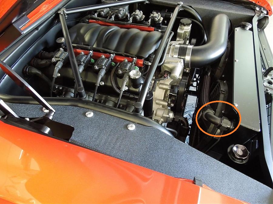

What brand of coolant hoses and fittings are you using in the circled area?
Hi Gary, the coolant hoses and fittings are: -20 Earls fittings and pro-lite 350 hose. I cut off the original slip on hose connection on the radiator and welded on a male -20 fitting. Hope that helps.
Yep -- thanks. I'm adding that to my project spreadsheet so I won't forget when I get to that point.
