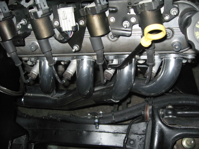

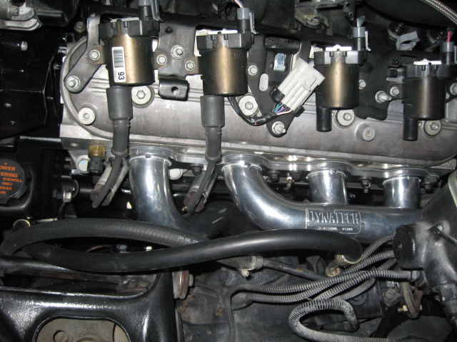

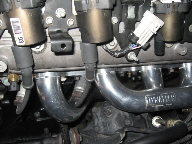

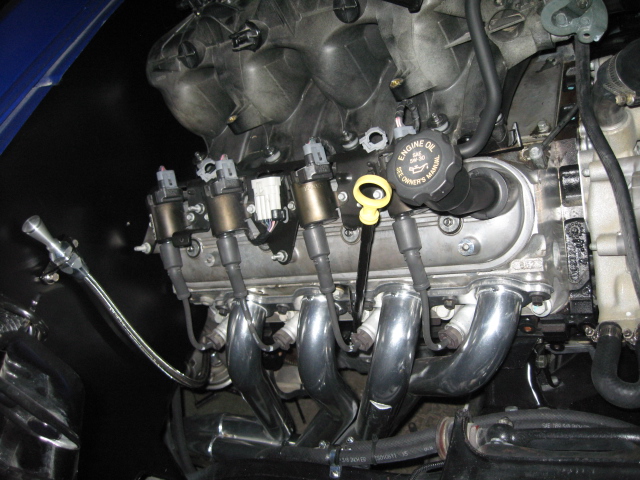

I used the transadapt plates and motor mounts (http://www.summitracing.com/parts/TRD-4595/).
The pictures don't do the headers justice because my power steering lines are in the way. The headers fit great and they were easy to retrofit to my old big block exhaust.

There is about 1/2 an inch between the driver's side upper comtrol arm and the primary tube although it's hard to tell from the photos.

I ended up using the msd multi angle plug wires with my headers. Just like I thought, the #5 and #7 spark wires are up against the primary tubes. I was able to bend the msd multi angle plug ends and then zip tie them up so they would not touch...but I recommend to anyone else using these headers to get the right angle plugs that will give you more clearance. The driver's side pic above clearly shows how there is not much real estate around the #5 and #7 spark plugs.
