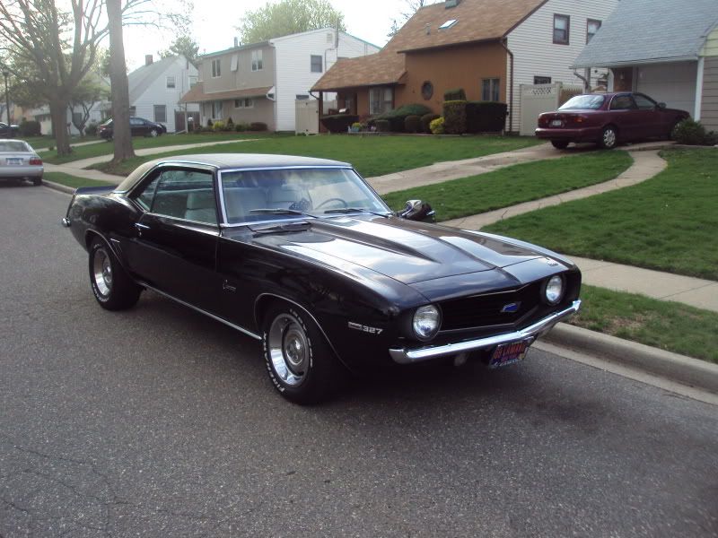

This is my 69 Camaro it has a nice crate motor (360 hp) a Holley 650 turbo 350 trans 342 posi rear (79z28) hooker super comps
I was thnking about selling it and buying a grand national for something more family friendly I have two little guys etc.... But I think I might go the other route
My question is does it pay to just add an aftermarket fuel injection set up and do my suspension or should I go with a full ls swap , was thinking of a 5.3 because my car is a original 327 car or an lq9 affordability is a huge issue want something turn key and reliable
