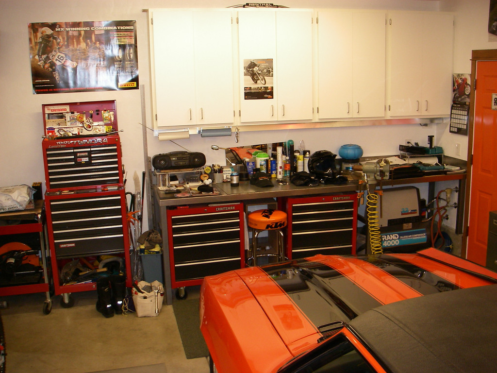

I went to a local larger scale cabinet manufactuer and had upper wall cabinets made. Built metal frames for the work bench that allowed 3/4" HD particleboard panels to be dropped in, then when to a local sheet metal shop and had the bend up 14 gauge cold rolled steel with a 7" backsplash and 2" front edge. Then put Craftsman tool boxes under the benches. Very satisfied with the results after 8 years of usage. Very cost effective compared to the prefabbed garage systems I've seen marketed.
Here's one section:

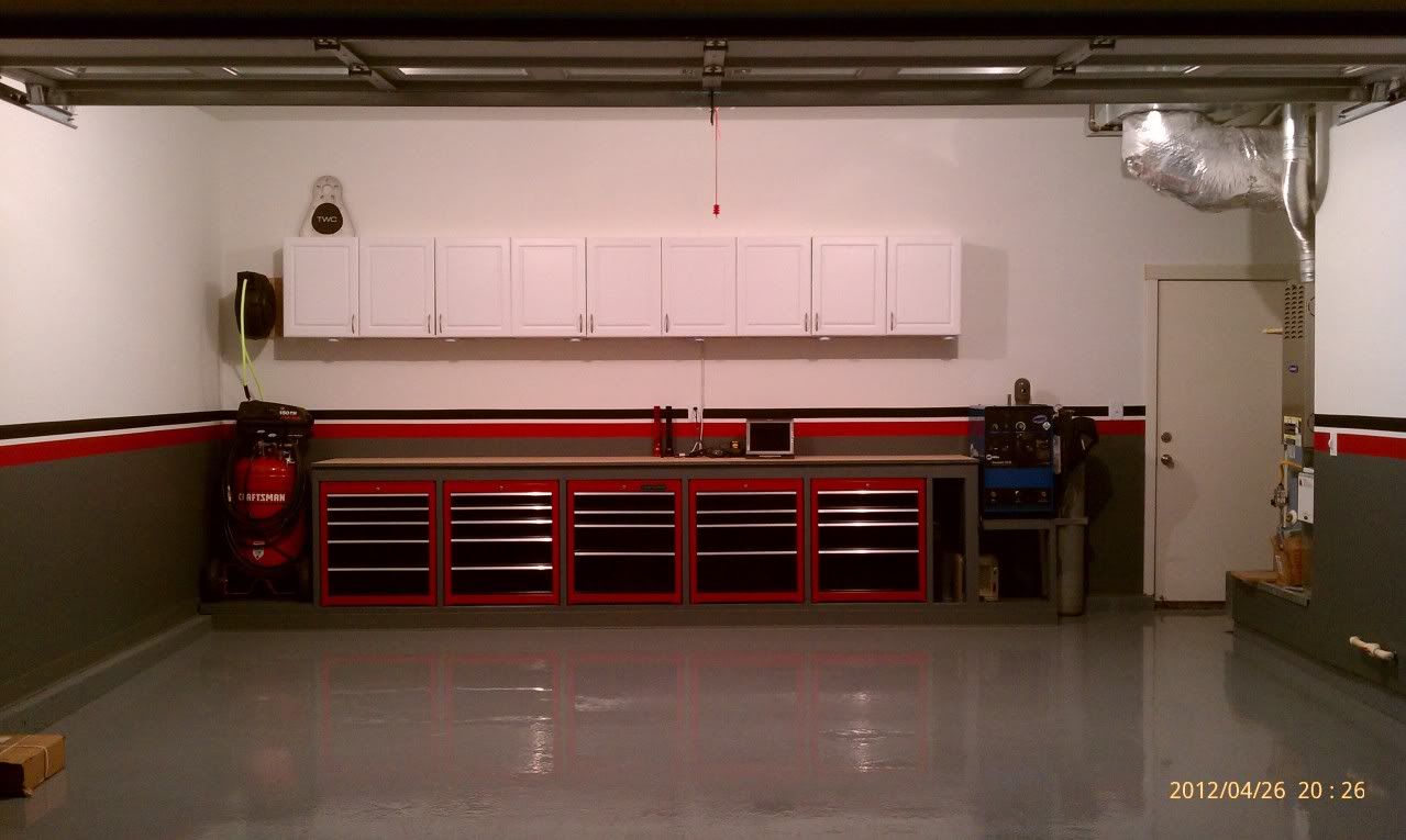

This cost me right about 150$ to build out, the Craftsman boxes go on sale all the time, and it seems to have turned out well, easy to build.

that looks fantastic, well done.
indeed!!
super awesome!

Well done!
