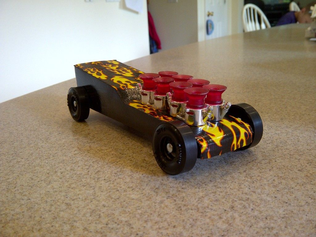

Tyler's first Pinewood Derby car!
Yes, it's fuel injected!

We did camber the wheels and raised the right front to reduce friction!
We also beveled the backs of the wheels and added graphite (after tech inspection). Polished and reverse beveled the axle "heads".
Car weighed in at exactly 5.00oz! COG 3/4" in front of rear wheels.
My 7 year old is very "engineer minded" and loved the project!
