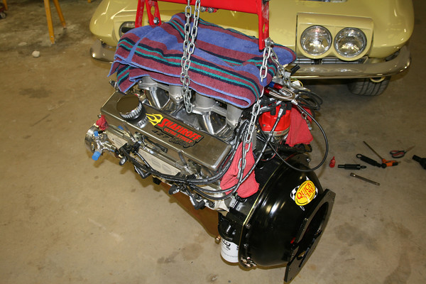

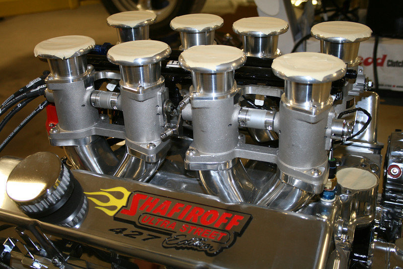

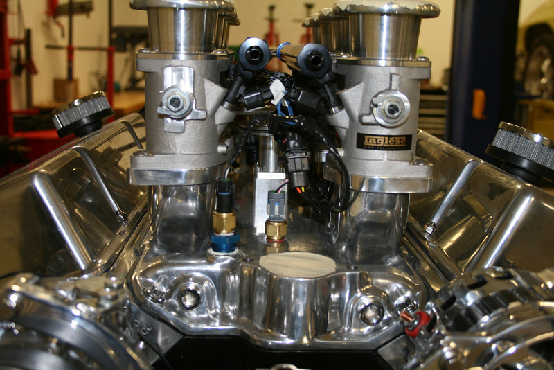

Default Inglese/FAST EFI

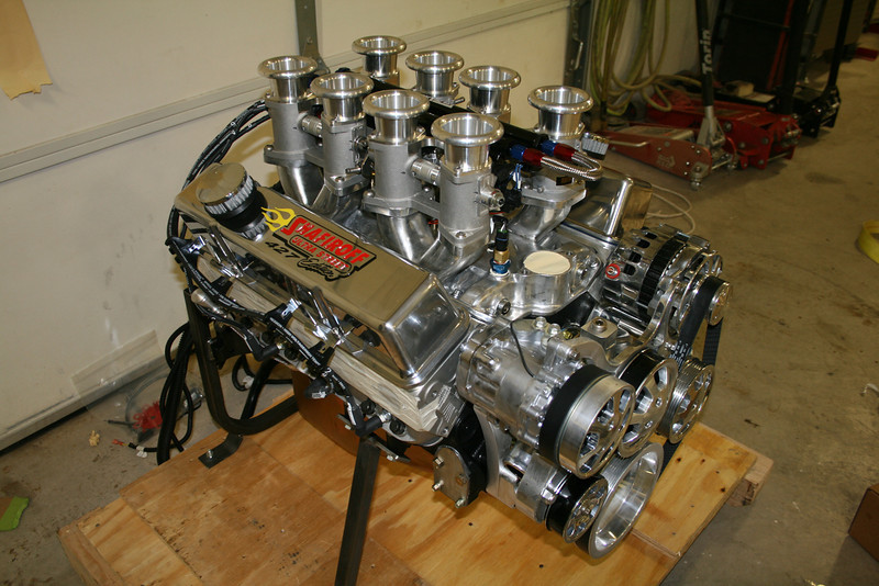

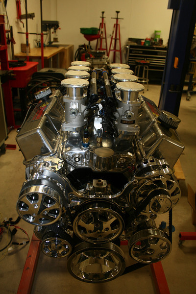

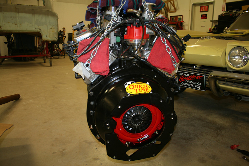

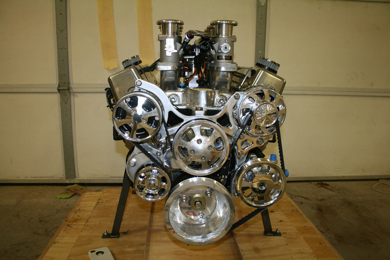

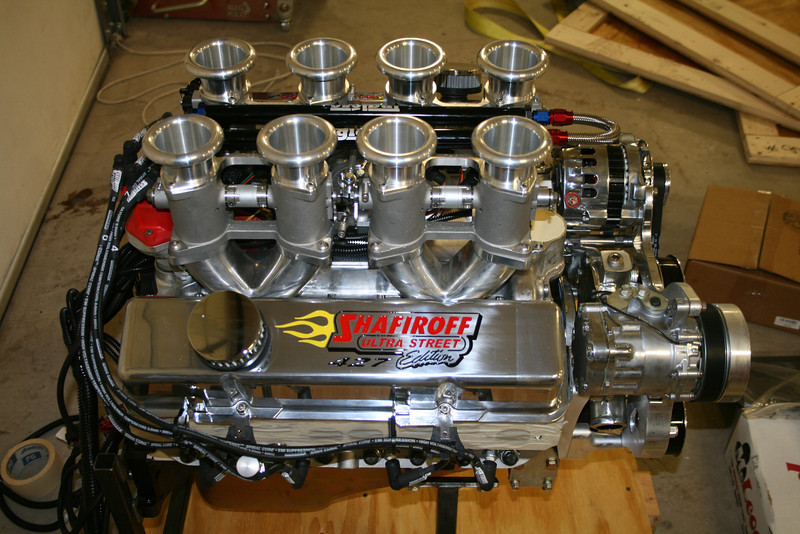

This SBC is getting installed my my 65 Corvette Coupe. It is mated to a Tremec 6sp with a final drive of .50.
Take Care - Jerry Clements

Click on the pics and they will enlarge. Im not sure what Im doing wrong to cause this problem.

Jerry, please keep us posted on this! I am very interested in the Inglese setup for my project.

Does anyone have pics of how they ran the gas lines and wiring harness?
What are you going to control it with?
For an IR even the XFI 2.0 doesn't have some of the calibrations available that will make tuning easier. You might want to look into other systems as well.
And I've been following this post. Jody and others- I think one of the things that gets lost here is that although your applications run good with or without referenced fuel pressure or whatever, maybe they can run better with it. I think that's part of what Brian was driving at
Jmo.
Mark
