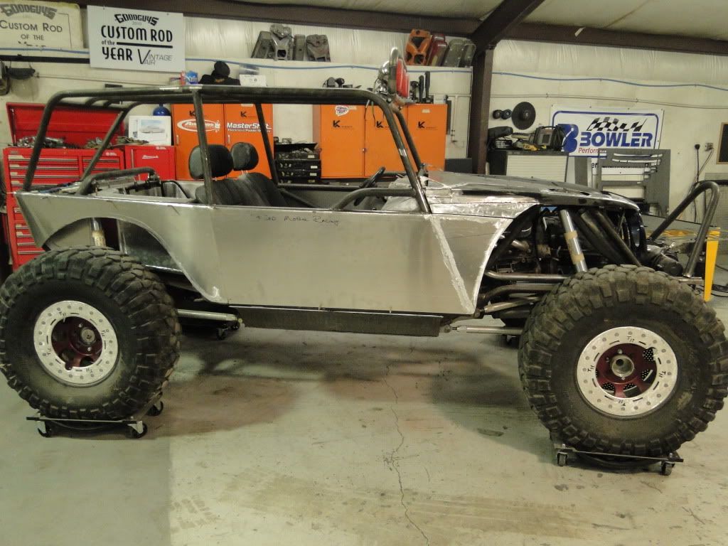

That there is pretty sweet! What running gear and transfer case are you going to run?

It has 4.88 gears , atlas 4 transfercase , with a 10.2 low , th400 trans , and a 6.0l ls . the LS has ls6 ported heads , nitrous express intake , comp cam and springs .
and yes 4 helmets !

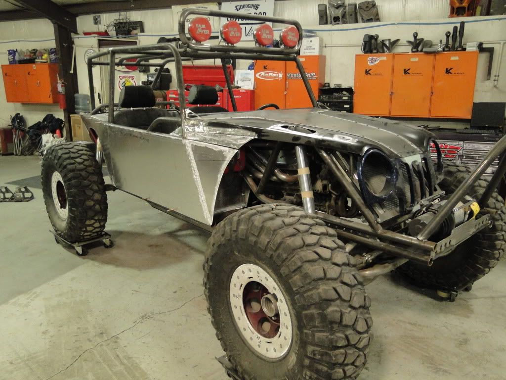

update photos

I am not sure what traile you hit and your wheeling style, but seeing you built a four-seater, a small recommendation is to add more triangulation on the cage if you are going to be attempting something a bit wilder (and I think with your build specs it definitely looks like you will!
I would add braces on the B to B pillar, and B to C pillars, and also V or inverted V on the A pillar to center of dash.
Killer build, so keep it coming and great to see I am not the only one with project ADD here, hehe!

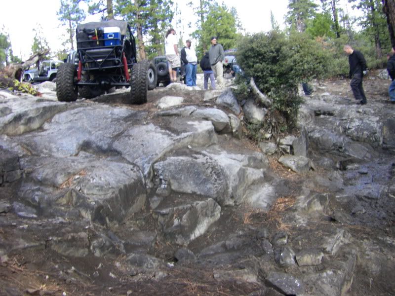

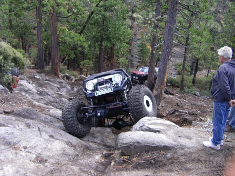

Current project (TJ on tons, 4 sp atlas and other toys) - CO's are sitting getting dusty in the garage
My old buggy (Cruiser..ish Pontiac 400 engine, one tons, CO's rear, blah blah):
