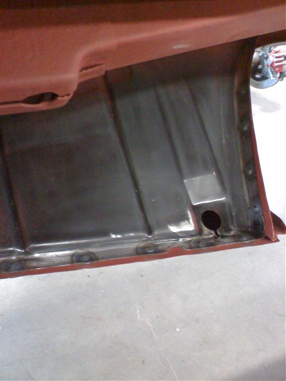

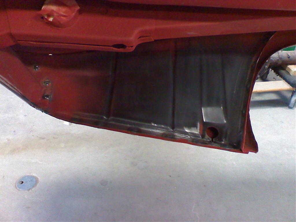

They didnt go in easy, I trimmed the back part that goes behind the tail panel .its kind of a one shot deal once it goes underneath the trunk pan it will be a pain to get back out, when done u cant tell though.
Old 11-02-2010, 04:43 PM
kush69 kush69 is offline
Join Date: Feb 2010
Posts: 38
couple more pics i found
