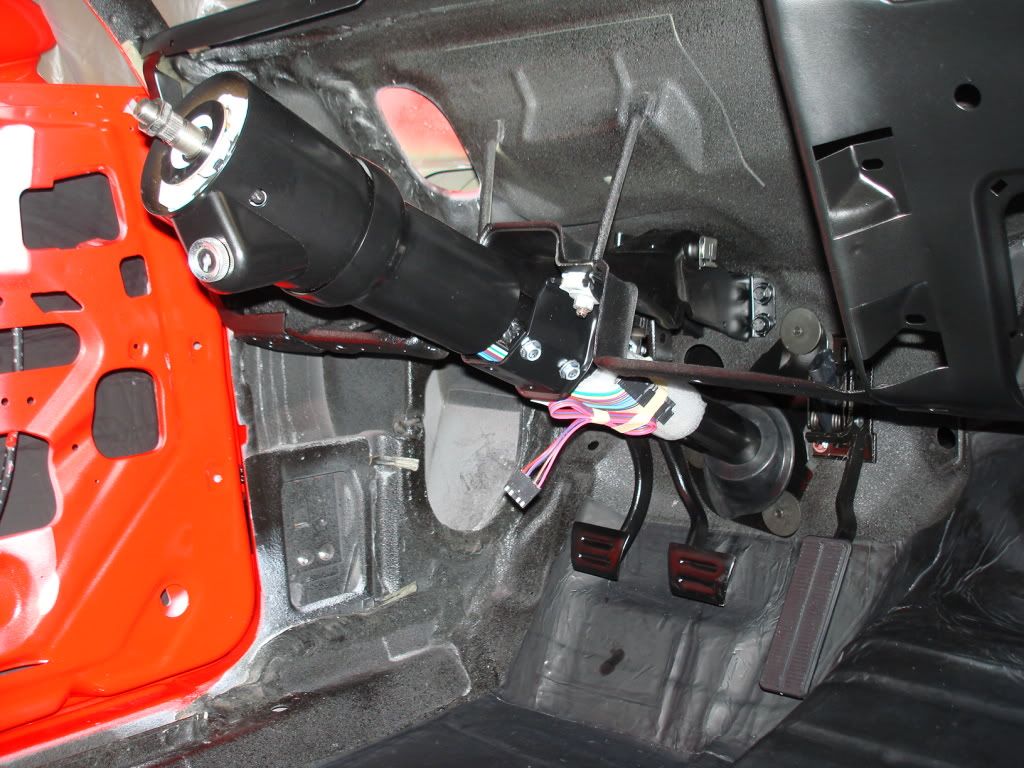

Having just installed this Ididit in the 69 yesterday, thought I would post up a pic. The center bracket attaches to two welded tabs already welded to the column to accept the factory bracket for a direct bolt in. The lower clamp/bracket at the firewall and the factory boot fit the column perfect. The main connector is also the flat type, In an after market column I dont believe you will find the curved style connector shell to match the factory harness. Cant complain about the install it was to easy.

ya that is a nice column, I looked into those and they are a little spendy for me but it's really as good or better then an OEM one.. I also discovered that the plastic cover that goes around mine under the instrument cluster is bigger then the flaming river column so it leaves a pretty big gap around the column...yeesh...
