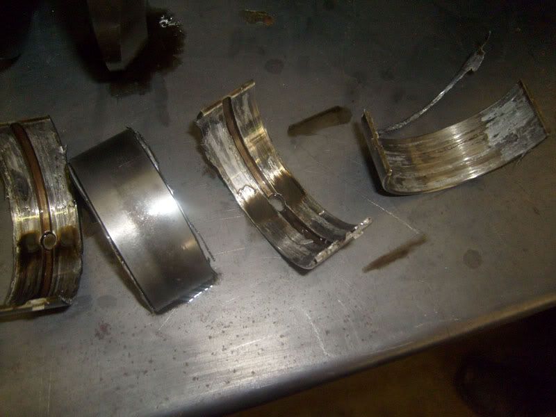

A couple weeks ago our 454 lost oil pressure and developed a low end knock. Got it in to the local shop on Friday. They had oil pressure so I had a little hope for it. They pulled the block, dropped the pan and there were some big chucks of rings in the pans and also a ball of what looks like steel wool which was what plugged my oil pick up and caused the loss in pressure.
They pulled a couple rod ends before the end of the day and found a couple pretty worn bearings The crank didn't look too good either.

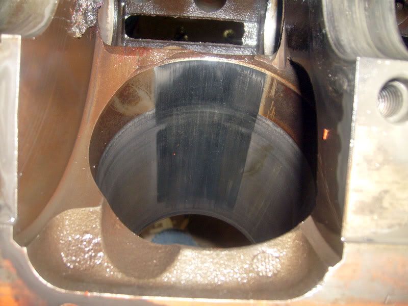

Monday they pulled a couple pistons and the cylinder walls and pistons were scored. So they knew it needed to be bored and rebuilt. Today they broke the rest of the engine down and found a few worse cylinder walls and a spun main bearing. The crank was for sure toast for sure at this point.
You can see that the engine was stuck at one time.

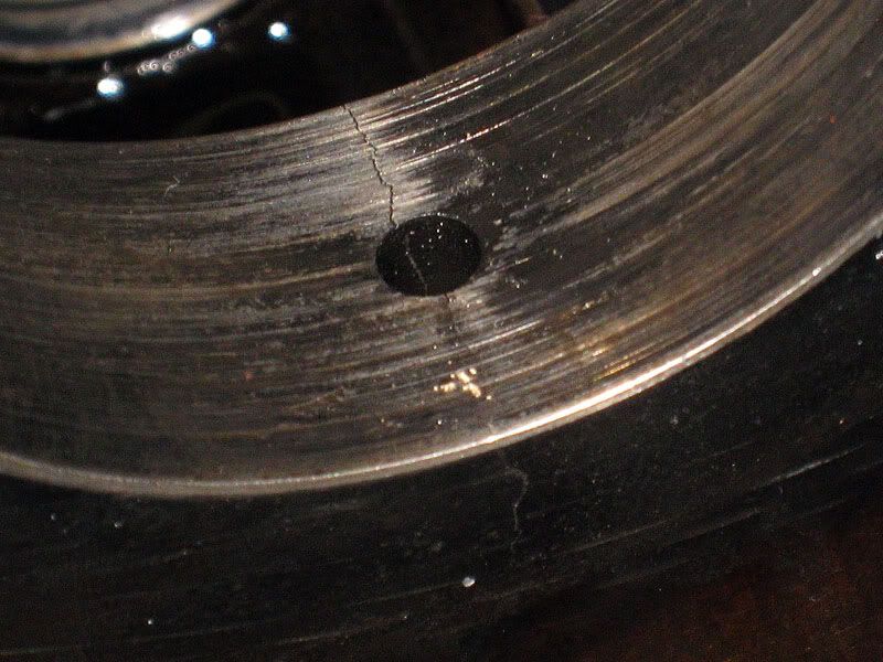

They dropped it off at the machinist. While cleaning the block he found a lovely crack through one of the mains.
Now I'm looking for our next step. When we bought the car the plan was to be driving it this Summer not rebuilding it. So we don't want to get stuck in engine jail. We're leaning towards a crate motor and we want to stay BBC. We want something that will be great for street use but some extra HP would be nice.
