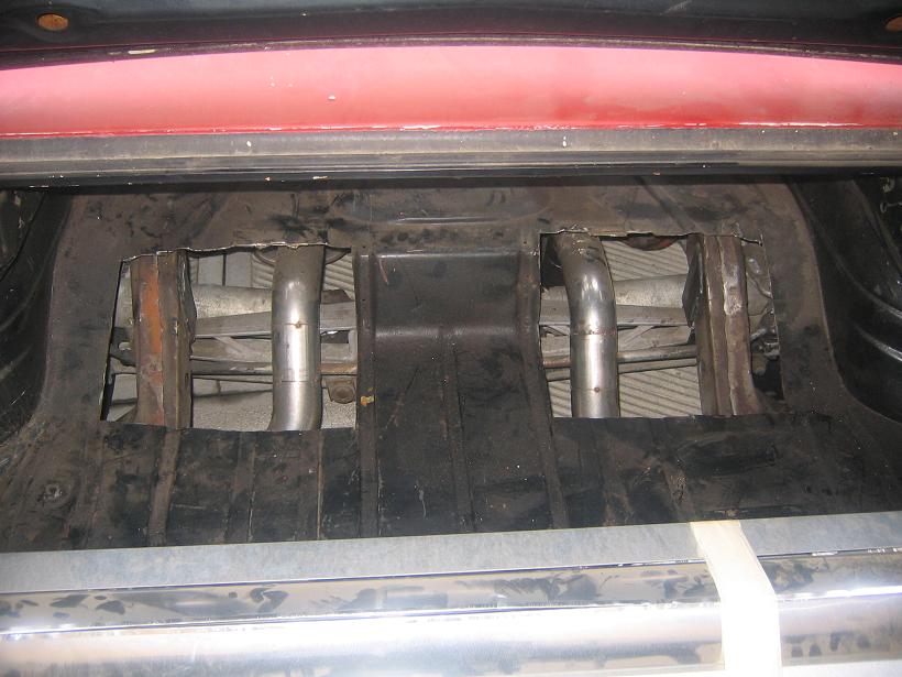

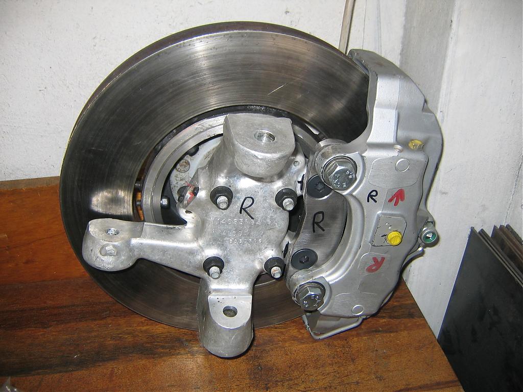

The front part of the frame have been modified to accept a Corvette C4 front suspension, QA1 coilovers and Porsche six-piston Brembo calipers and 14.25" x 1.25" rotors.

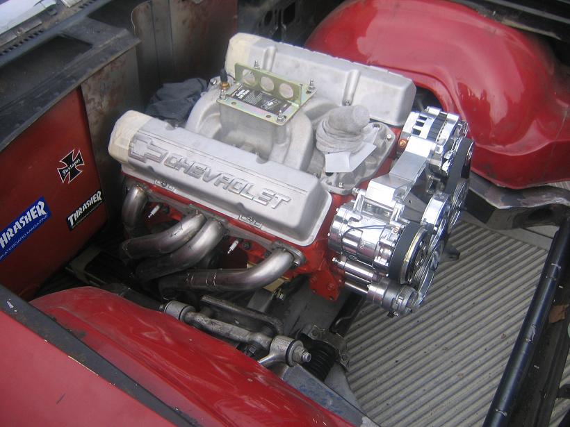

The engine and trans sits in the boxed frame, the engine (for now) is a 355cid SBC with ported fuelie heads (future plans are for more inches and nicer heads). The trans is a D&D Viper T56.
The rear of frame has been narrowed to accept the Corvette C4 rear and QA1coilovers, the rear is all installed and spot welded.

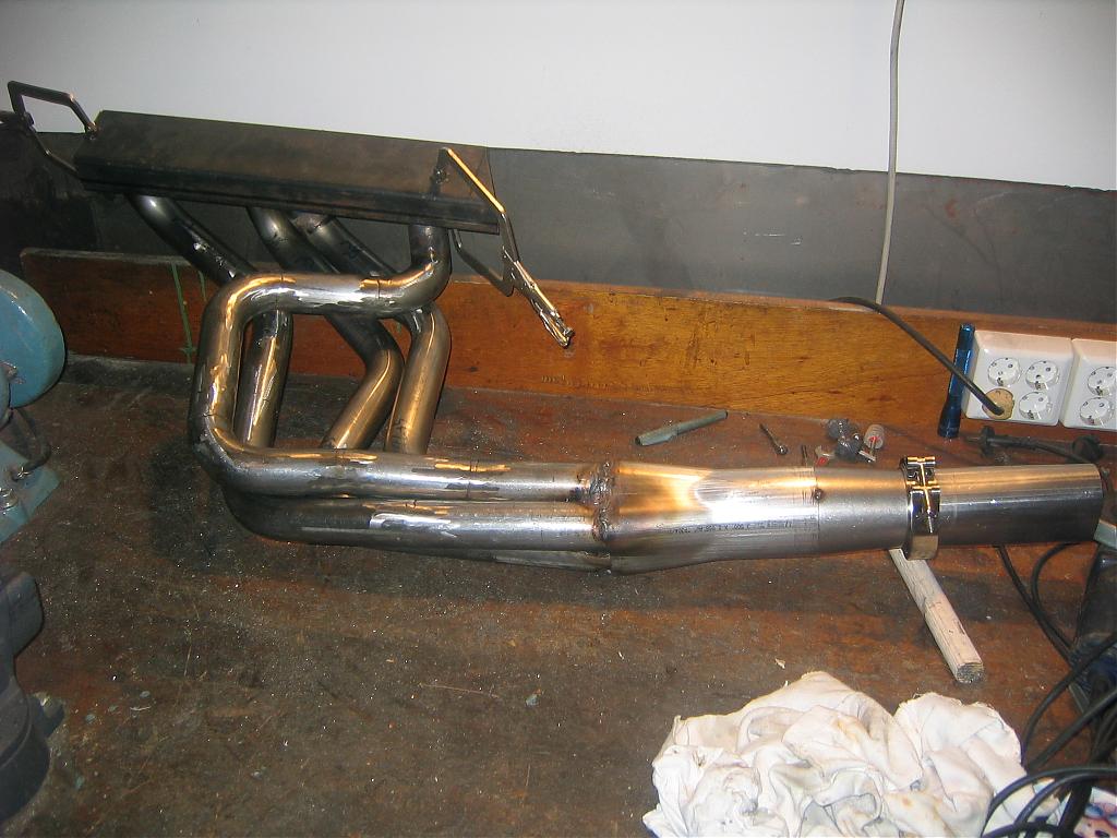

One stainless header done, one to be finished

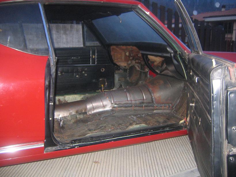

here are a few pics, more to come as work procedes.
what do you think?

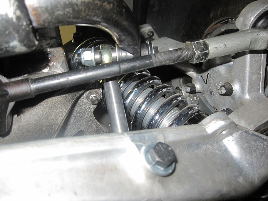

how did you fit the porsche brakes on the C4 spinle? and wghere di you mount the spring on the rear upright?

Hej Deuce,
I'll post a couple pics of the spindle.
in the rear I modified the original shock mount to look like a fork, I'll see if I can find you a pic.

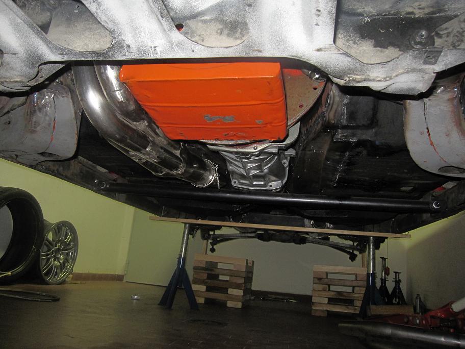

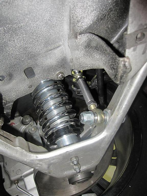

Hi all,
here comes a few update pics.
I havent done much but the swaybar is measured up, the endlinks are made and holes are drilled in the frame.
