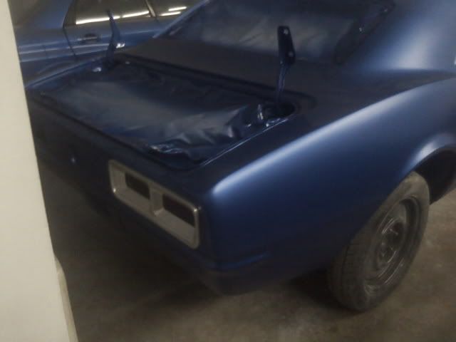

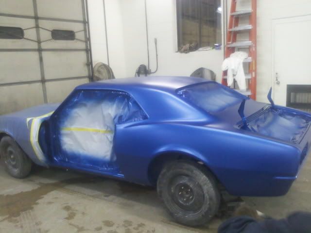

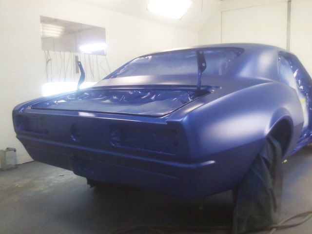

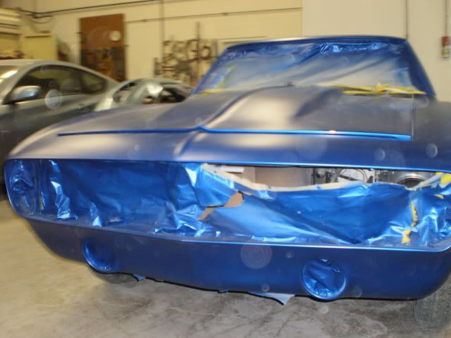

got the jambs ect cleared. gonnathrow it back together scuff her down then shoot afew more coats of base then clear it out.
sorry for the lowquality pics.thanks for being interested in my build

thanks for the replies.the car has a long list of body mods
cut drip rails off and rounded over edge.
flush mount glass
no emblems
no side markers or antenna/its hidden in windshield
no exterior locks
front end and rear end totally welded up.no seam sealer
front va lance holes filled in and 69 lights grafted in.
cowl filled in
hood recess by cowl filled in
rear spoiler nubs cut off to make it flush
rear bumper sectioned and smoothed out.fits real tight.
i know there more but im short on memory/lol
its been a long road but now the stress of no chips starts
thanks for looking
