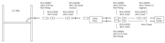

Maybe this will help.
on the fuel pump most use the walbo gsl-392 but for a bit more a good upgrade is the bosch 044 or(#0 580 254 044)
let me know if you need more info.

Do you have a bigger version of that diagram (the part numbers are a little hard to read)?
I Pm you email and I will send you one. I will also try to repost a larger file.
