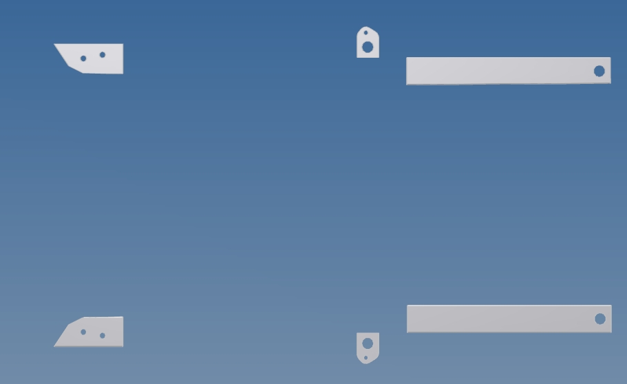

I am learning to use Autodesk Inventor Pro. Attached pictures show what I have modeled in 3d very roughly, so far. I have just been using data I found on this forum and what you gave me to rough out sub frame.
If I had the measurements, I would like to build a library of components. Members could ask me to check fitment digitally or just see how it looks. If a member wants to view in 3d, I can send a small version of the file with a link to download a 3d viewer called e-Drawings for free.
I got hurt in a gas can explosion a little over a year ago. Creating this library will keep the cabin fever away.
