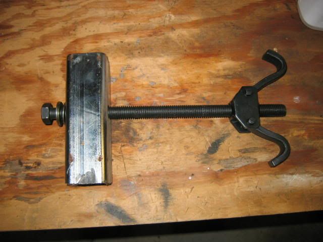

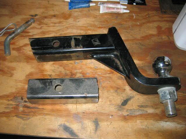

I've used this method with good sucess. First slide the hook set off of the threaded rod and discard it. Then use just the hooks that include the threaded collar and a tow hitch that's been cut down some. Slide the cut down tow hitch over the threaded rod and run the threaded rod up through the control arm or down through the subframe.(either way works depending on clearance) Then fish the hooks with the threaded collar through the spring coils and thread them to the rod. Then just use a ratchet wrench or an impact to tighten the coils up while the cut down receiver hitch holds against the control arm or the subframe and your good. I will try to post pics later tonight to show better what I mean.

Ok here's a couple pix of the receiver hitch cut down and the spring compressor with it set-up. It doesn't look like much but it's much safer to use when installing coil springs.
