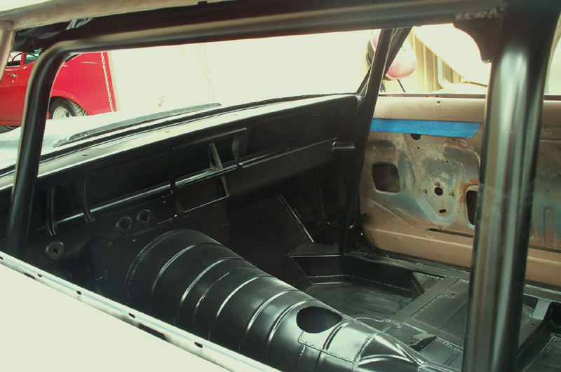

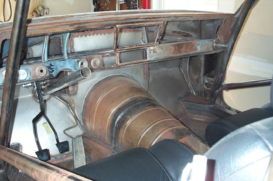

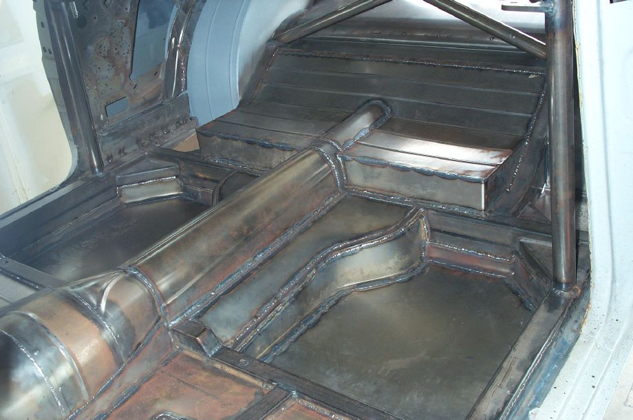

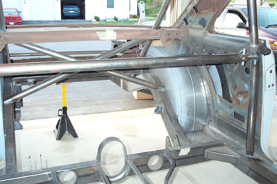

Frame:
Custom built by Art Morrison. 2x4x.120
frame rails, 1.75x.083 4130 12 pt cage. Custom floor,
firewall, wheel tubs, transmission tunnel, and trunk
fabricated from various gages of 1018 cold rolled steel.

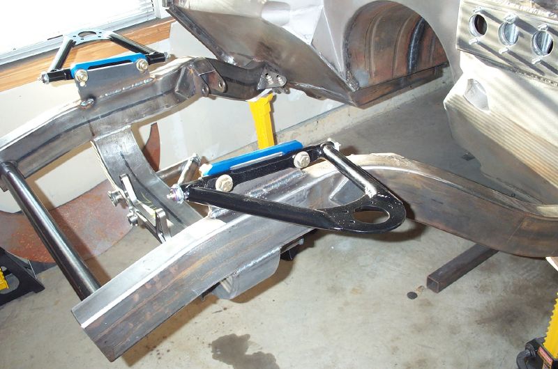

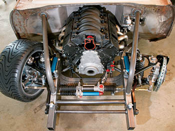

Suspension: (front)

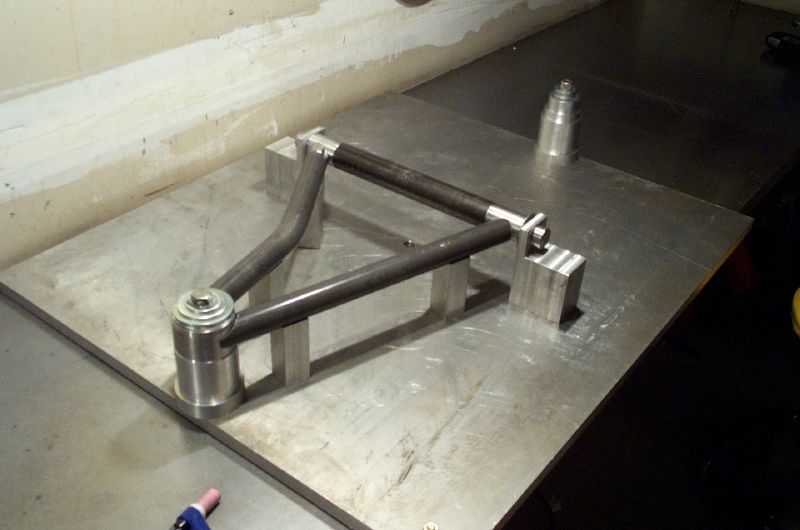

Scratch built custom SLA. Features 4130
tubular lower control arms, needle-bearing upper control
arms, Howe Racing ball joints, Stock Car Products modular
sway bar, C4 hubs, and custom fabricated aluminum uprights,
coilover mounts, and crossmember. (rear)
Scratch built custom road racing 3 link.
Features adjustable control arms and panhard bar plus custom
sway bar. HAL QA1 coilover shocks, and Lensing springs all
around. Designed for 1+G in street settings, 1.15G in track
mode.

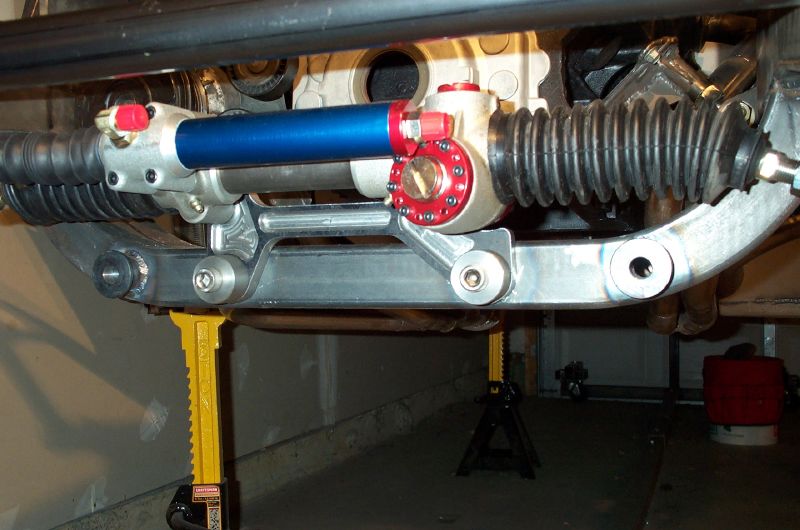

Steering:
custom Tony Woodward rack, Lefthander
Chassis tie rods, and custom machined 4340 steel steering
arms.

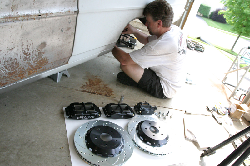

Brakes:
Front- Wilwood 14� 2pc rotor, slotted/cross drilled,
Wilwood 6 piston radial mount caliper, Rear- Wilwood
12� 2pc rotor, slotted/ cross drilled, Wilwood 4 piston
fixed caliper, Pedal assembly- Wilwood firewall mount
dual master cylinder and clutch assembly with balance-bar
adjustable front to rear bias. Hydraulics- Wilwood
0.75� master cylinders (x2)

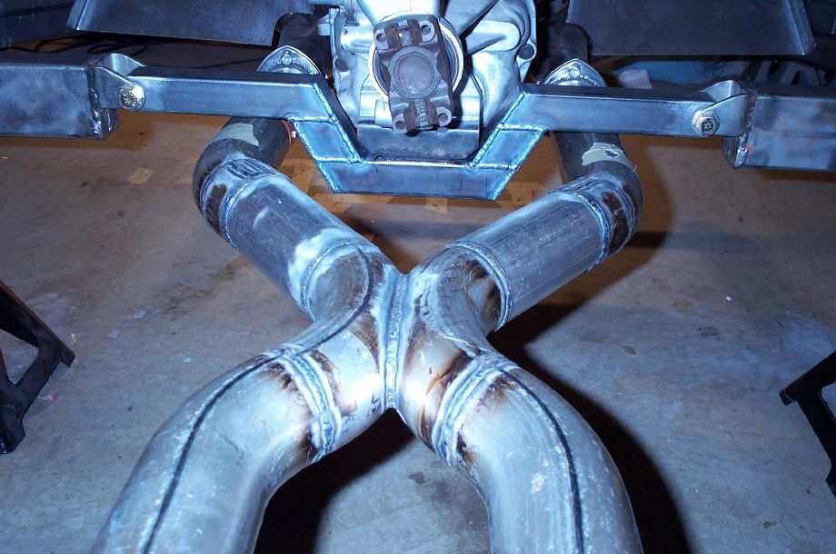

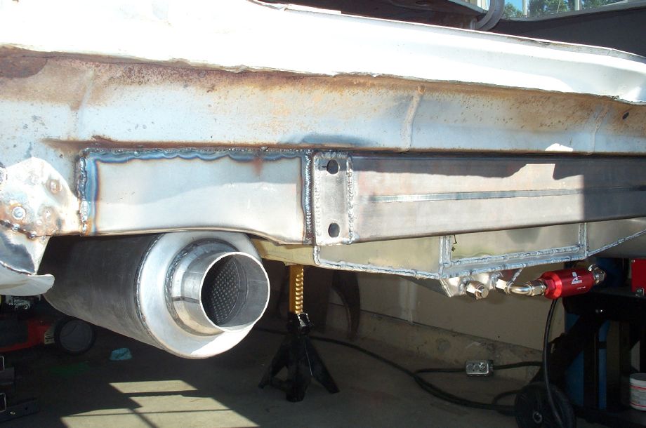

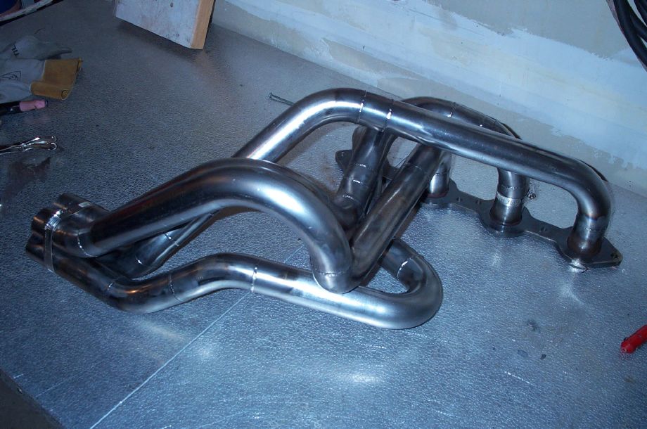

Exhaust:
Custom built 1-3/4� 304 SS primary tube
headers to a 3� exhaust with
fabricated X-pipe, with bumper outlet.
Click here to see the article
that John wrote for Car Craft Magazine.

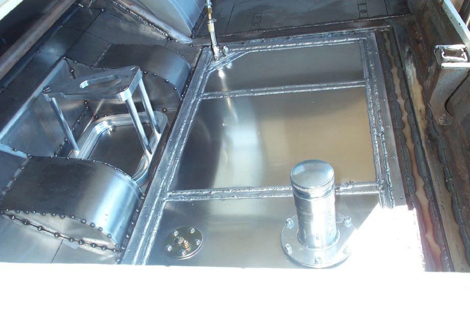

Fuel system:
Custom built 16 gallon baffled aluminum fuel cell with sump
in rear trunk area, external Aeromotive A1000 fuel pump,
stainless steel hardlines.

Engine: 427
using Rapid Motorsports sleeved LS2. Lunati
reciprocating assembly.

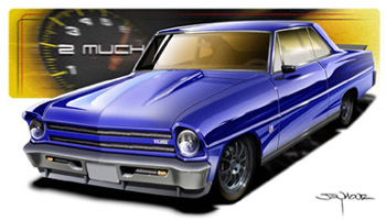

Exterior

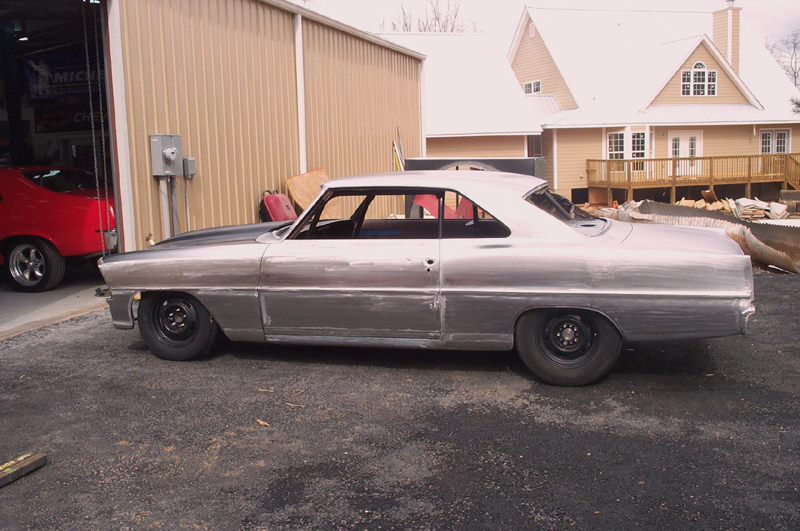

Body Panels:
Harwood fiberglass
cowl induction hood, with speed pins,
custom hinges, gas operated actuation. Custom adjustable
front and rear spoilers. Fabricated aluminum trim,
stainless mesh, fiberglass bumpers, etc.
Paint: Dark Blue with
metallic gray and anodized aluminum trim.
Trim & Moldings: custom
fabricated and anodized aluminum, custom II Much badge.
