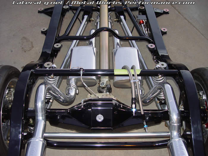

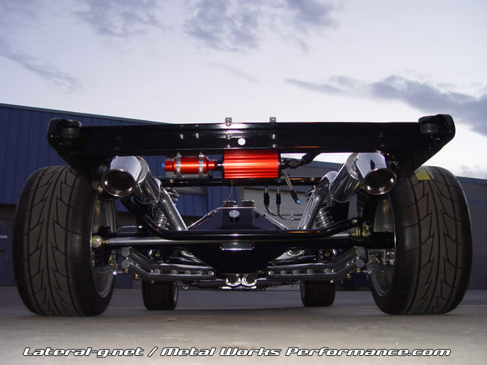

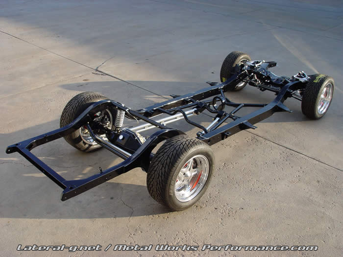

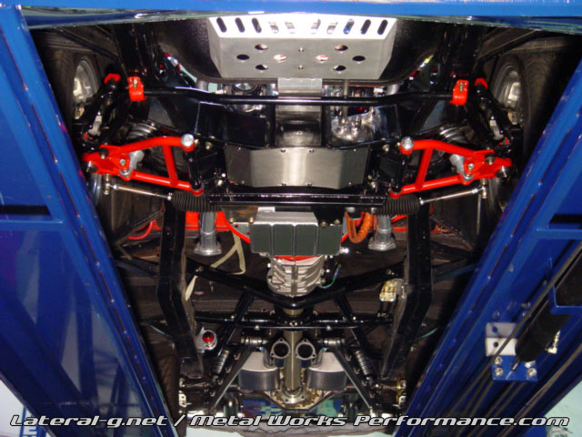

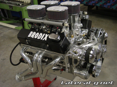

Motor
- Brodix aluminum 406 ci SBC, Cola crank,
Crower rods, Crane roller cam
Heads
- aluminum Brodix
Induction
- Momar individual runner fuel
injection system
Transmission
- Richmond 6-speed
Rear end
- FAB 9 housing, Mark Williams 3rd
member and axles, 3.55 gears

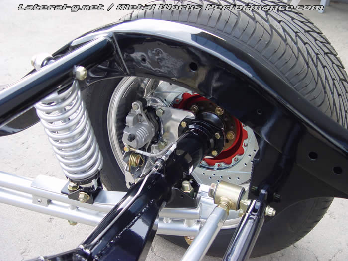

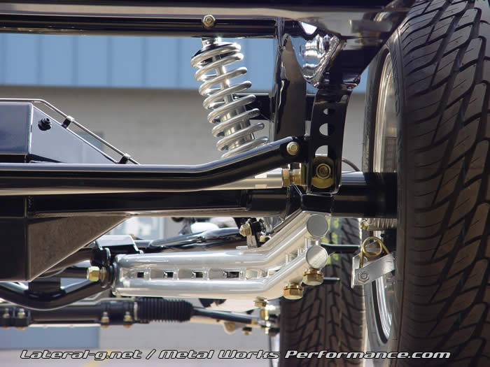

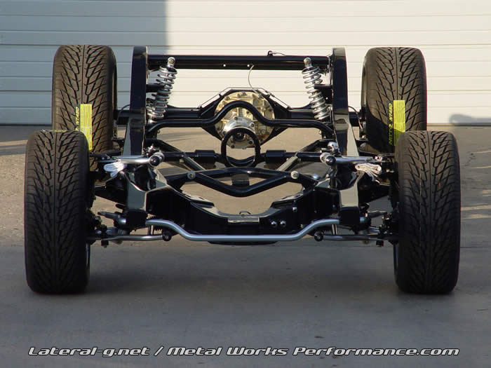

Front suspension
- independent tubular upper and lower
A/arms with QA-1 coilovers
Rear suspension
- MWPE tubular truck arm suspension
system with QA-1 coilovers
Braking system
- custom designed by MWPE utilizing a
hydroboost unit from Hydratech Braking, utilizing C-5 corvette
master cylinder and Baer prop. valve, front
has Baer 13.250 2 piece track system with
B-body spindles, rear has 13.250 2-piece
touring plus system

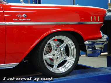

Wheels
- Boyd Coddington Genisis 5
Front 17x 8.0 w/4.500 backspacing
Rear 17x
9.5 w/5.750 backspacing
Tires
- Nitto NT 450 Front 255/50/R17
Rear 275/50/R17
Some of the Details:
All
fluid systems plumbed with polished
stainless steel lines. Fittings in
polished stainless steel and black
anodized.
Center
Force clutch and Hays flywheel
McCleod/Wilwood
hydraulic clutch system

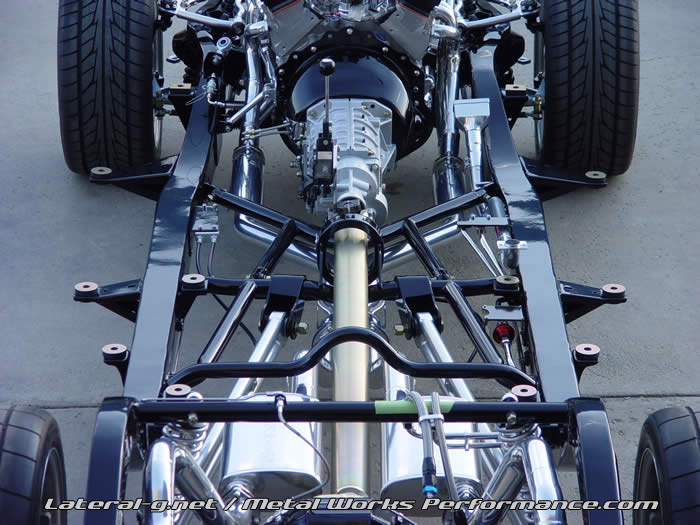

Mark
Williams aluminum drive shaft w/1350
series rapid release yoke
Stainless steel fuel tank modified by MWPE
Aeromotive fuel pump
and filters
Electromotive engine controls
MWPE
custom radiator with dual spal fans
MWPE
custom ceramic coated, mandrel bent exhaust
system with MagnaFlow mufflers, X-pipe and
stainless steel tips
Thorley
headers
MWPE
custom fabricated tubular chassis
reinforcement system
Polished
stainless steel ARP 12 pt. fasteners
throughout
Black
and gray leather interior
Dakota
Digital gauges
March
serpentine belt system
All
custom fabrication by MWPE
