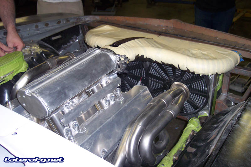

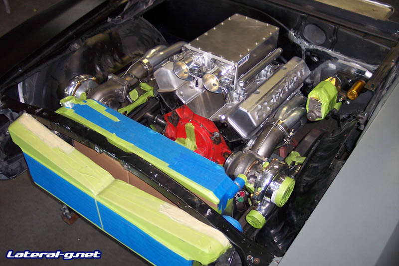

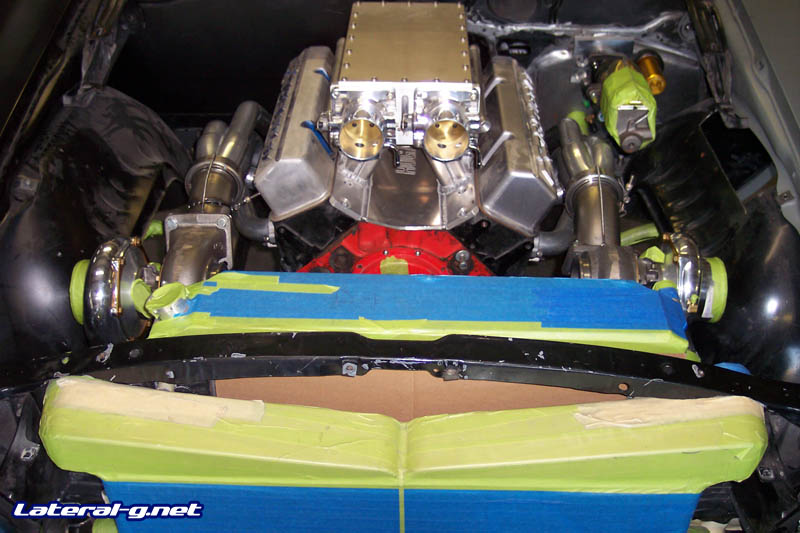

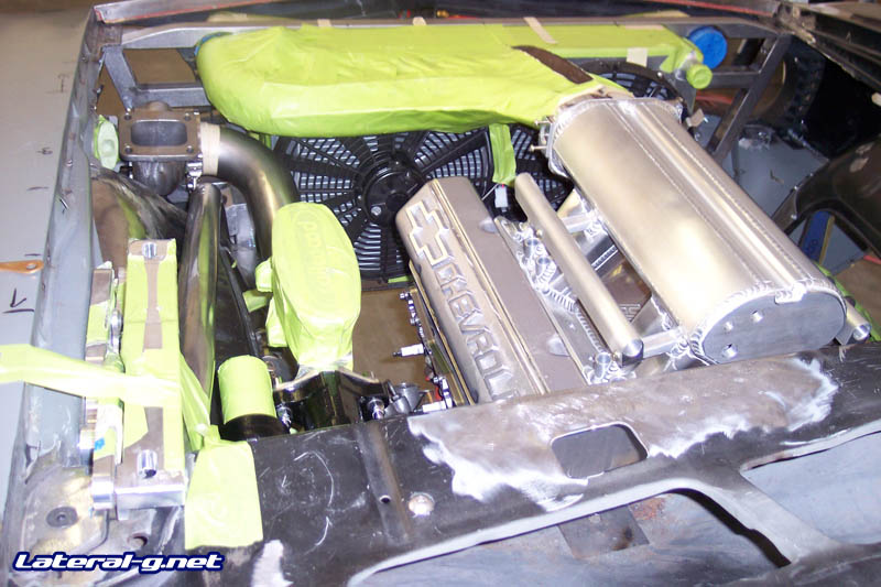

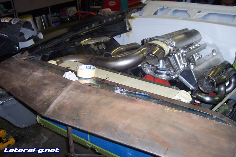

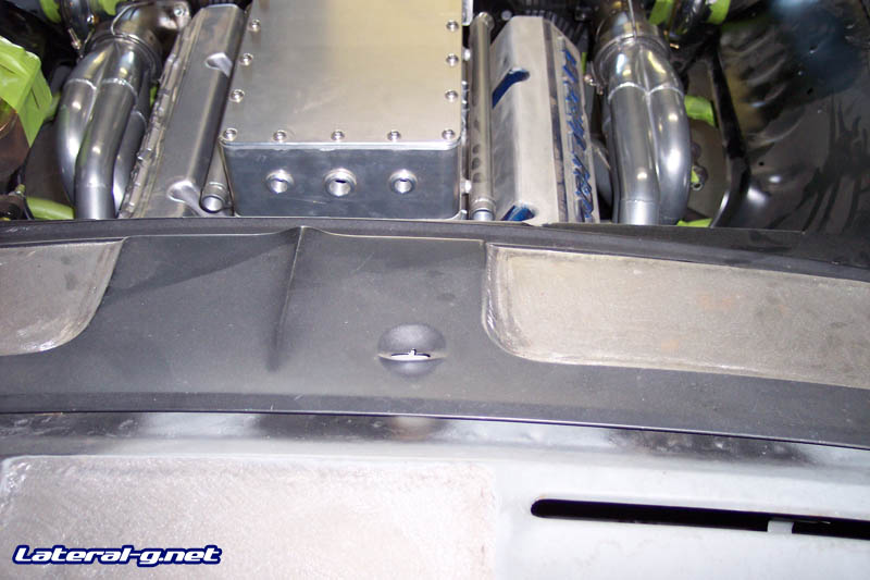

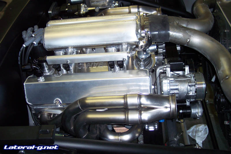

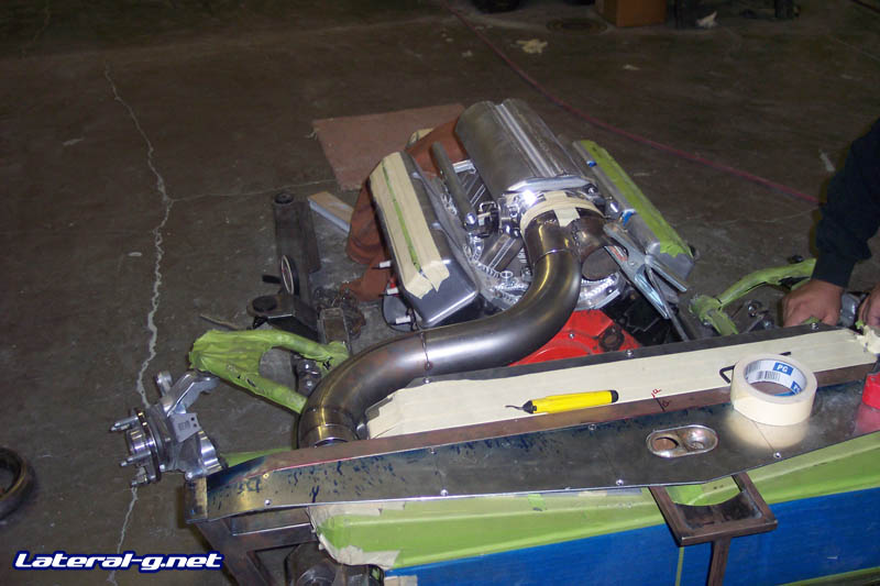

Powertrain/Engine

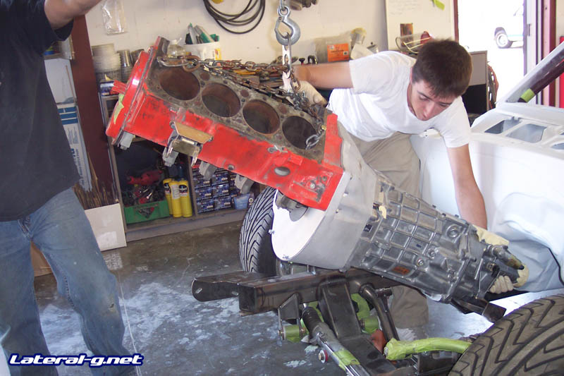

Viper T-56
Currie Aluminum center with 4:10 gears

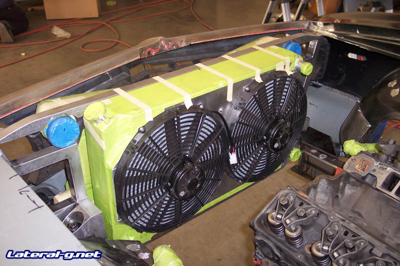

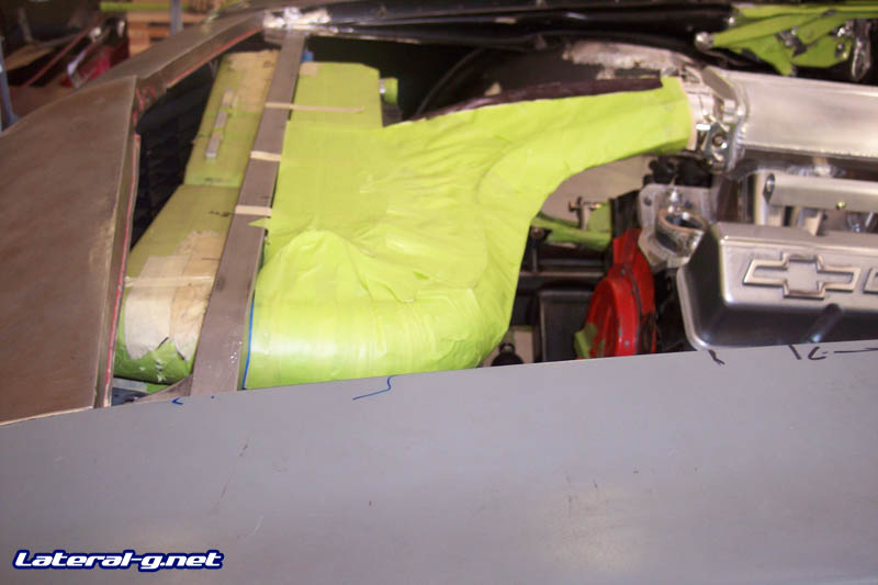

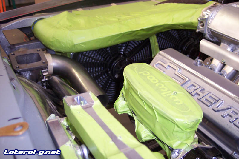

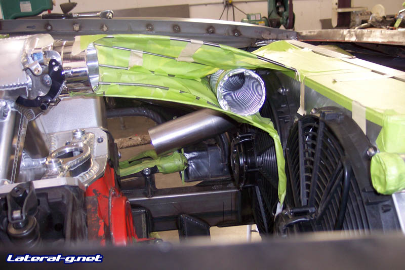

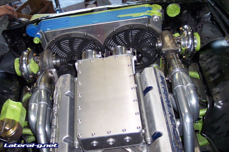

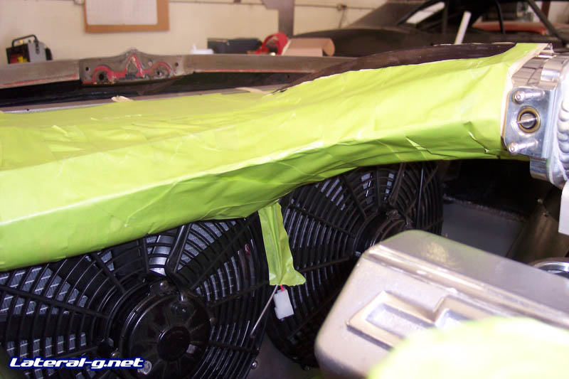

Ron Davis radiator custom size with twin 14 inch electric Spal fans and fan
shroud

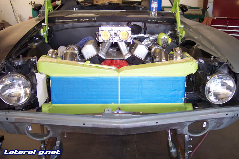

Ron Davis Intercooler
Aluminum drive line

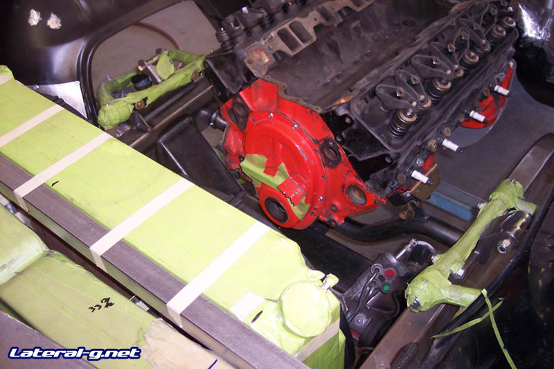

Brodix aluminum block 4.120
Oliver Billet crank 3.5"
Oliver Billet Rods 6"
Diamond pistons
Comp billet hyd. roller cam
Comp pro magnum rockers
Isky Lifters

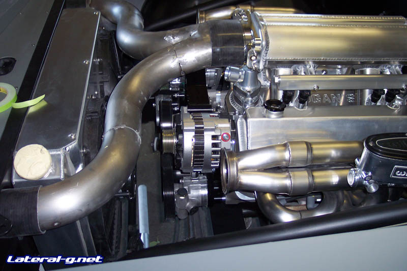

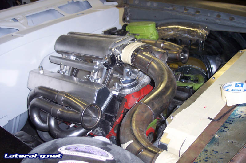

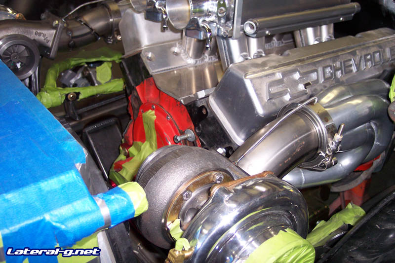

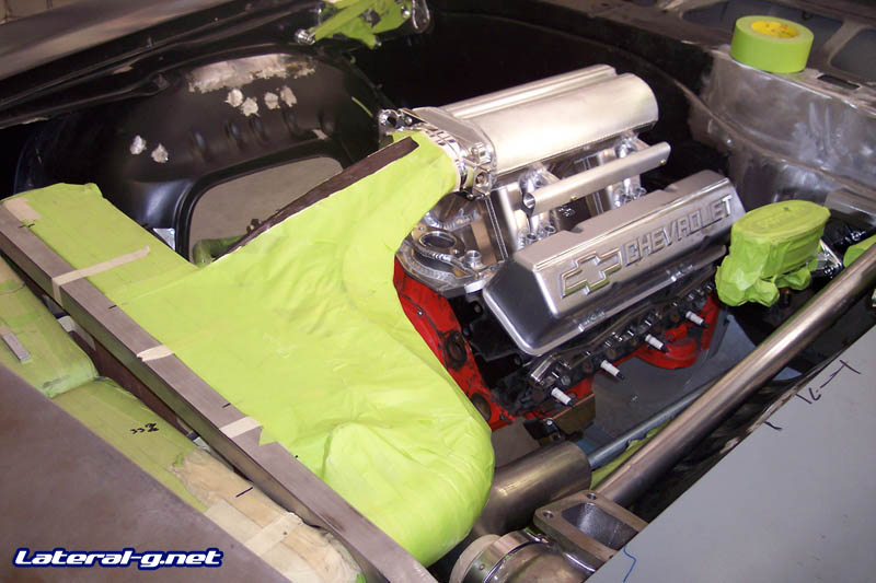

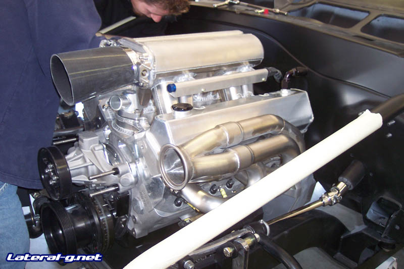

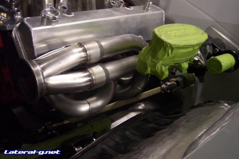

APS sheet metal valve covers

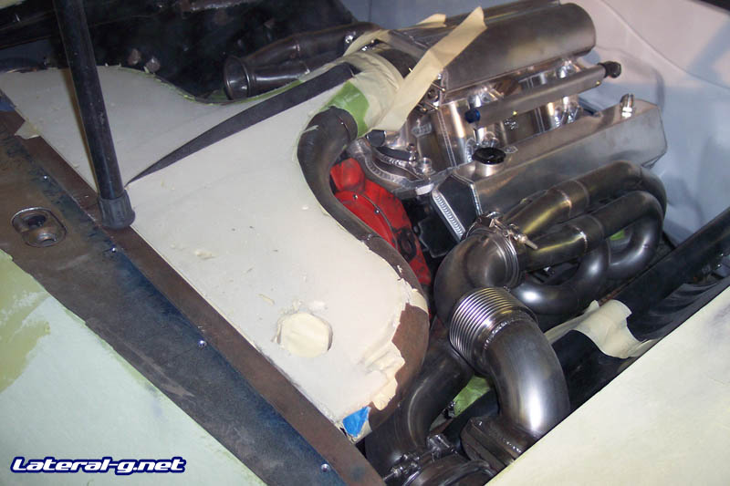

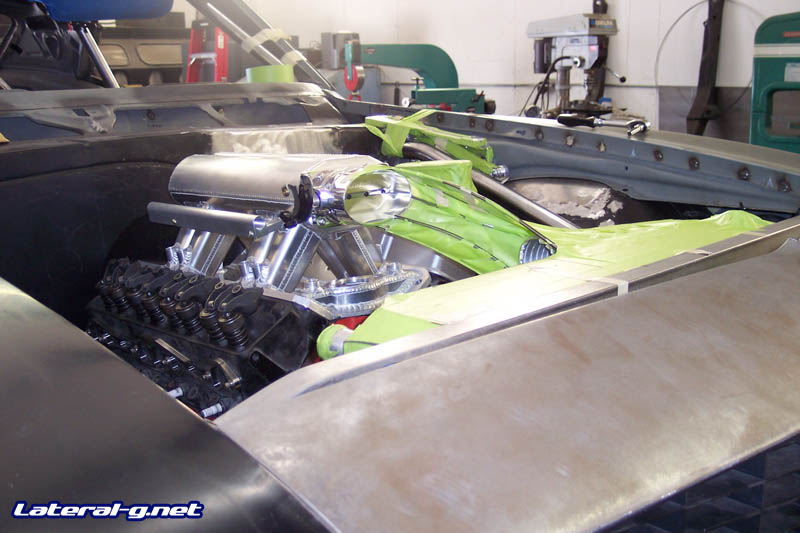

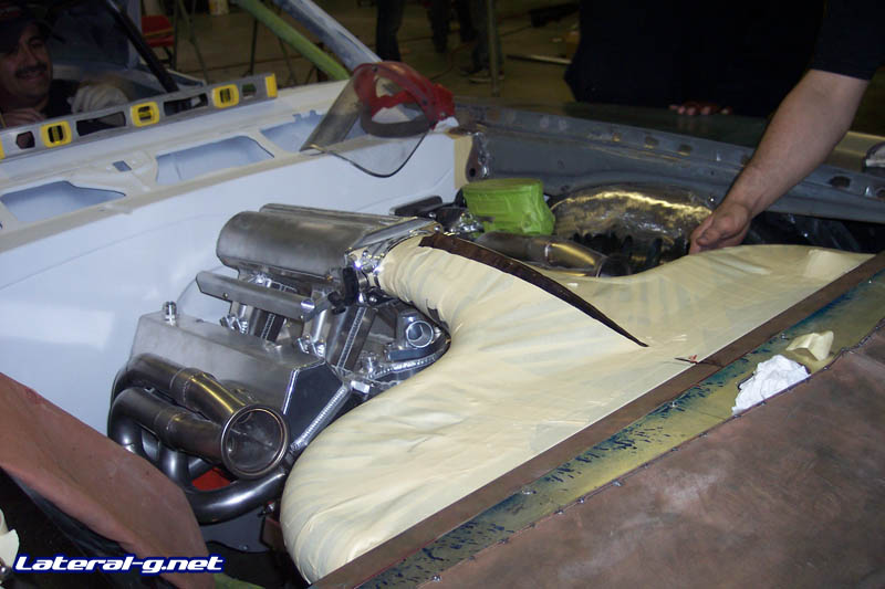

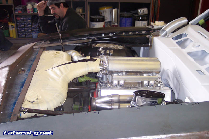

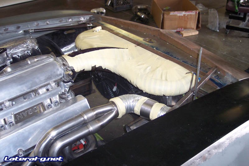

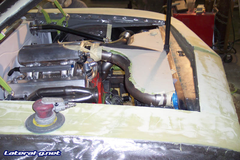

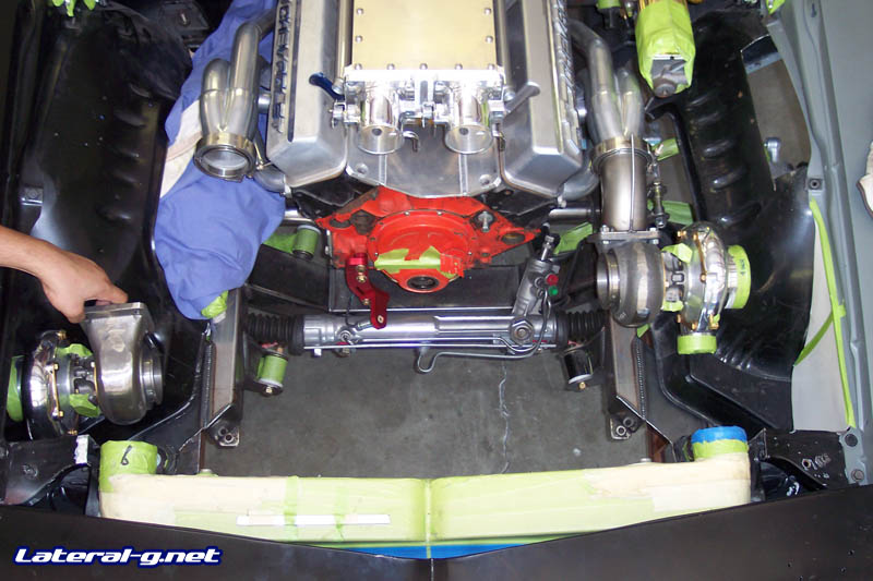

Custom Hogan Intake
MSD distributer with crank trigger

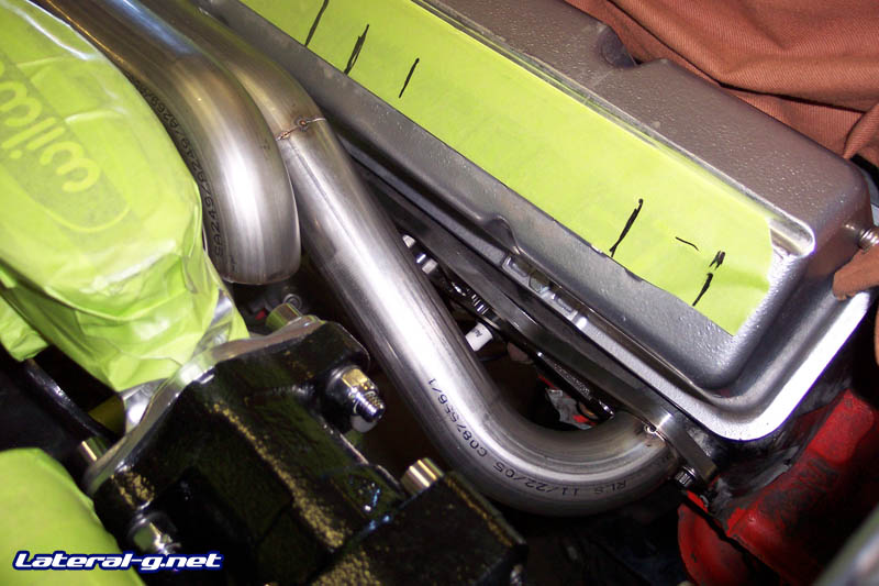

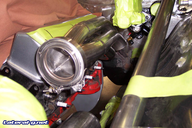

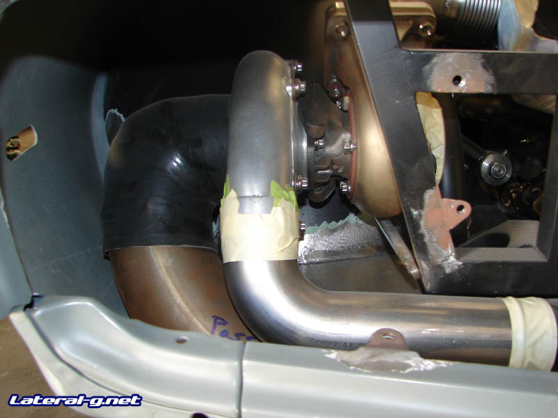

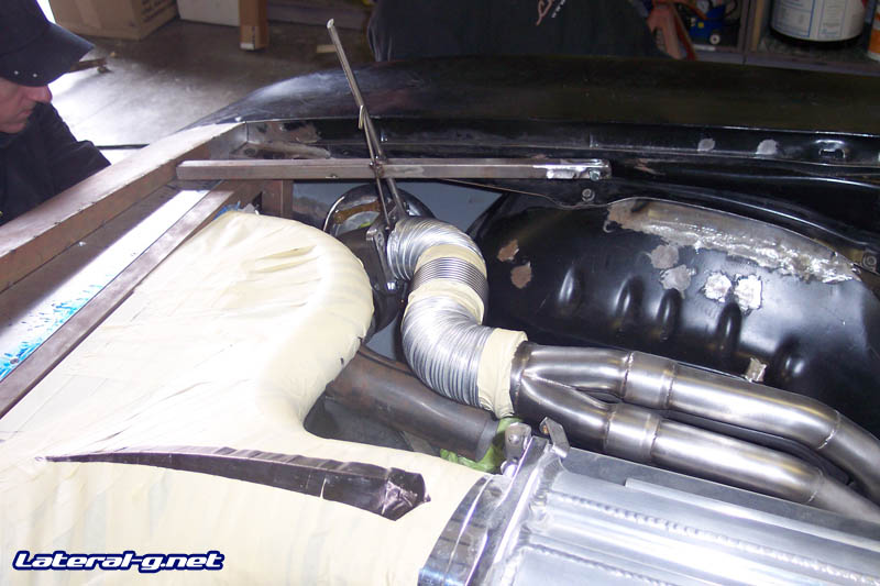

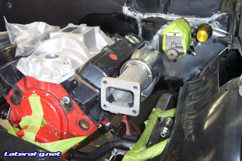

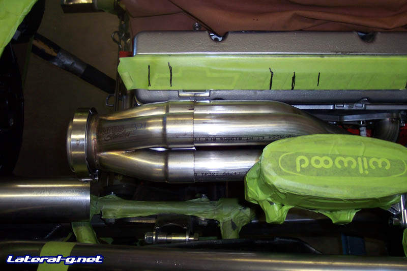

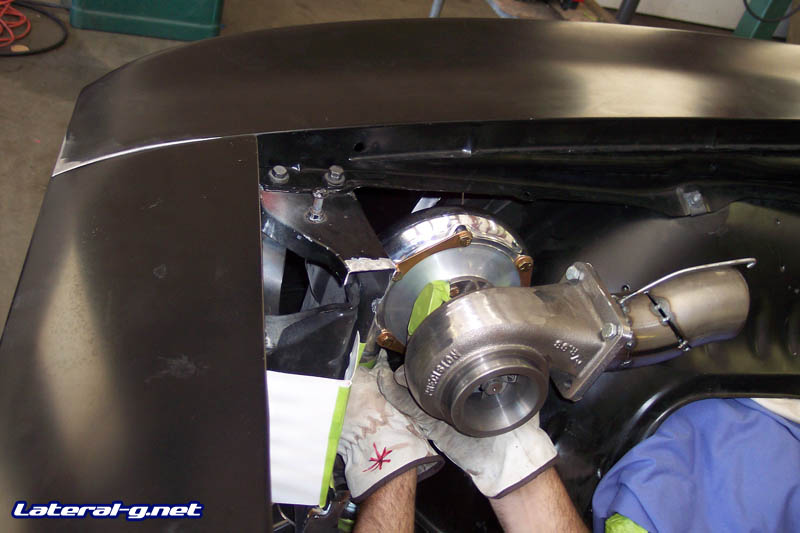

Custom Turbo headers

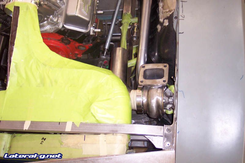

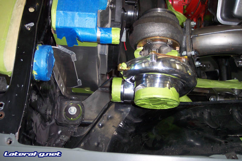

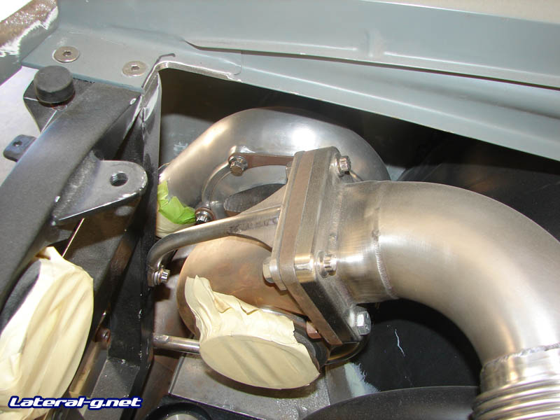

Precision 61mm turbos w/Turbo smart 44mm wastegates
BS3 EFI
