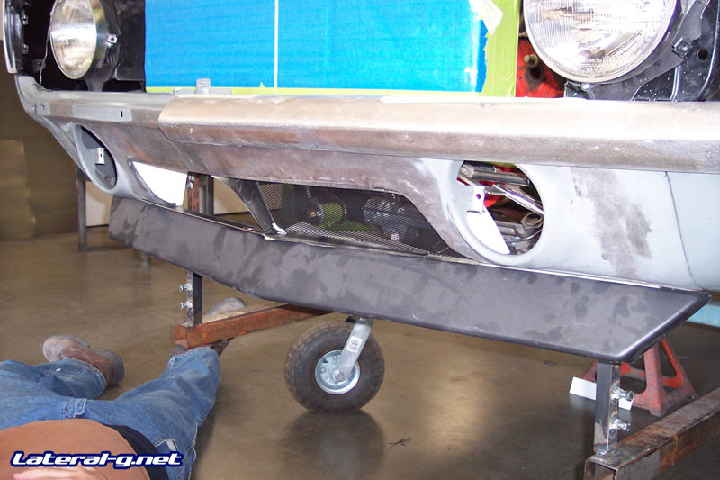

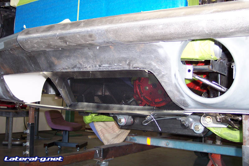

Front

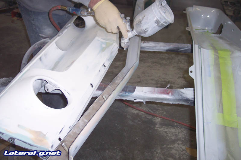

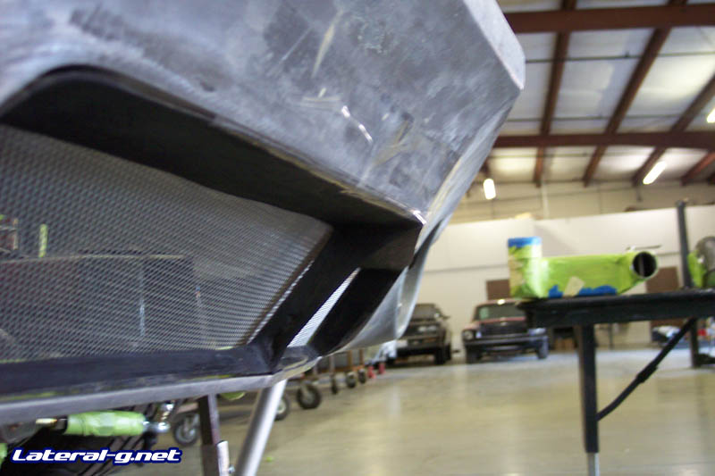

Valance

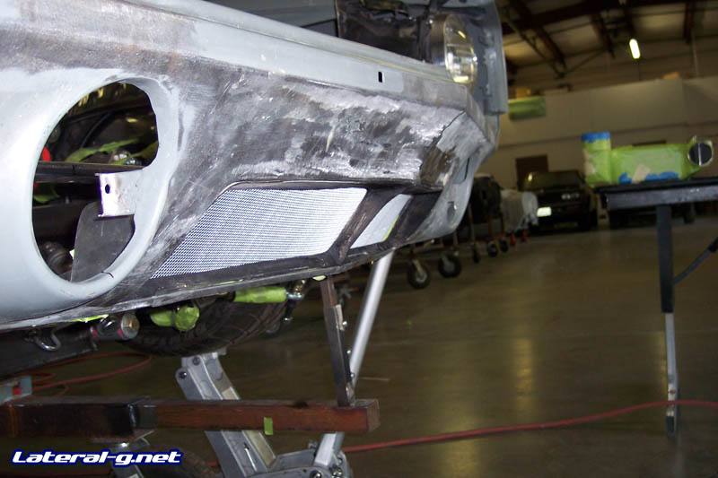

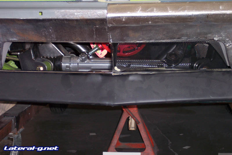

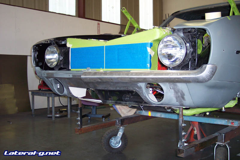

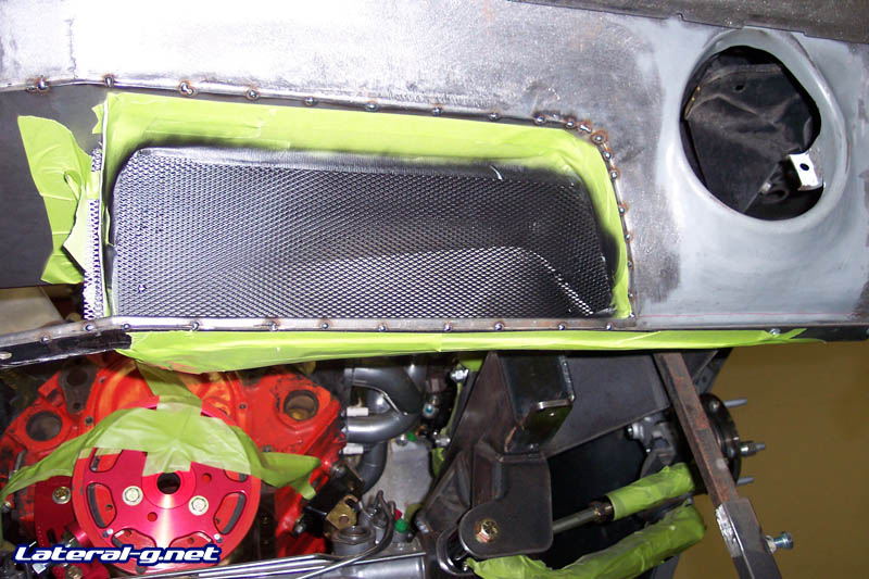

Cold air opening with 4 inch mandrel bent tubes
Remove recessed license plate on valance and match tip to front bumper
Front bumper mounting brackets and opening removed
Stainless steel mesh with trim
Moved front indicators lights six inches on each side

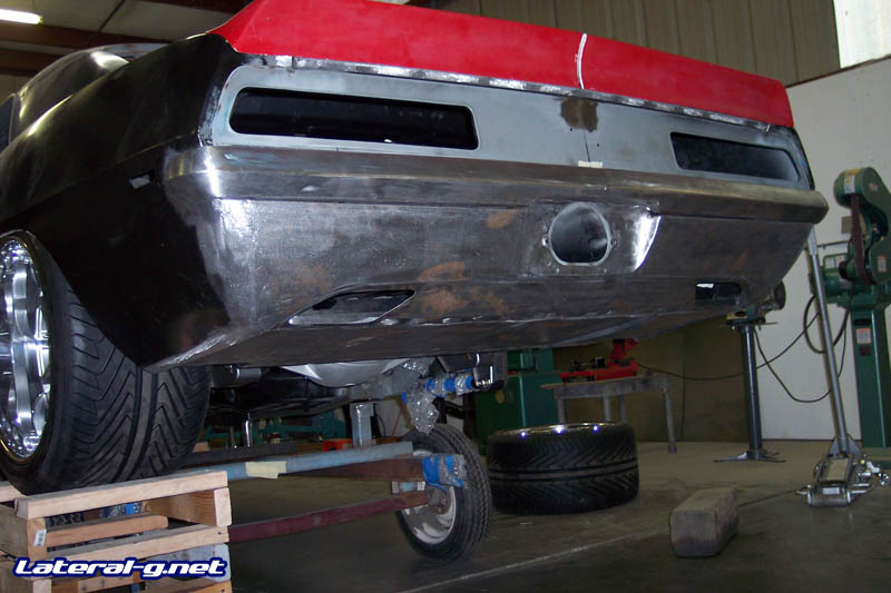

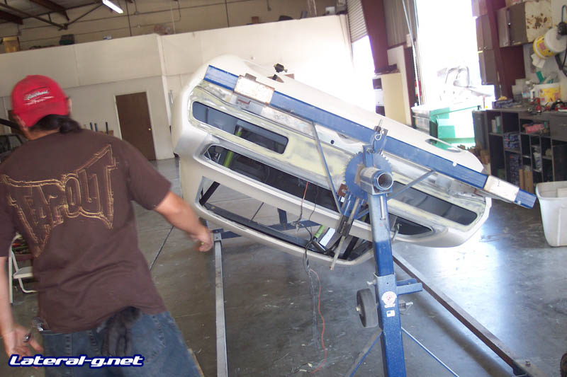

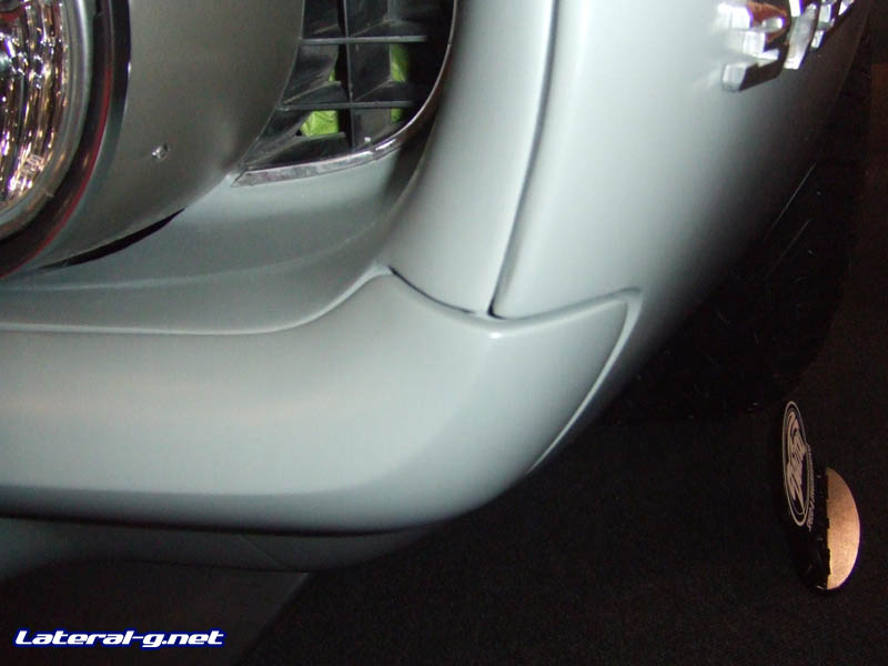

Front Bumper
Hand formed corners and license plate cut out removed
Moved in to match front fenders

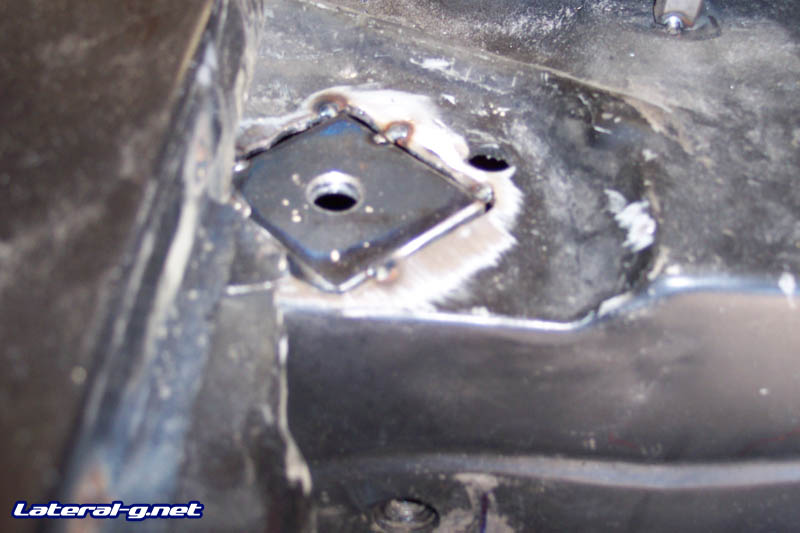

Relocated mounts to valance
Removed mounting bolts and welded studs

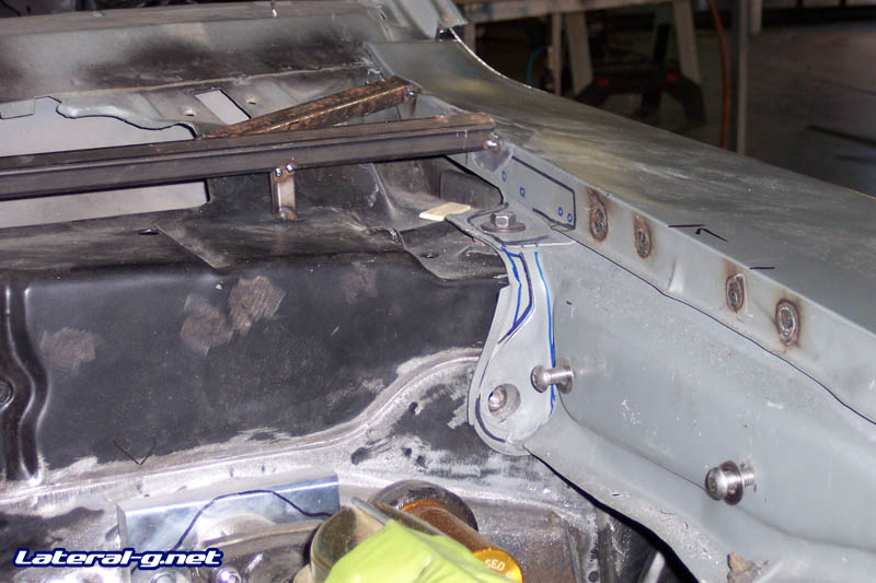

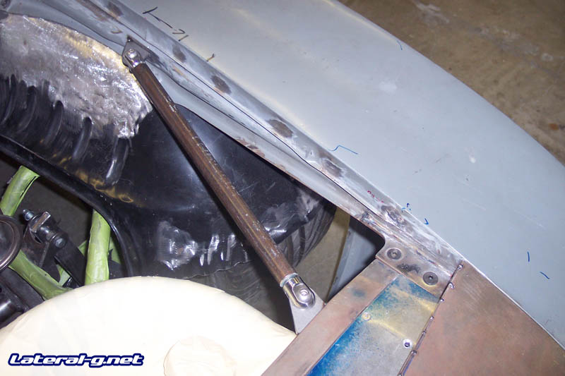

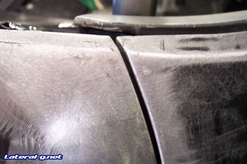

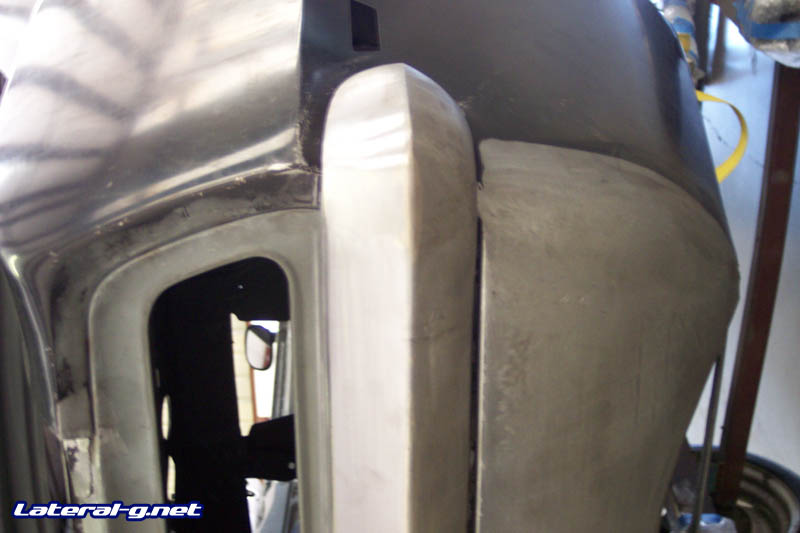

Fenders
Widen each side 3/8 of inch for tire clearance (made with two fenders)
squeezed inner lip at door to allow tighter gaps

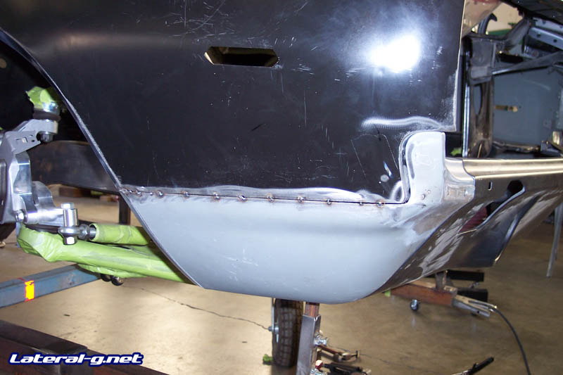

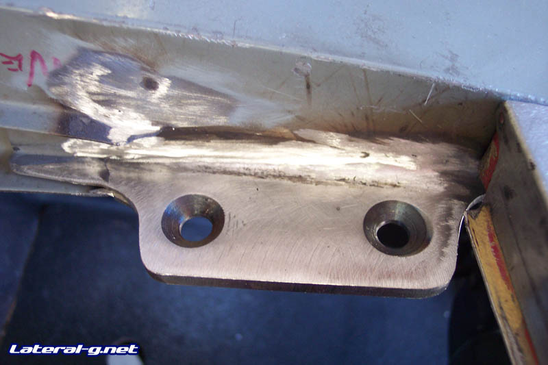

Extended fender and matched to rocker panel

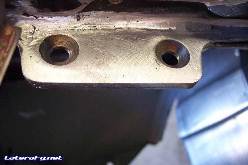

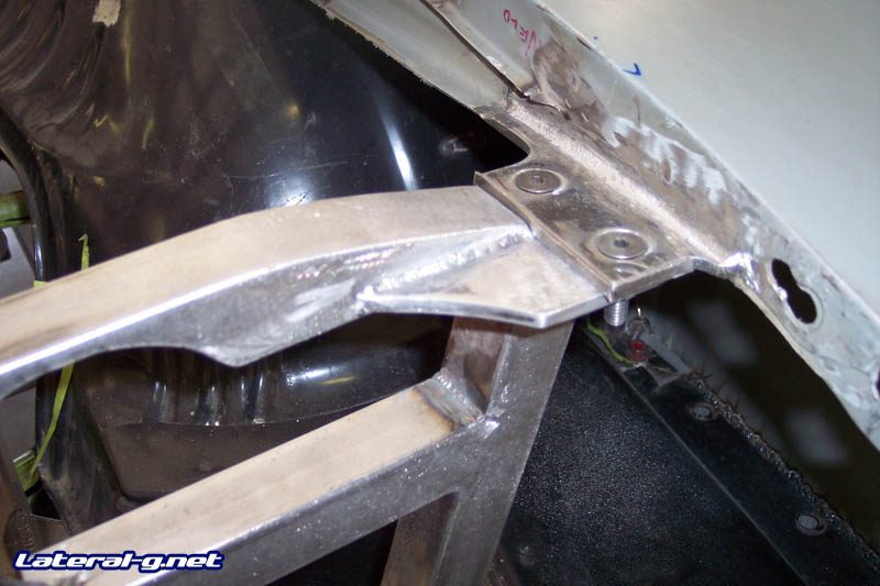

Counter sunk mounts at rocker
Counter sunk bolts for no shims at radiator support and firewall
Filled and smoothed all spot-welds
Drilled spot welds and matched profile to hood then re-weld
Ground and smoothed all edges for consistency
Weld fender extensions to fenders

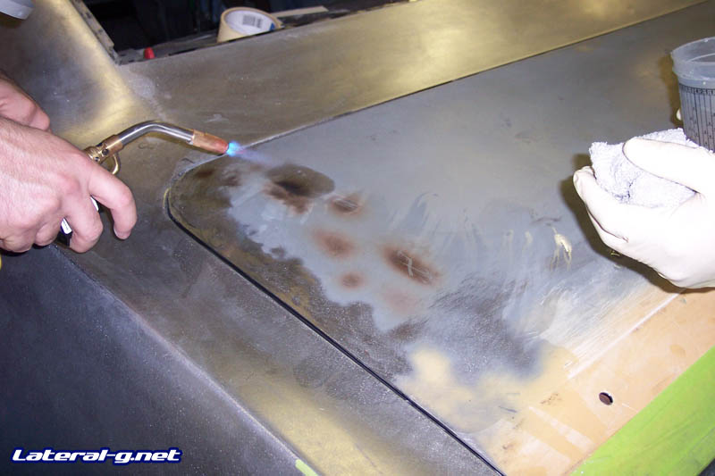

Matched to fender with heat

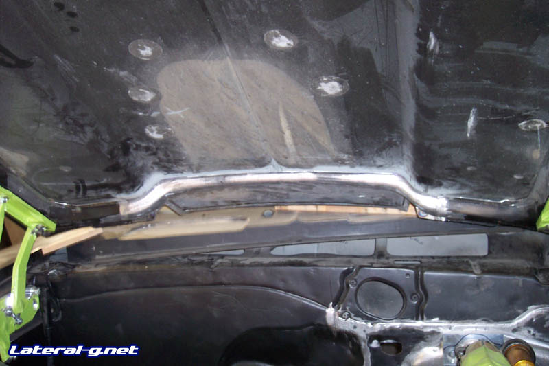

Hood
Remove inner structure and replaced with smooth structure
Weld all holes and fill all openings
Epoxy structure to hood and smooth edges
Remake inner structure to match cowl profile

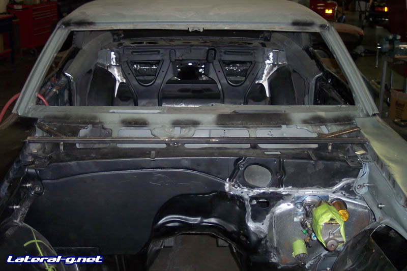

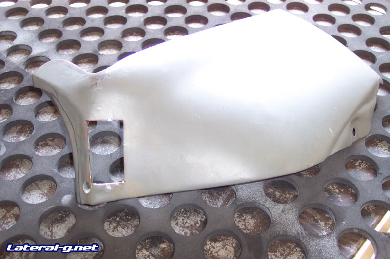

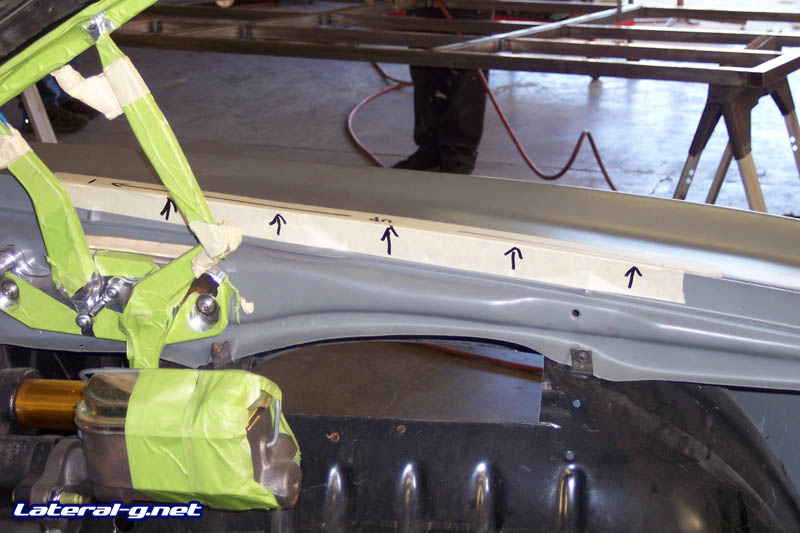

Cowl panel
Fill air vents/grill
Weld all mounting holes and drill new mounting points
Extend to fit tighter on fenders

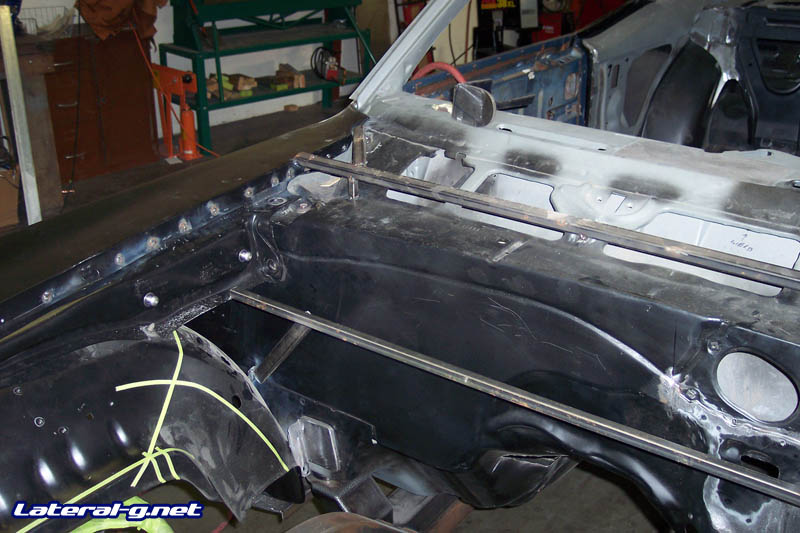

Mount braces to keep consistent at windshield
Extend to match firewall gap at each corner

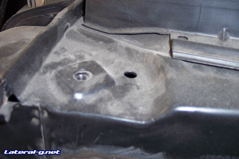

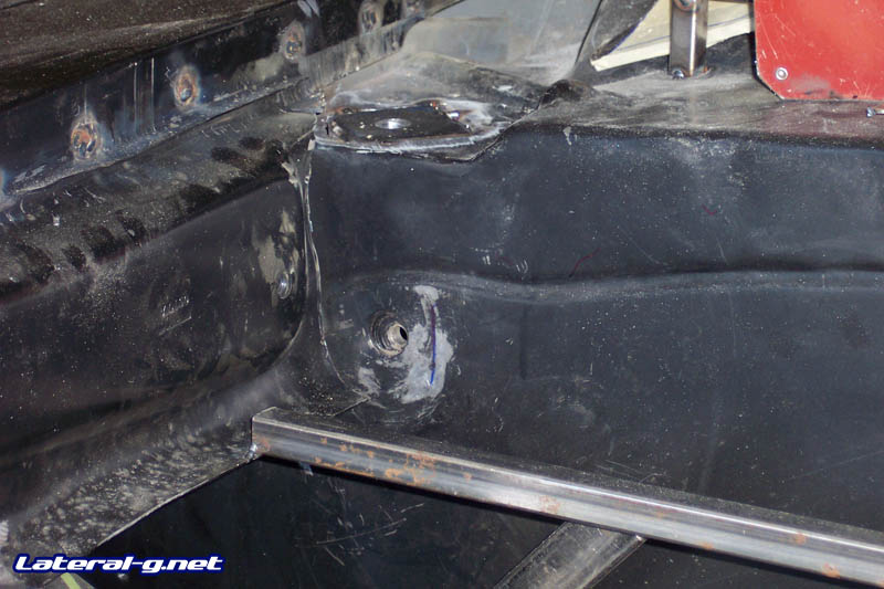

Firewall
DSE firewall fill plate
Extend the firewall fill plate to left side
Remove wiper hole
Fill all dimples and holes

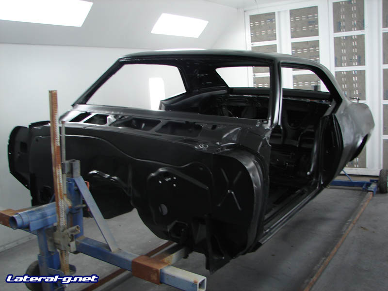

Covers for body to sub frame mounts
Factory steering column brace removed
Relocated wiper motor under left fender

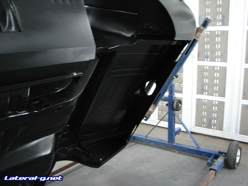

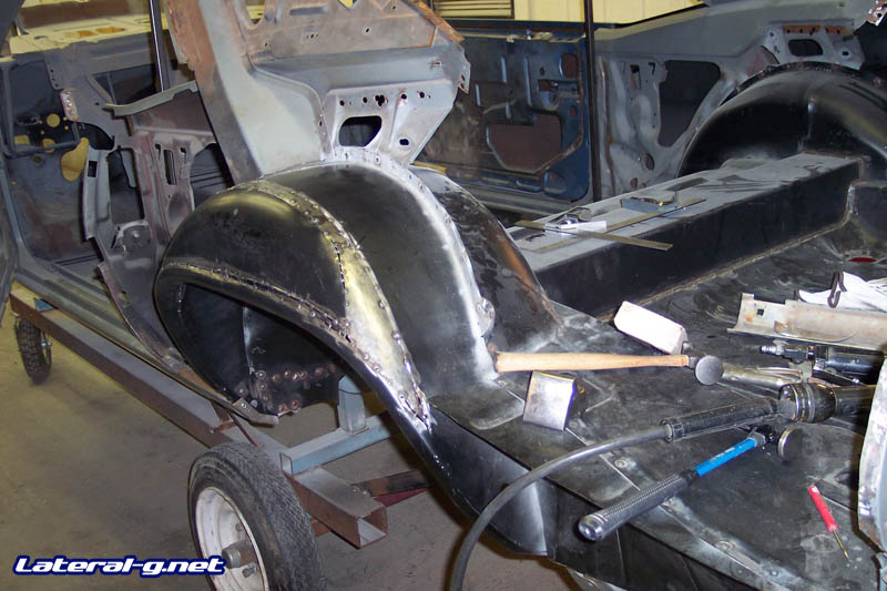

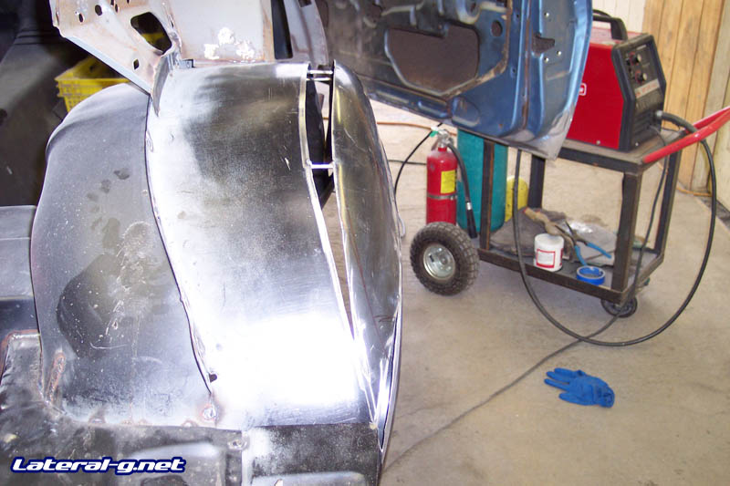

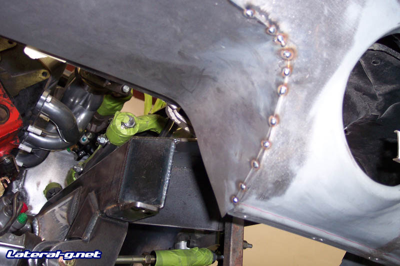

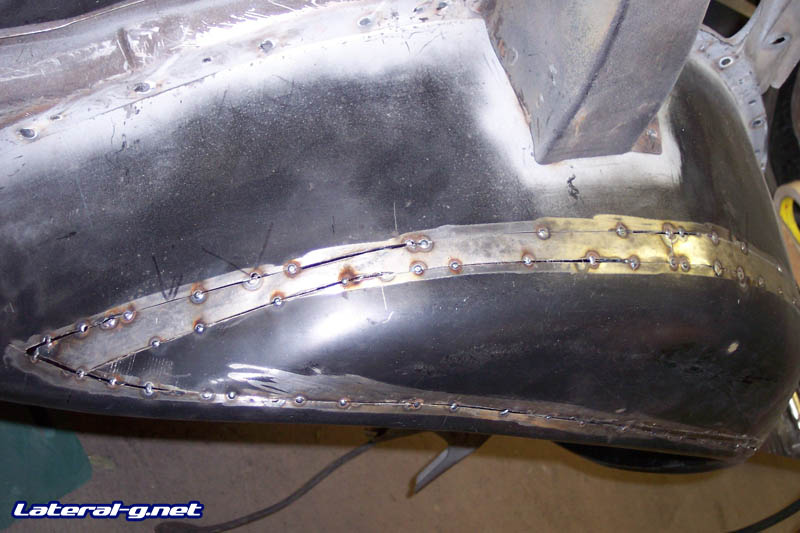

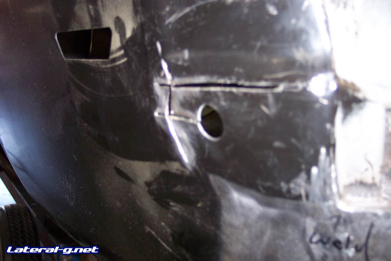

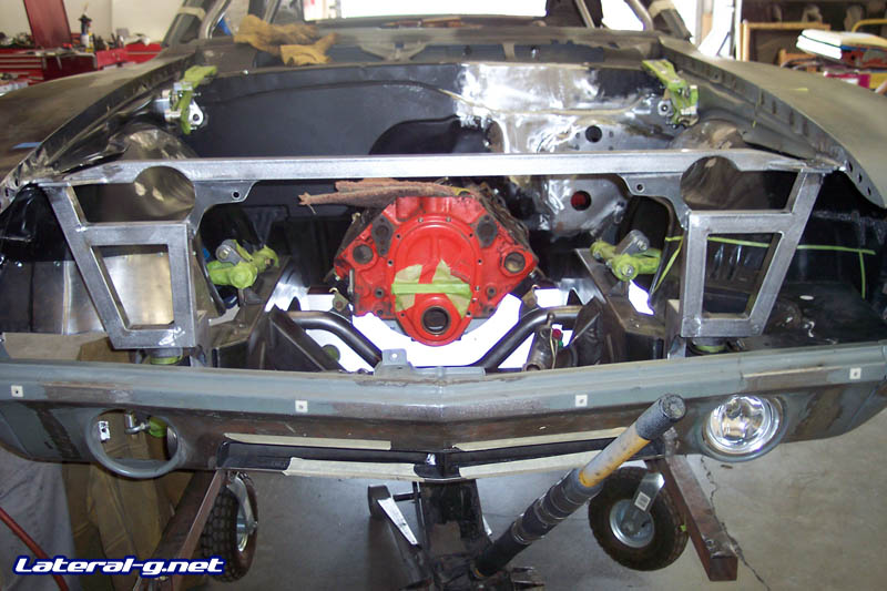

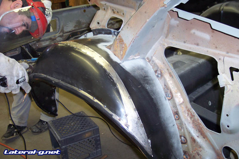

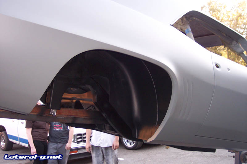

Front inner wheel wells
Mini-tub wheel wells for larger tires and suspension travel
Raise inner fender and remove flat spot by fender
Weld and relocate mounting holes

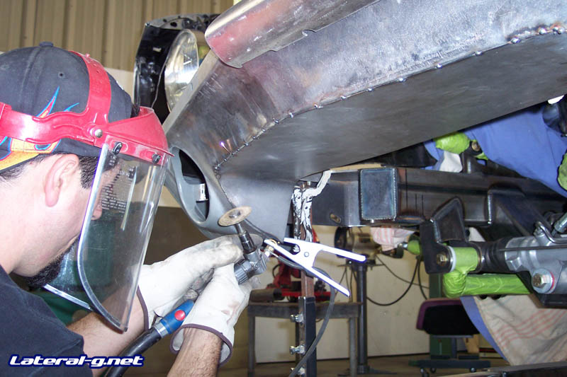

Modify front extensions to allow for turbo clearance and extend to match
relocated frame rails
Smooth braces from firewall

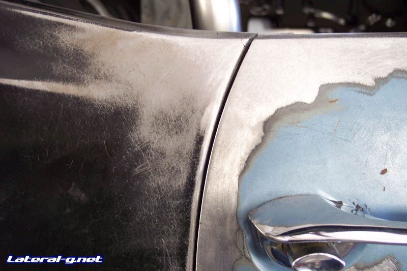

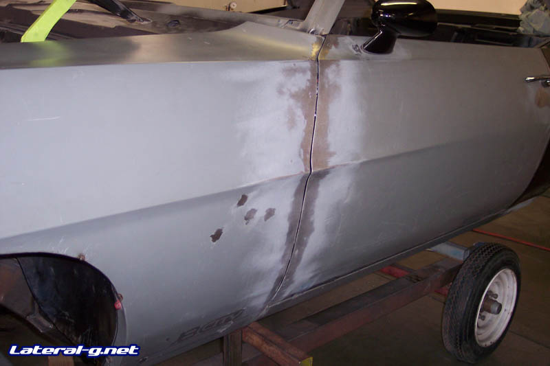

Doors
Hammer and dolly all sheet metal edges to match other panels
Weld edges for gap consistency
Fill door locks

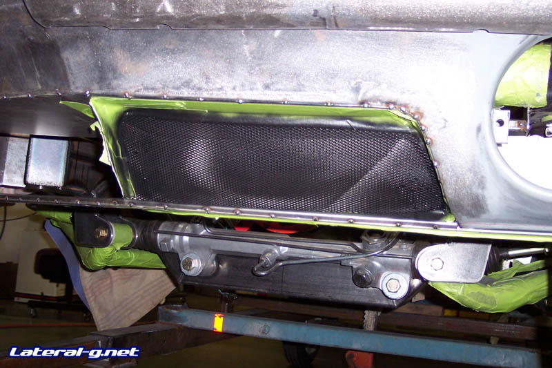

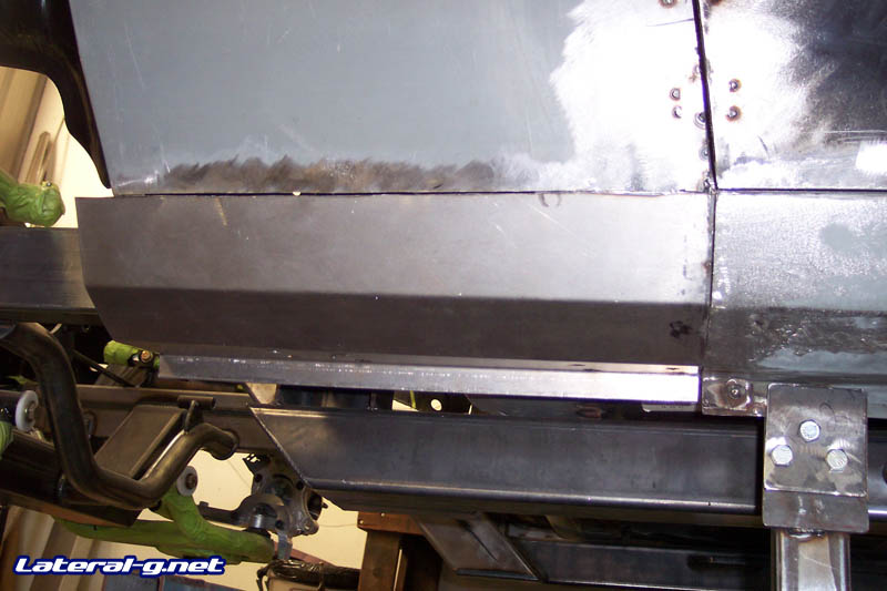

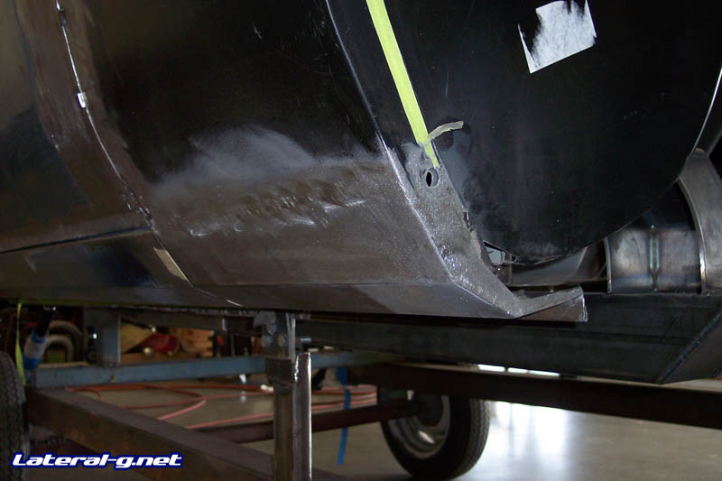

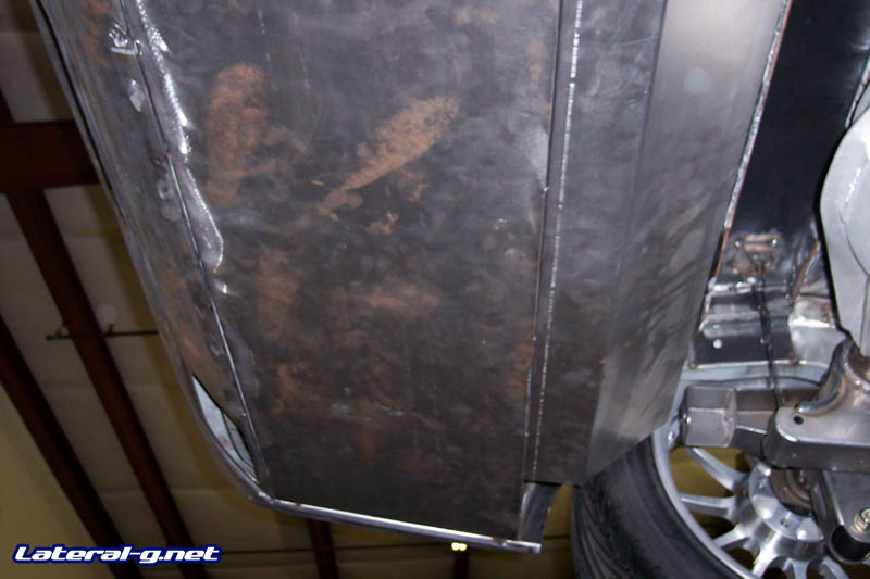

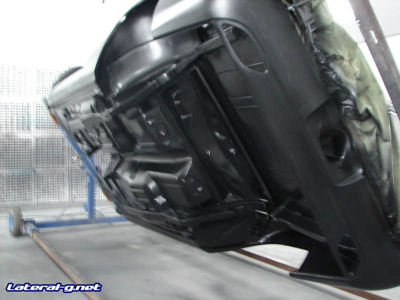

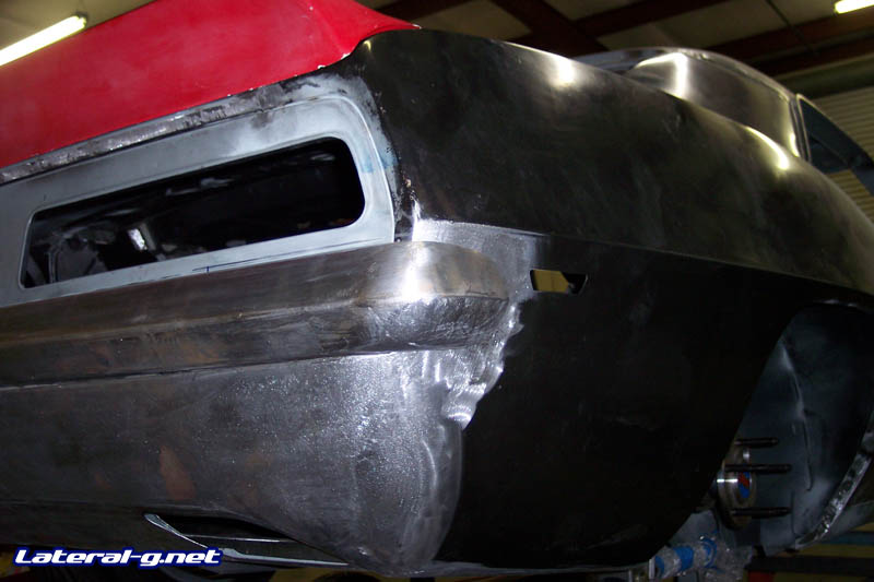

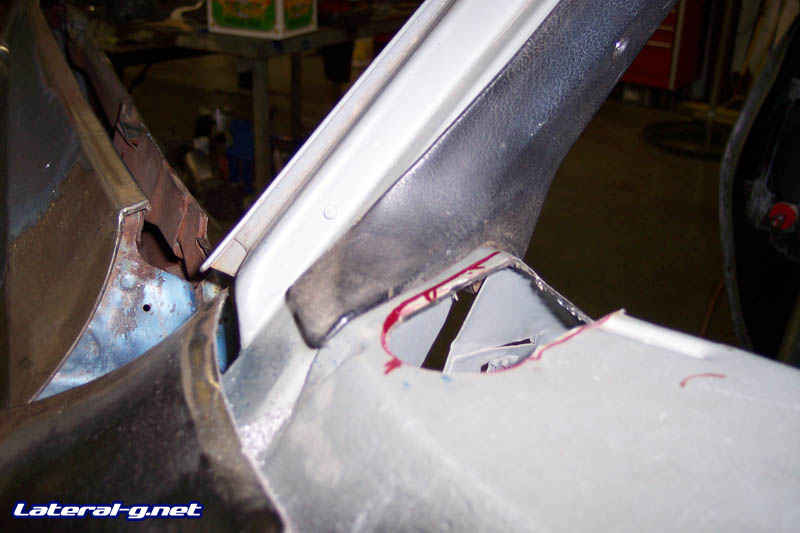

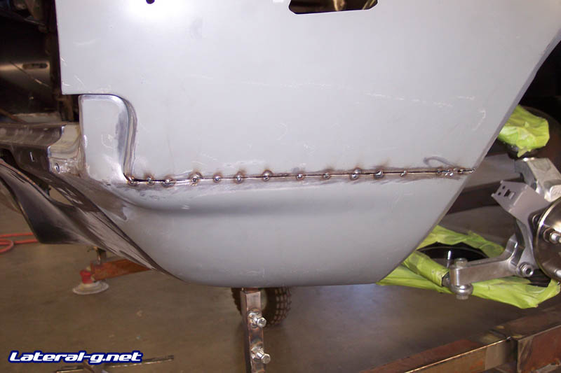

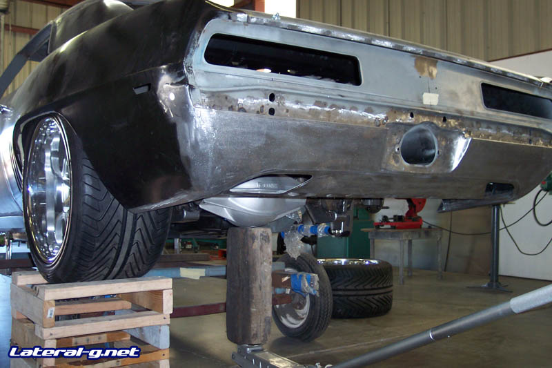

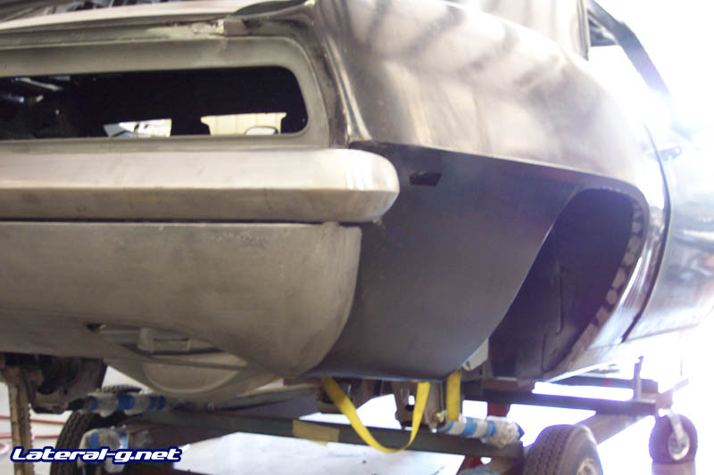

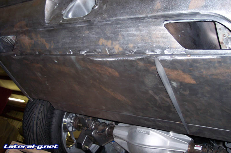

Quarter panels
Remove lower pinch welds and make new edges to match new rear panel
Remove extruded sheet metal for bumper and make smooth
Cut and �box� lip at inner wheel well for tire clearance

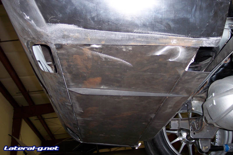

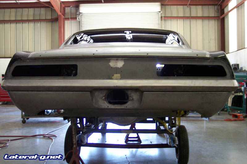

Bottom rear panel cover with billet aluminum diffusers

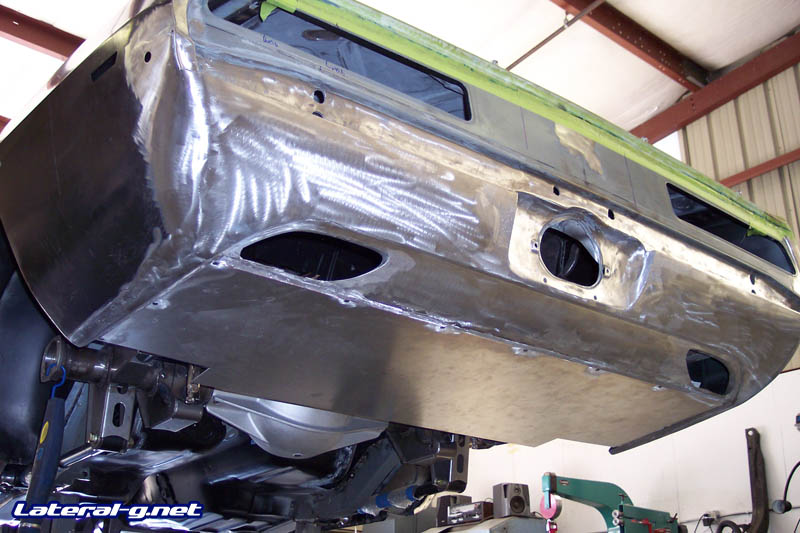

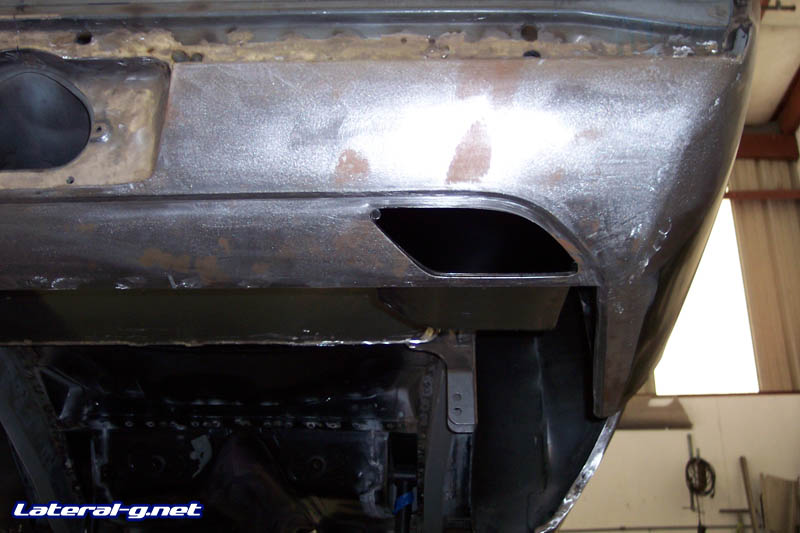

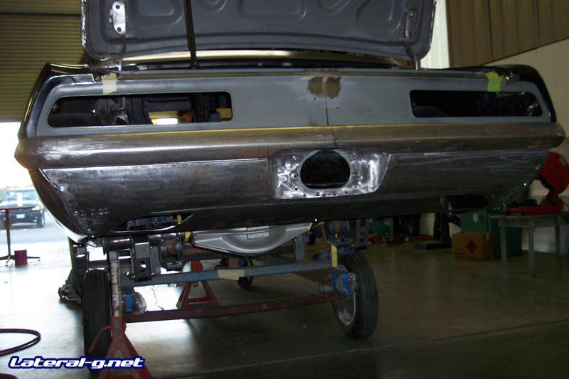

Rear panel
Handmade lower panel with step made and pinch weld removed
Exhaust cut outs
License plate opening narrowed
Gap at bumper removed
Trunk lock removed

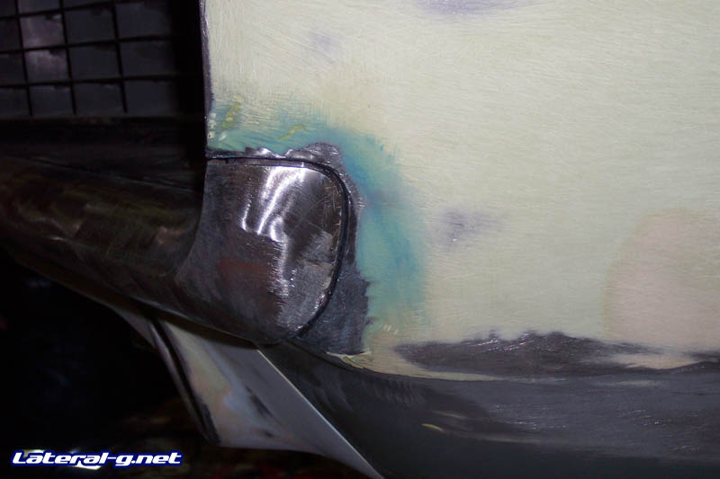

Rear bumper
Hand made corners
License plate opening narrowed 2 � inches
Holes filled and new brackets welded with studs
Gap to body reduced
Show chrome plated by Sherms

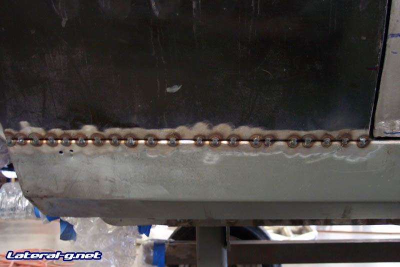

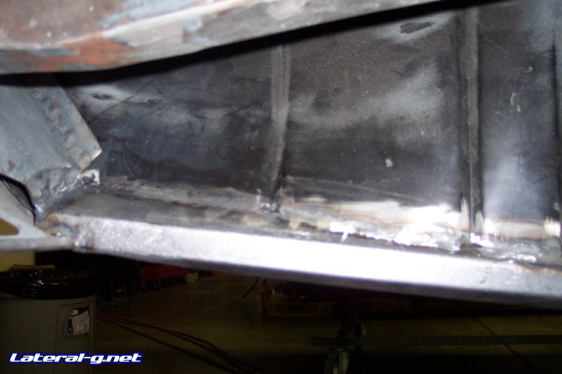

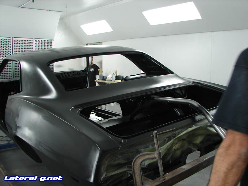

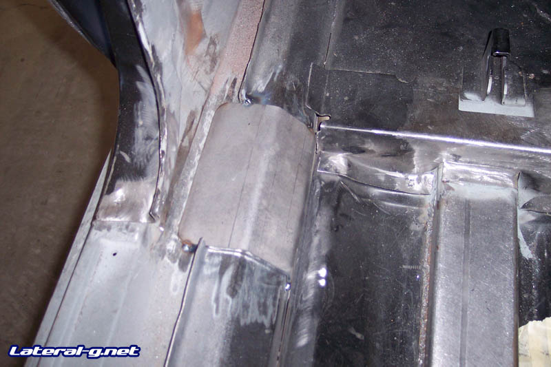

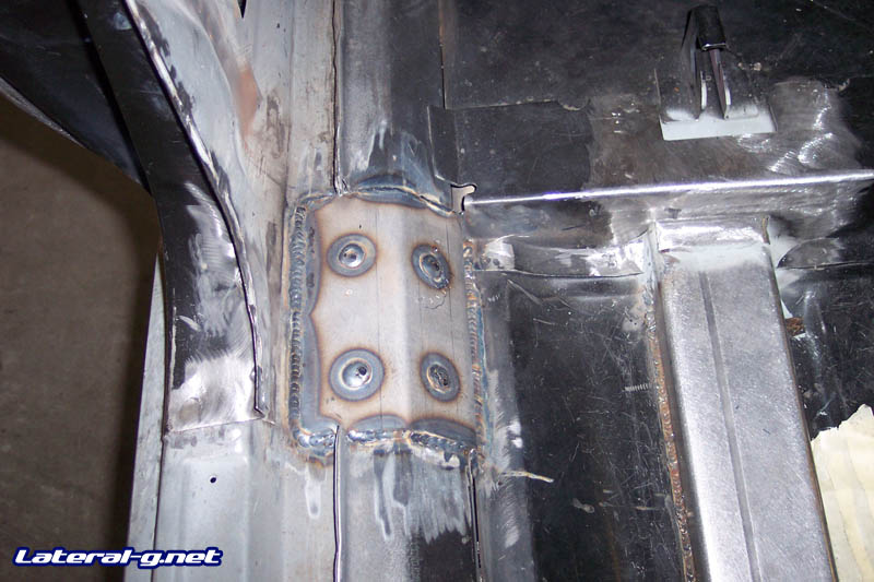

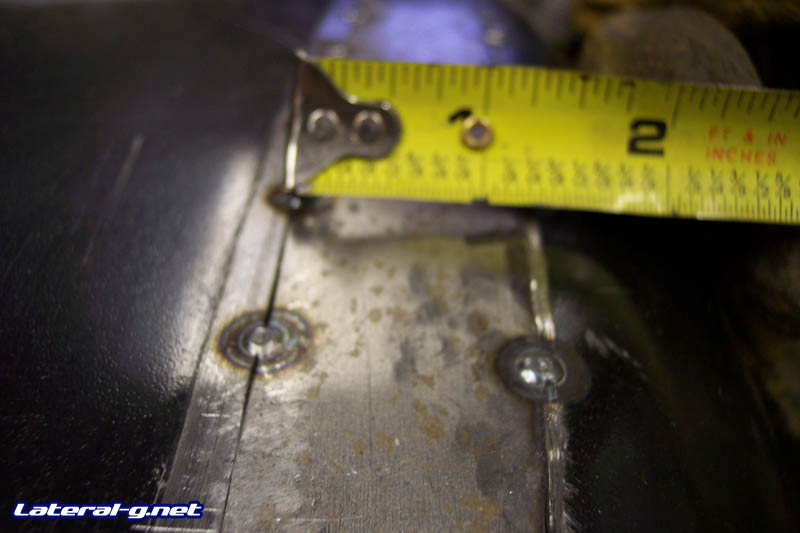

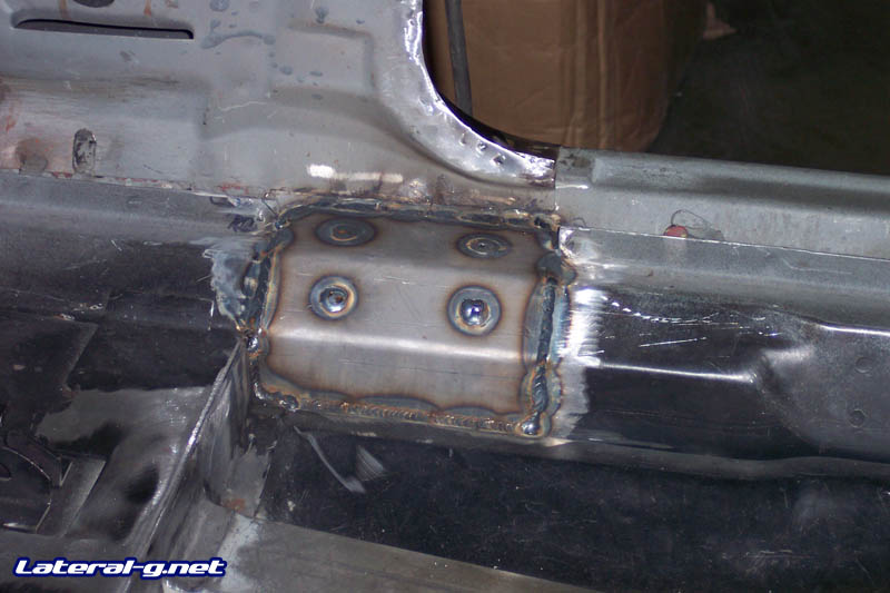

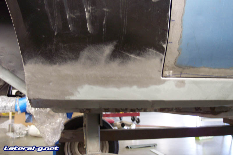

Seams and gaps

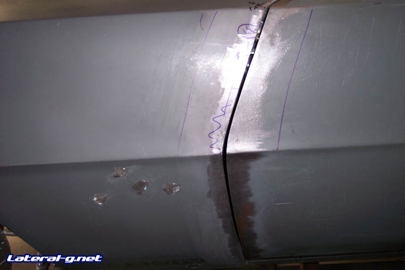

Welded quarter to rocker, quarter to rear panel and rear window panel to
quarters
Drip rails welded and smoothed for paint
Rocker pinch welds hammer and dolly straight and ground for consistency

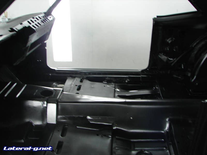

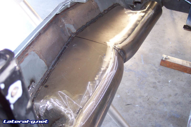

Trunk
Raised 2 � inches
New center section made
Covers for bumper bolts

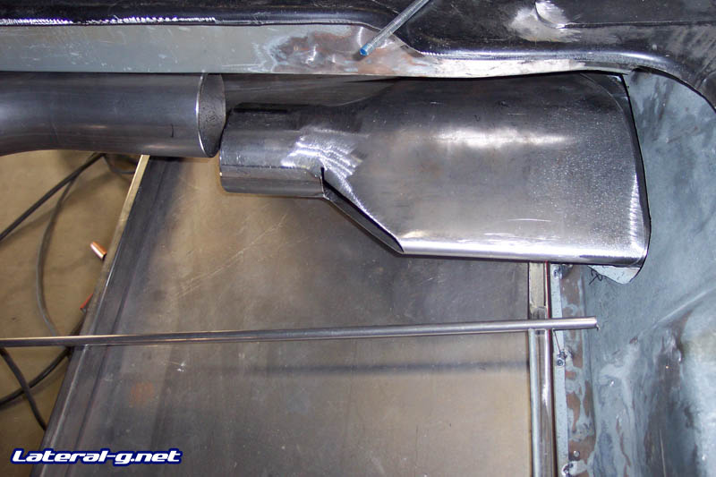

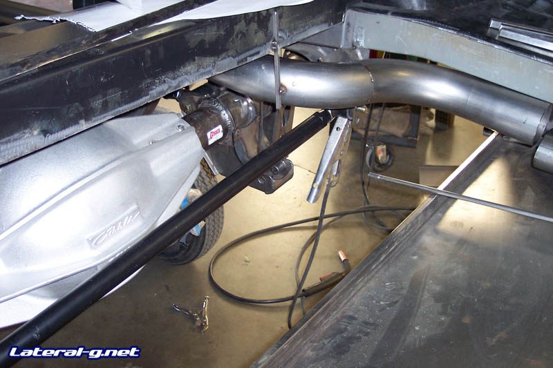

Exhaust
341 stainless headers with Lateral Dynamics flanges
304 stainless exhaust with inconel expansion/ flex
Headers made by Kerts Fabrication
3-inch exhaust with hand made rear tips

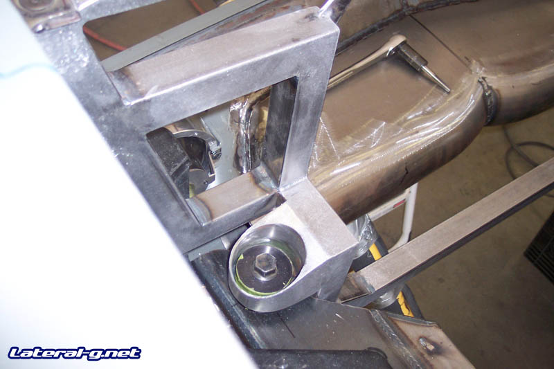

Radiator support
Hand made from square tubing and moved forward � inch
Boxed mounts
Hood latch mounts and supports handmade
Hood bump stops hand made

Marquez design prototype fender to radiator support bars
