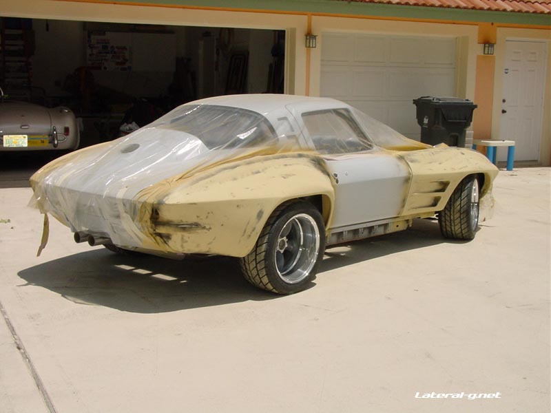

ROARVETTE
IDEA:
The concept of building this car came from trying to blend a Porsche 996 and
a 427 Cobra. While the Porsche is a great car, it doesn�t have the attitude. The
Cobra with its side pipes and 500HP 427 side-oiler has attitude but not even a
roof.
After driving 300 miles in pouring rain during the Texas 1000 Vintage Rally
in the Cobra it was clear something else was needed.
Thus came the idea of the Roarvette.
Things it had to have:
- More power than the Cobra, 500 HP minimum.
- Good mileage on pump gas. Cobra 6MPG plus octane booster, Roarvette
better.
- Great brakes. Hard to beat the Porsche binders but still a goal.
- Roof and AC.
- Outrageous handling and real street toughness, potholes bumps and all.
- You should hear it, way before you see it.

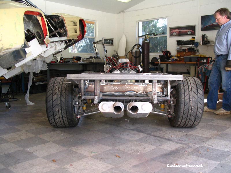

CONSTRUCTION PHILOSOPHY:
We didn�t want a show car. The car is what it is. Yes it will be shinny, and
look nice, but no mirrored firewalls, neon or video screens�

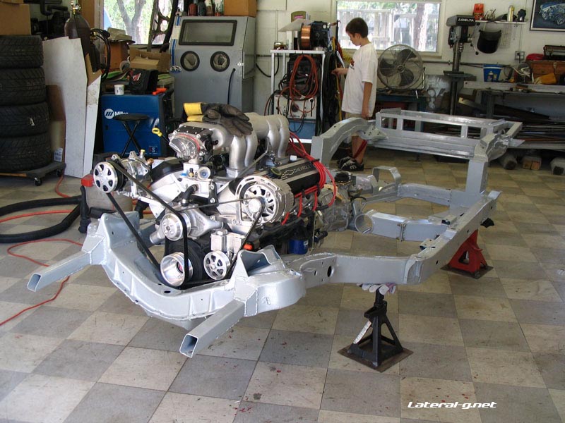

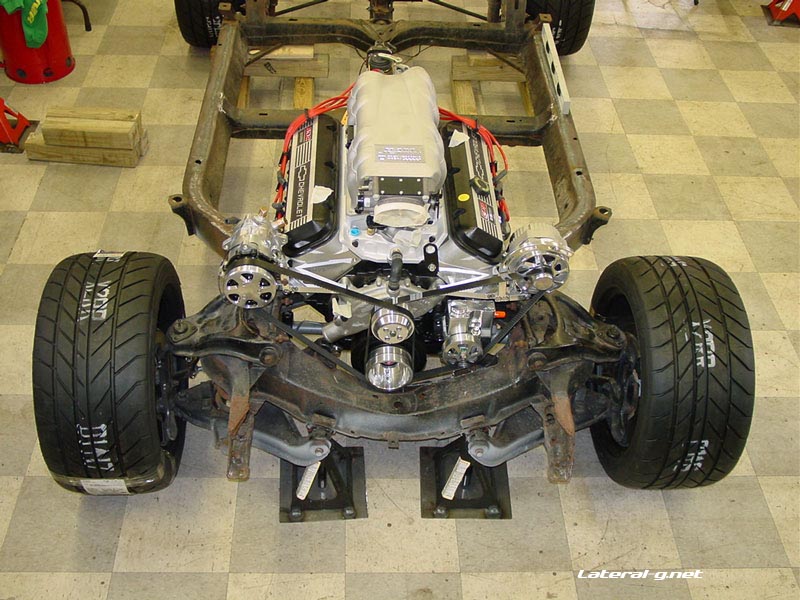

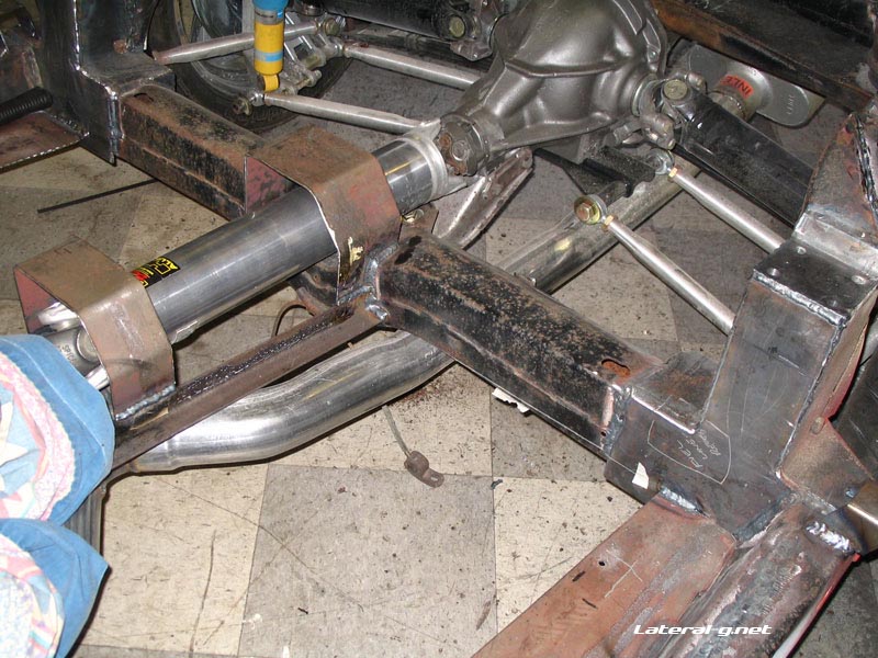

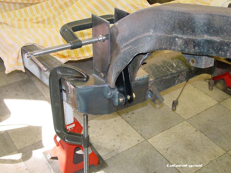

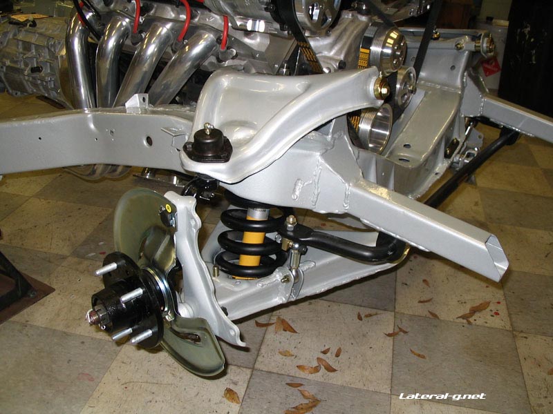

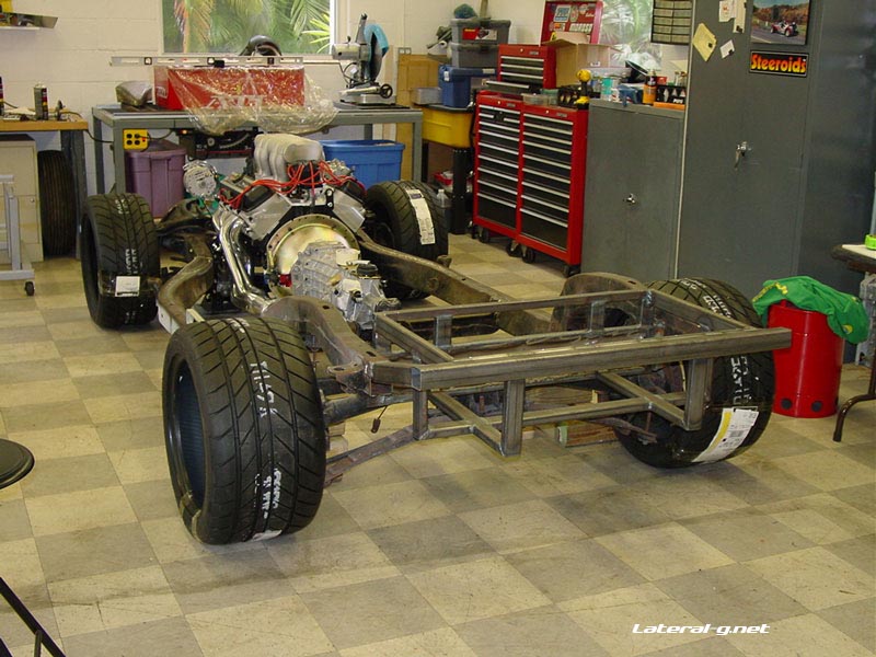

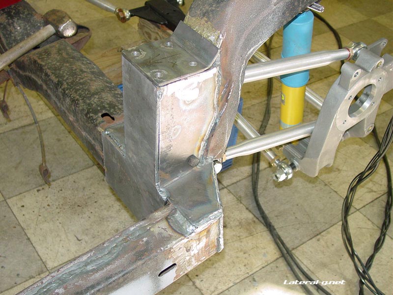

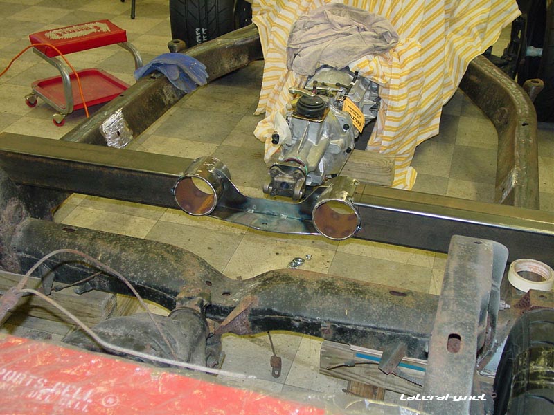

Make the car reliable and strong. The frame is reinforced in every key area.
The suspension mounting points are all strengthened. The 750 in. lbs. Front
springs with adjustable lower A-Arm mounts for setting ride height are what I�m

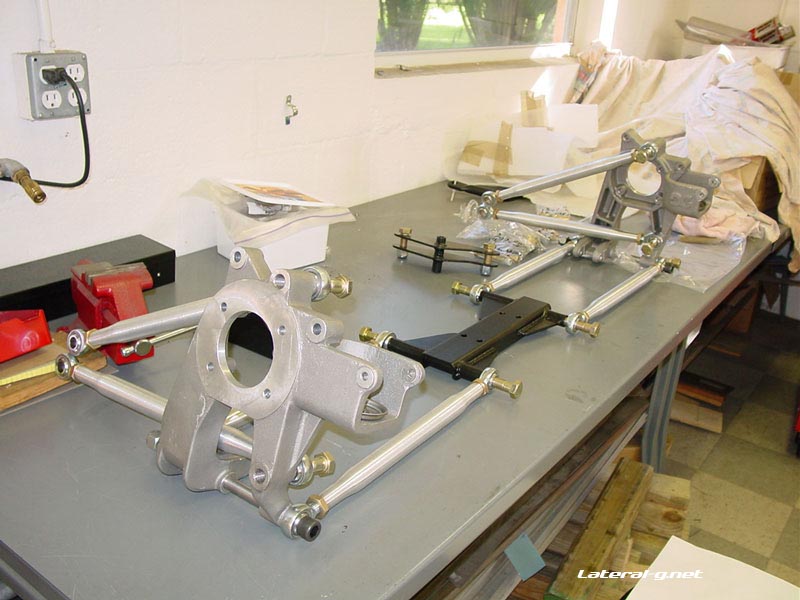

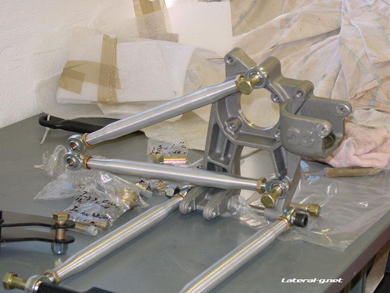

talking about. Solid bushings in the suspension, heim joint adjustable rear

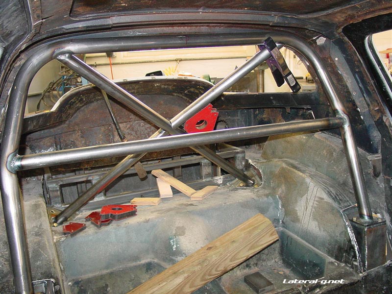

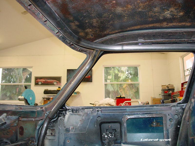

suspension, large brakes, aluminum drive shaft, full roll cage and 5-point

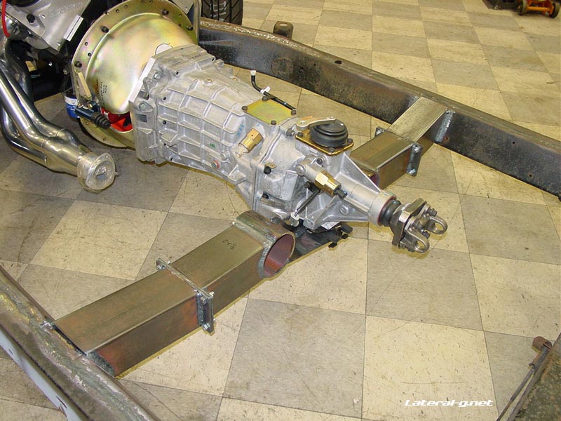

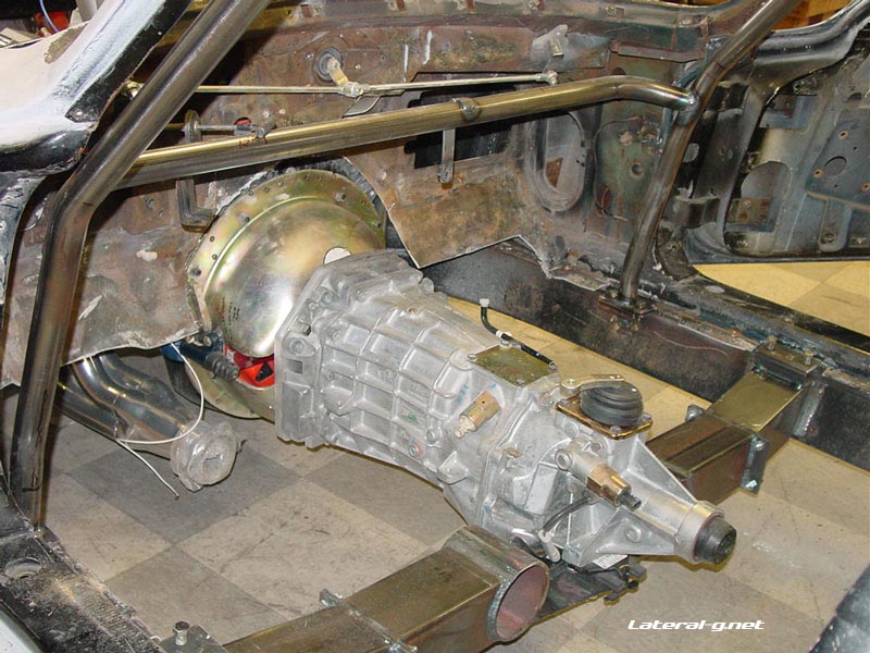

harness give the right feel to the car. The drive-train should be bullet proof
and be capable of being driven across country after doing a couple of long
burnouts.

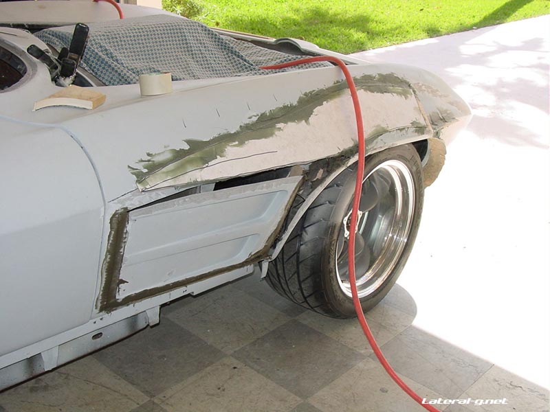

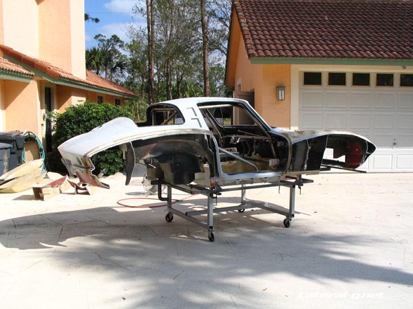

AESTHETICS and COSMETICS:

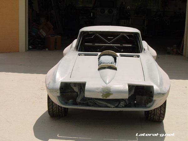

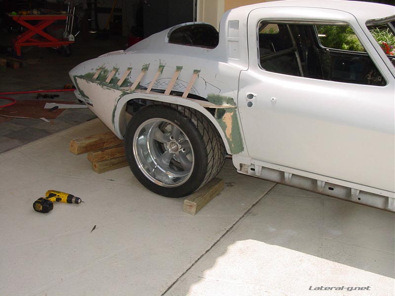

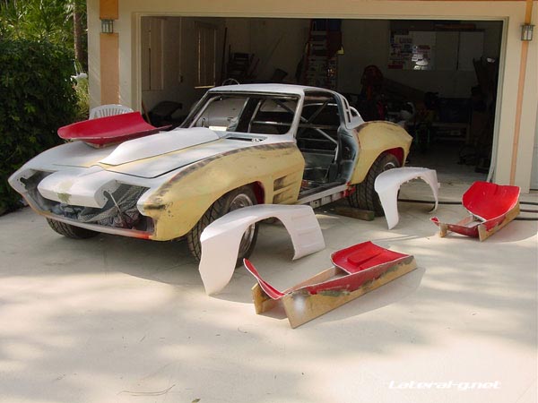

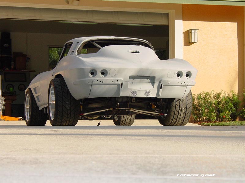

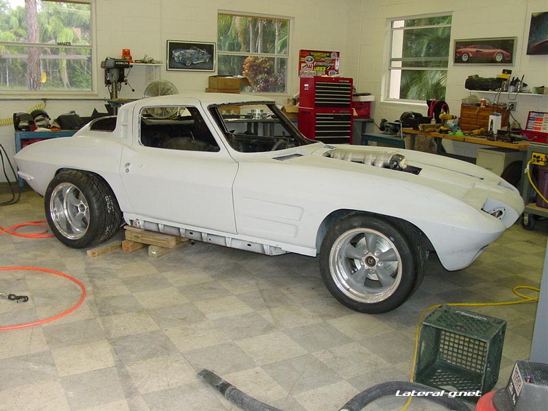

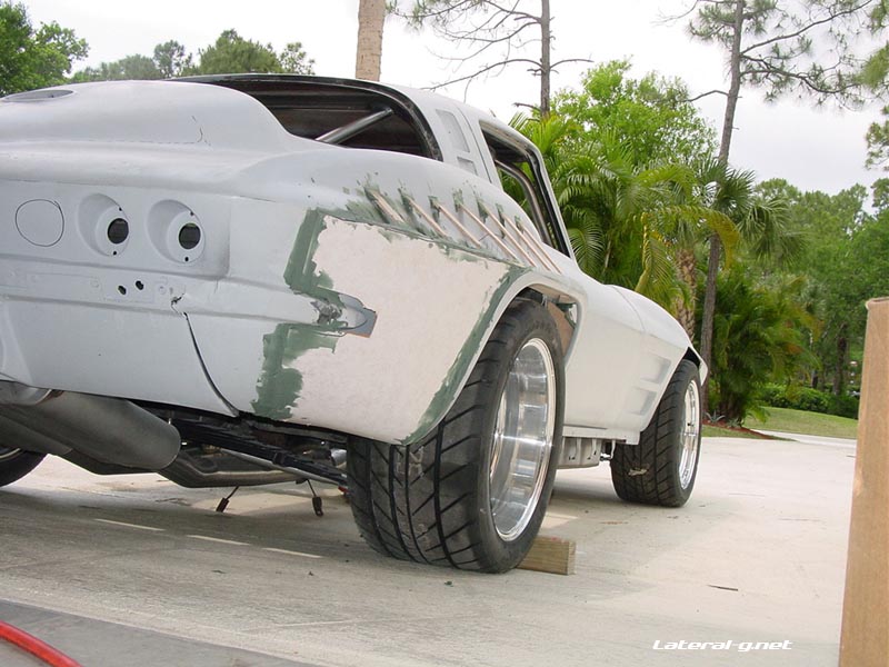

The car was envisioned to look like a 64 Vette coupe, that had spent a couple
of years at the gym pumping iron. The bodylines are as close to stock as you can
get and still fit the tires and fuel injection system.
SPECIFICATIONS:
- 1964 Corvette Coupe
- 1967 Corvette Chassis

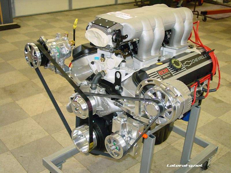

- Ram Jet 502 Crate Engine

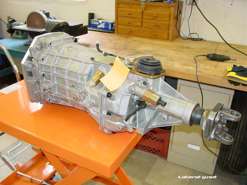

- Tremec Viper 6-SP Transmission
- Guldstrand 5 link rear suspension

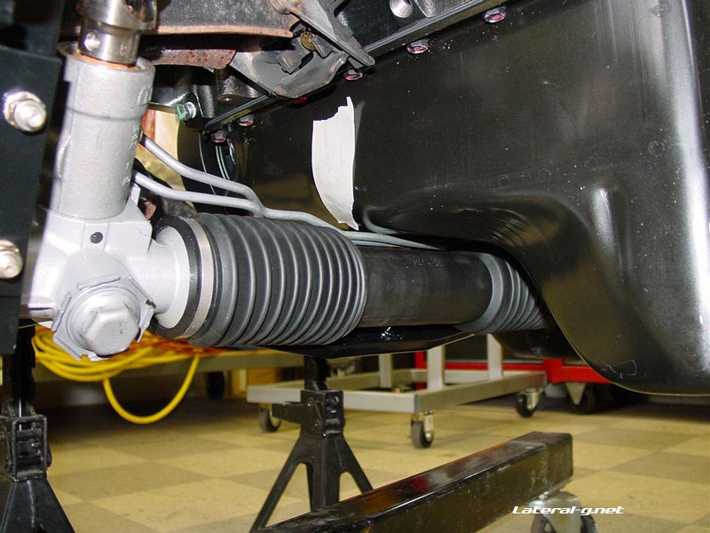

- Power Rack and pinion steering
- Ron Davis Radiator/Fan Assy.

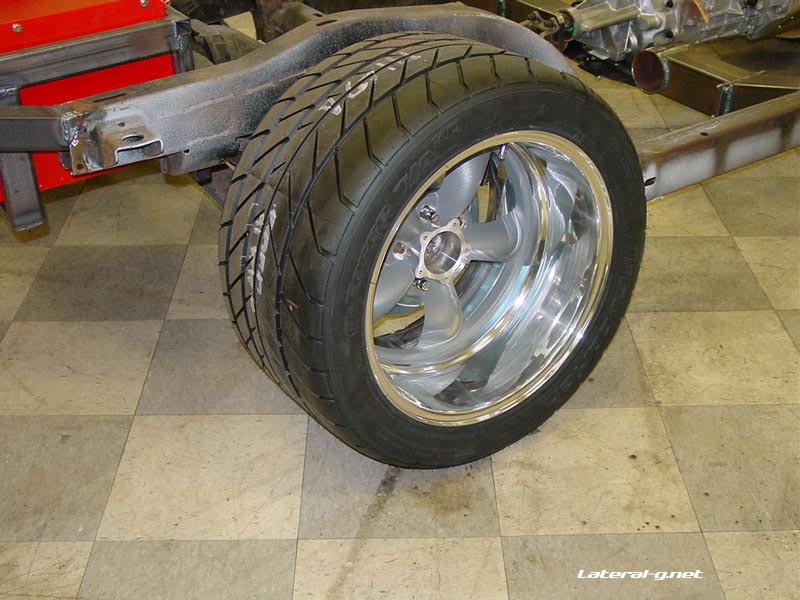

- American Racing Torque Thrust D Wheels 17X11R,17X9.5F
- BFG 315/35-17 R, 275/40-17 F tires
- Stainless Steel Brake Corp 4 piston calipers/ slotted discs
