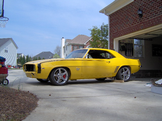

I had an aluminum headed big block 454 with a procharger that I planned on
swapping in and that is where the problem started. Since I am here I might as
well smooth the firewall and while I am at it I think I will put a 6 speed in
it�and on and on. What was a motor swap turned into a 6 year project. All of the
outside sheet metal was replaced with NOS GM stuff and I mean all of the metal.
Quarters, tail pan, door skins, fenders, upper and lower valance. The floor,
trunk pans and roof skin are all aftermarket. The deck lid and SS hood are used
Gm pieces. Chris Reed is responsible for the fantastic job on the panel
replacement and body prep. The 454 was traded for an LS1/T56 combo. The stock
sub frame I had converted with DSE stuff was sold to a friend and a 21st Century
piece was put in place. I have bought and sold 4 different sets of tires and
rims for this car until I settled on the C6 package. The LS1 motor that I traded
for was sold and I scratch built another LS1. You have all been there�where does
it stop? You start in one direction and end up in another. The car just took on
a life of its own.

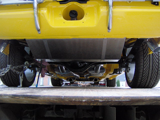

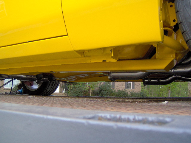

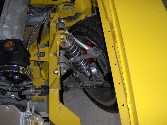

Highlights:

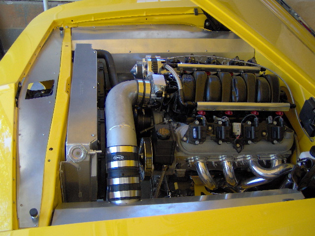

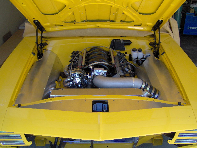

LS1 built with forged pistons, TEA heads, H beam rods, ARP studs on heads and
main, FAST 90 with Nick Williams 90 TB

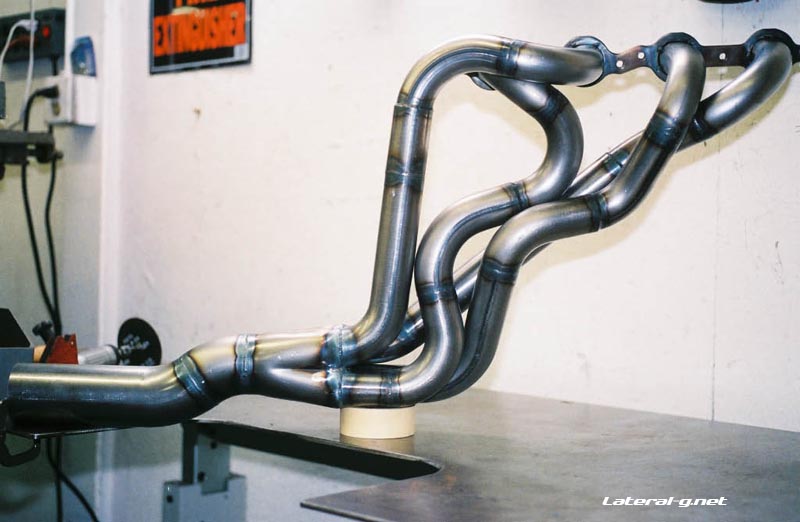

Custom headers and exhaust by Jim Pettigrew

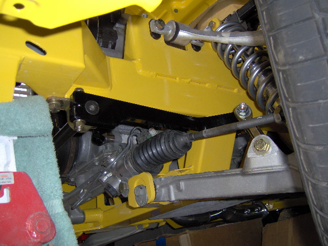

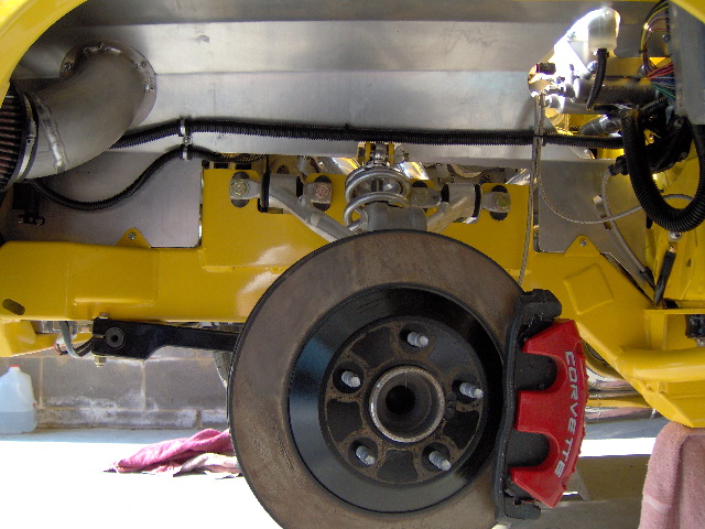

21st Century sub frame with a 1 inch drop using C5 suspension and splined sway
bar
Mini tub, 8 point cage and DSE sub frame connectors
Rick's Hot Rod stealth series stainless gas tank
Ford 9 inch with 3.80 gears and Detroit tru trac and DSE 2 inch drop springs
Ron Davis radiator

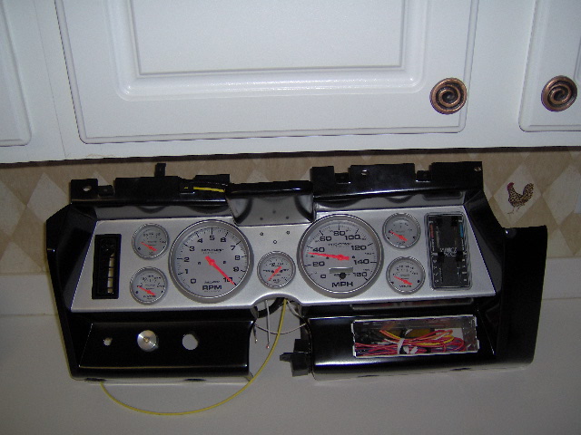

AAW highway 22 wiring kit
Vintage Air
