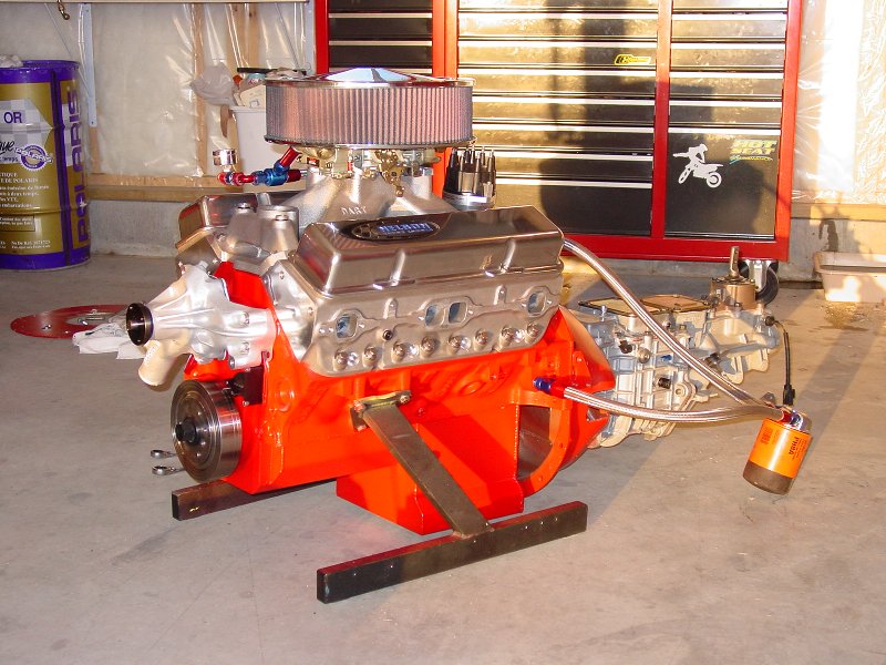

                                     My 434 small block Chevy
                                    built by
                                    Nelson Racing Engines. I'm using a Dart Iron Eagle tall deck block,
      a Cola crank with 4" stroke, 6.200" forged H-beam rods, JE forged pistons,
      a custom ground Comp Cams solid roller, Pro-Topline aluminum 235cc heads,
      a Moroso fabbed oil pan, mini-starter, a Dart single plane intake unique
      for the tall deck, Victor water pump, remote oil filter, an MSD Pro-Billet
      distributor, MSD Digital 6+ ignition, MSD wires, all ARP fasteners.  |
