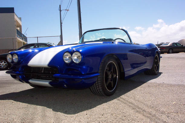

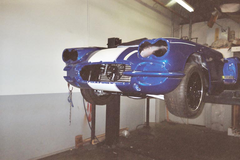

James and Sandy Eudy's 62 Grand Sport Corvette

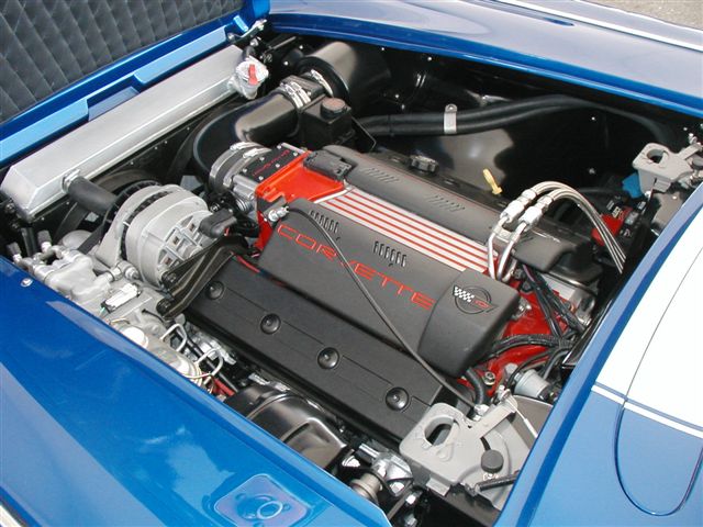

It has a 96 LT4 stroked to 383, ZF 6 speed, hand formed rear quarters stretching each an
additional 3 inches.  It has electric windows, a carbon fiber grill insert, a hand built console,
VDO gauges, custom formed seats, black leather upholstery.  There is almost no chrome on

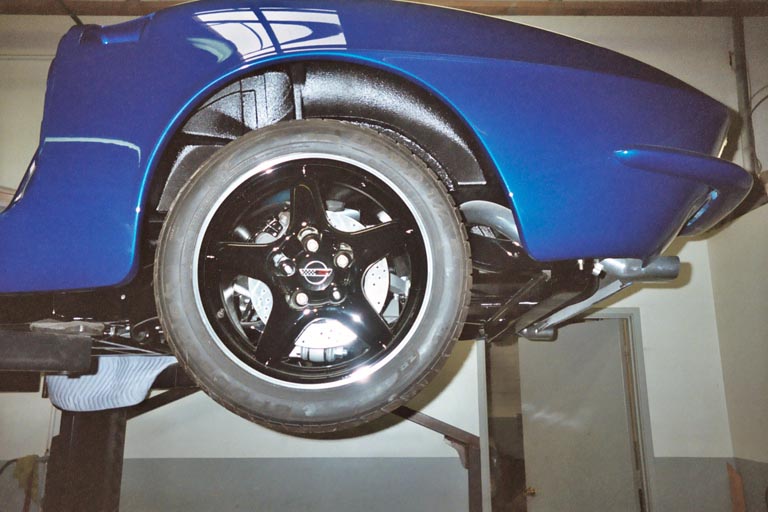

the car.  It rides on all C4 suspension that is silver powder coat/clear coat.  The brakes are
Baer, a Dana 44 rear with 3.73's and carbon fiber axle shafts.  The tires are 255/45/17 and
315/35/17 BFGoodrich Comp TA.
