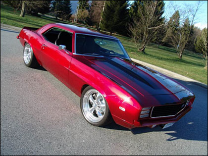

I was pumped and excited; we
shipped the car to my dads old furniture plant. There my friends and I started
the task of stripping it. As we were taking it apart I threw out a lot pieces I
had no clue I would still need. The Camaro was an original RS 4-speed V8 car, Ralley Green with green interior and a Vinyl top. It didn’t have to be a high
value car as I wanted to give it the pro-touring treatment. So I sold off the
327 and TH-400 it had in it (the clutch pedal was zap-strapped to the floor
boards LOL) At this time I realized how bad the car really was. I was motivated
though. The next thing was to have the shell sandblasted, and that is when I
really found out how bad it was. Gone were both the ¼’s (which had about a ½” of
bondo over the rust) the outer wheel wells, trunk ends, trunk floor, both full
floors, one rocker panel, both shock towers, the rear valance below the window,
even the roof skin had damage on the drivers side (under the painted on
simulated vinyl top) the tail pan was removed and repaired and the whole front
clip sheet metal was garbage. Well I needed almost everything new. Once I had
gotten my hands on some new full ¼’s I called up a body man I knew, Colin, he
did great work, and I convinced him to come take a look. When he first laid eyes
on the car and said: “tow it back to the junk yard and scrap it” I was kind of
offended thinking, what is he saying?? But he knew what lay ahead for me, and I
didn’t. Well he ended up doing the ¼’s in a whole 3 days! And I was excited as
the car started to come together. He didn’t want to do the rest of the work, so
I farmed out another guy to do it. Mike, this guy supposedly had a huge shop,
did great work and was reasonable for price. Well this is where it started to
spiral downwards; the car was brought to his shop. An old barn in an old yard
that had crap dumped everywhere, old
cars, wood etc. People were living in
containers and old trailers it was pretty sad. He actually lived in an old
trailer “down by the river” and had a dog named Fred?? I made
about 20-30 trips
out there to view the WIP only to find him not there, he didn’t have a phone,
was always drunk, it was a complete nightmare. It took him 6 months to replace
the floors, trunk, rocker, shock towers, repair the roof skin and patch some
other holes. And I finally had it back in my hands. 2 good original parts were
the subframe and 12-bolt. Once those were blasted and powdercoated we then got
her rolling after it was painted semi-gloss black inside and out.

During this time I also sourced out an LT1 & T56 to go with the pro-touring
theme. I had assembled all the parts to build a 383 LT1. At that point the
Camaro sat for a while, collecting dust for a good 2-3 years sitting as a
rolling chassis. I was too busy getting my business going, and my wife and I
were trying to start our new lives.
I then decided to sell the
Camaro project, having lost interest in it and having no money or time to finish
it. I decided to keep my 4th gen T/A for old times sakes. The Camaro’s motor and
tranny were sold off first. Then as I was trying to sell the car and turning
down useless offers, I pondered what to do. At this time, I was still trying to
enjoy my 4th gen, but it was telling me it was time to go. I replaced the stock
10-bolt with a 12-bolt from Strange, only to have it blow up as well (rear-end
#6). After that was fixed, a buddy I knew from a while back offered to buy the
T/A. Well we struck a deal and a few days later it was history. This sort of got
me going again on the Camaro.
In 2004 I built some custom sofas for one of my good friends, who happen to own
a body shop. We struck a deal to exchange the sofas for the paint on the car.
This was the spark that got me going again, since after the car was assembled
and painted I was on it steady for almost 2 years assembling it to the car you
see here.

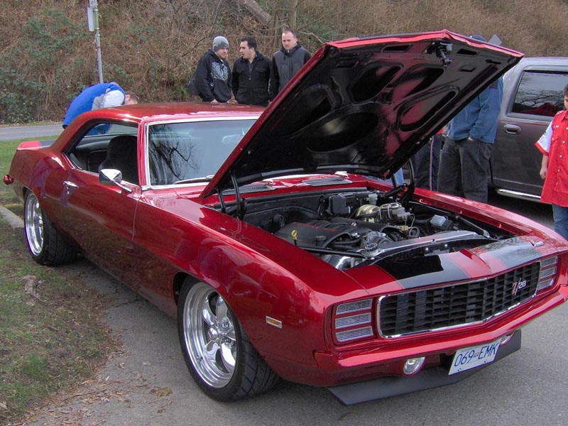

TECH SHEET
Engine:
- 2002 346 ci Camaro LS1
- TSP 233/239 112 Cam
- PRC dual valve springs, titanium retainers
& pushrod kit
- ASP underdrive pulley kit (crank & alt)
- TSP & Speartech custom tune
- S&P ceramic shorty headers (to be changed)
- S&P custom oil pan mod.
- LS6 intake
- Ron Davis custom radiator for LS1 with Dual
Spal Fans & custom shroud
- Custom 3.5” ceramic coated intake pipe w/
K&N filter
- Speartech custom modified stock wiring
harness
- Taylor 8mm wires
- 2.5” custom exhaust w X-pipe, Magnaflow
stainless mufflers and 3” rear exit tips, to be ceramic coated
- S&P LS1 engine plates with Energy
Suspension poly motor mounts.
- AC Delete
- Ricks Hot Rod Shop stainless EFI gas tank
with Walbro intank pump
- Braided -6 line throughout with Russell
fittings and 99+ Vette regulator/filter
- Expecting close to 400 rwhp on the dyno.
Drivetrain:
- 2002 T56 6 speed from a Camaro (came with
engine)
- Hurst Billet Plus shifter with Hurst Chrome
shifter stick, with white 6-speed ball
- ATS T56 install kit: Firewall plate, custom
cross member & hydraulics.
- Spec Stage III clutch
- Custom Steel driveshaft (made locally)
- Original 12-bolt rear end, Auburn
Pro-Series posi-unit with GM 3.73 gears
- Summit rear-end girdle
Front Suspension, Steering & Brakes:
Rear Suspension & Brakes:
- 3” De-arched Suspension Techniques multi
leaf muscle car springs
- Edelbrock rear shocks
- Suspension Techniques rear swaybar
- Global West Subframe Connectors
- Baer rear brake kit with drilled/slotted
rotors & e-brake
- Lakewood driveshaft loop
Wheels & Tires:
- American Racing Polished Torque Thrust II
- 18 x 8 fronts with 5” BS and 245-40-18 BFG
G-Force KD tires
- 18 x 10 rears with 5.75” BS and 275-40-18
BFG G-Force KD tires
Interior:
- Front APC seats redone in 100% black
leather, w/ custom brackets.
- Stock rear seat redone in 100% black
leather to match the front seats
- DSE Dash with silver Autometer gauges, 5”
Speedo & Tach, 2-1/16” water temp, fuel level, voltage & oil pressure (all
with red LED lighting)
- Sparco Lap 5 steering wheel with polished
center, Momo adapter and stock tilt column
- Lokar billet shifter boot w/ Hurst chrome
stick and white 6-speed ball
- DSE select-a-speed wiper kit
- Modo Innovations Aluminum Race pedals
- Factory black standard door panels,
headliner and dash pad etc (all new)
Paint & Body Mods:
- True Candy Red tri-coat with Silver base
and Black Z/28 stripes
- Marquez Design billet taillights (RS),
front turn signals, and side marker lights
- Smoothed & Painted rear bumper to match
painted front Endura bumper
- Rear ¼ Lips were rolled and inner wheel
wells clearanced for 10” wheels
Sound & Electrical System
- JVC Faceplate CD & MP3 player head unit
- Custom ported Baltic birch sub woofer box
w/ dual 8” JL subs
- Custom rear deck lid panel (black grill
cloth so no speakers are visual)
- MTX Thunder Series Amp
- 4” coaxial speakers mounted in OE kick
panels (custom pods mounted in body)
- Rear mounted Optima red-top battery w/ box
- New Painless Chassis Wire Harness
- Custom mounted PCM under dash
- LED lighting (red): interior, side markers
& gauges
- Compustar Pager Anti Theft system with GPS
option
- Under dash antenna
