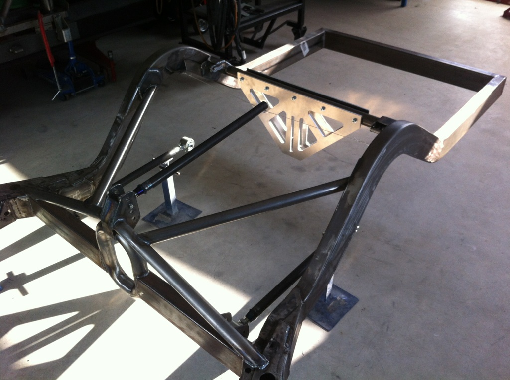

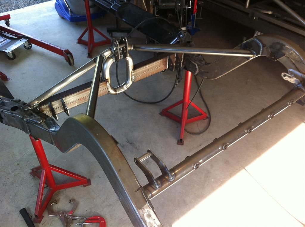

This is something I've put a hell of a lot of thought into. I'm wanting to get the car out there as much as possible and that means making it dual purpose.
I ended up going 3 link. There'll always be compromises but this this is how it looks so far:-

To be honest thats exactly how i was thinking i was going to do mine for the last year but i since mine is not an A body or other full frame car, i was gonig to cut my back seat in two and create a console and tie it into the roll cage. lately though i have been thinking really hard about the torque arm setup. Your work looks very nice btw.
