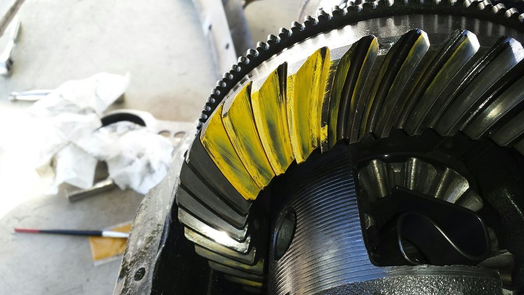

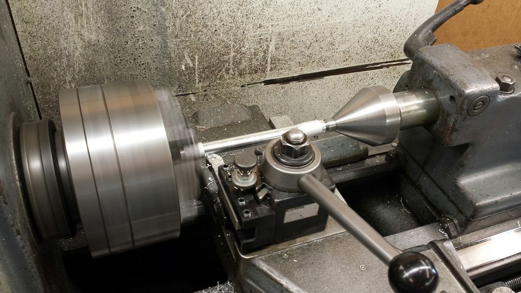

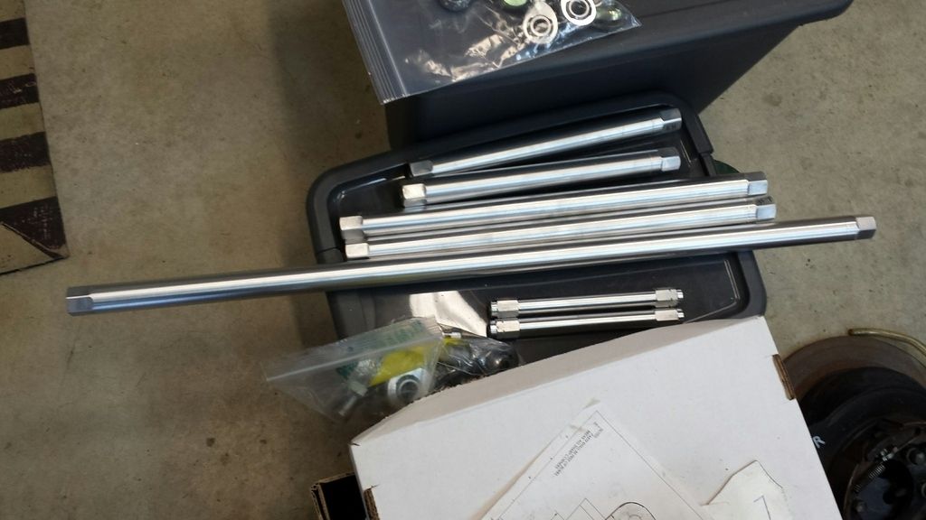

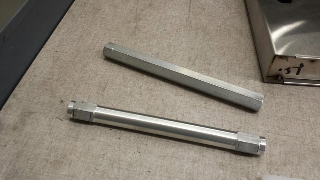

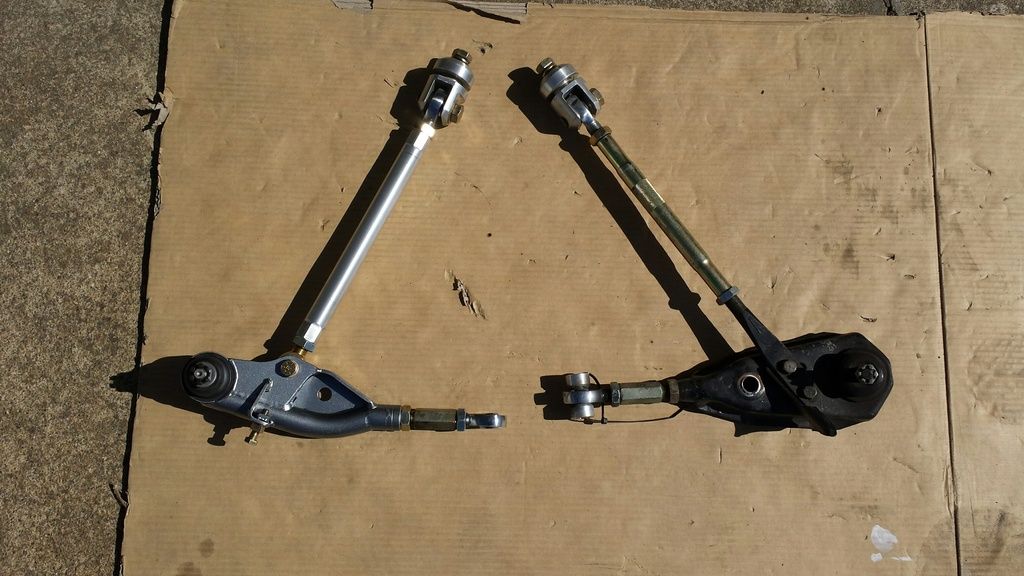

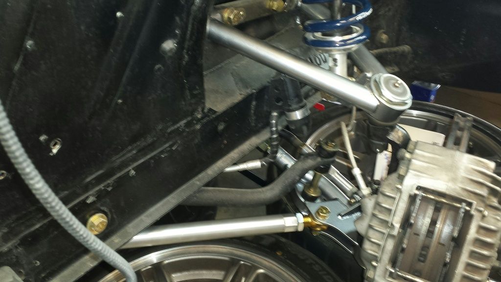

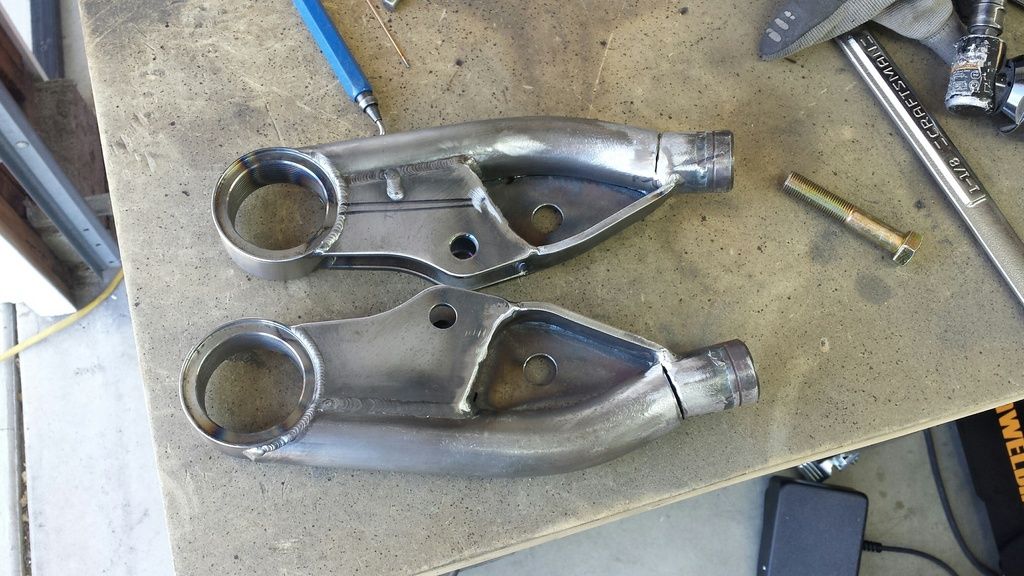

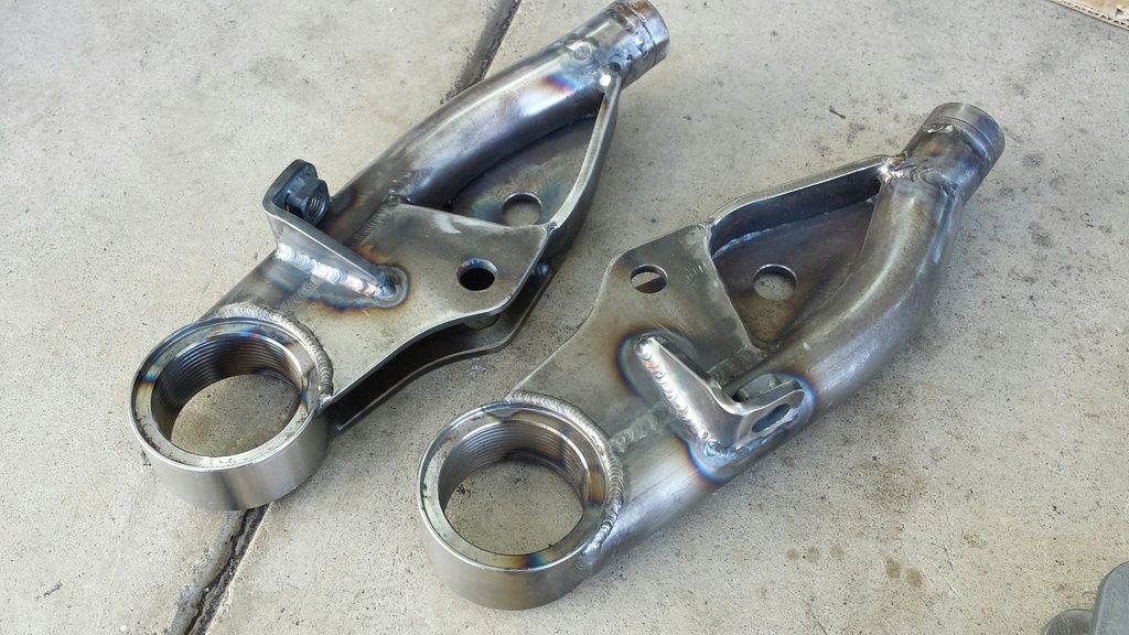

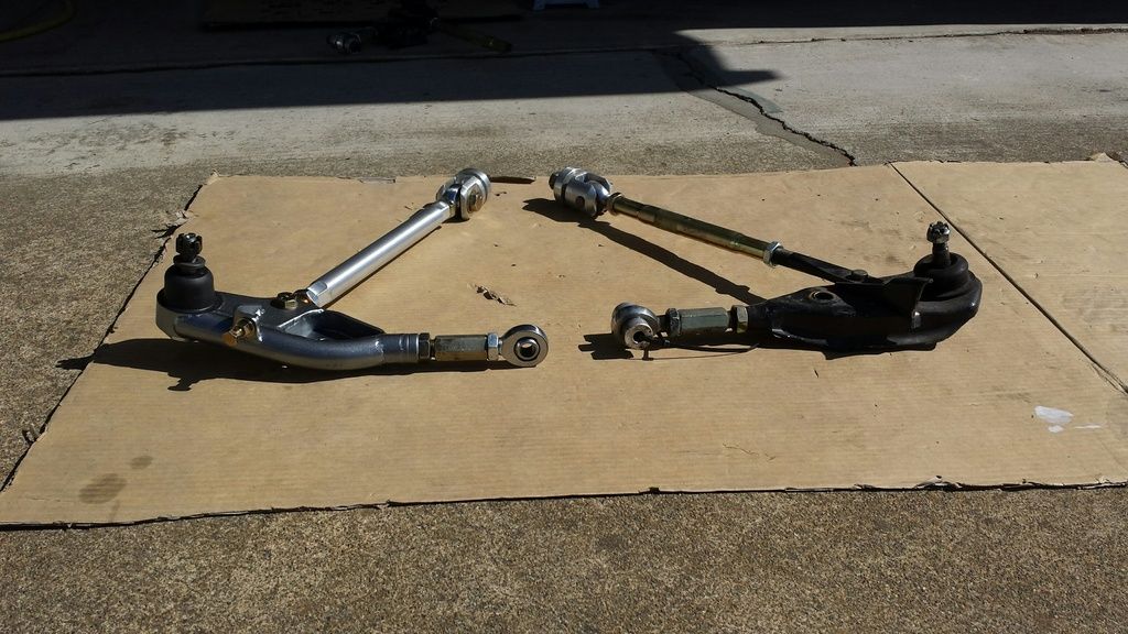

Keep making slow progress. Finished up some extra special lower control arms, checked the pattern of the gear set (before welding on the housing and installing the locker). Made some aluminum rods shiny, added some style to the hex rods and added the grooves to indicate the LH heims.
The gas lens definitely helps with seeing the weld and keeping it clean.
No real geometry change, but they look a lot better than my garage built ones.
Just need to match this. Most of the time with 8.8's the factory shims drop back in and you are good to go.
