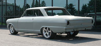

Engine:
427 cu in 4.125� bore x 4.00� stroke
All aluminum LS1 block with Darton MID sleeves
4.00� SCAT Billet crank
Callies 6.125� Connecting Rods
JE Custom pistons w/-29cc dish. 2618 alloy
AFR 225 cylinder heads with Inconnel Exhaust Valves
Custom sheet metal intake
90mm throttle body
Custom 1 �� 321 stainless steel headers
Twin T60-1 T4/T4 built by Innovative Turbos
Twin Spearco Intercoolers
Custom 3� exhaust
Big stuff 3 DFI for management
Estimated hp: 1000-1200 flywheel
Transmission:
HD 4L80E
