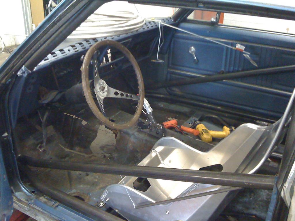

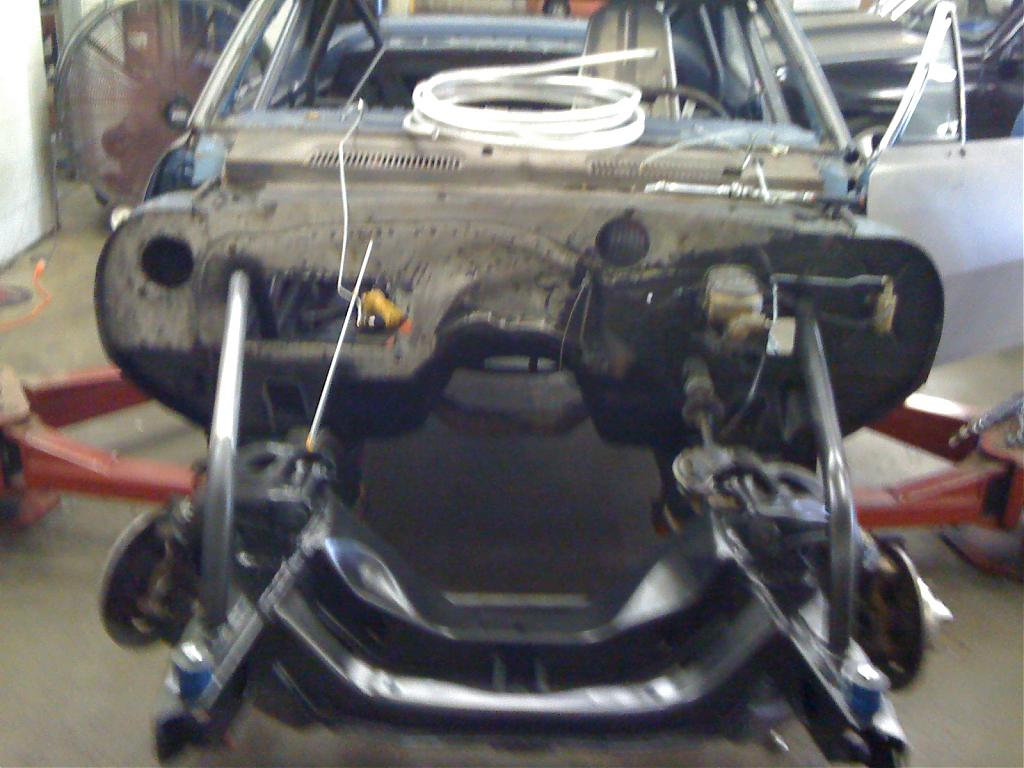

I just got the car back from Riffel Motorsports in Newton Kansas and I cant say enough About how happy I am with the way it turned out. He installed a 10-point cage, tied the subframes and did it all in chromoly and tig welded everything. Will certify to 25.1 (8.50). Eventually I will have it updated to 25.5 (7.50).....talk about overkill.......!!!!! But will eventually step up to more cubic inches and big block to boot.

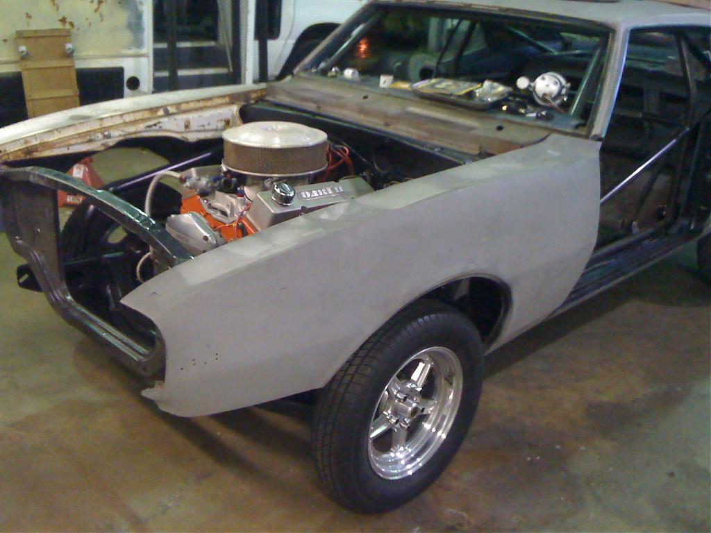

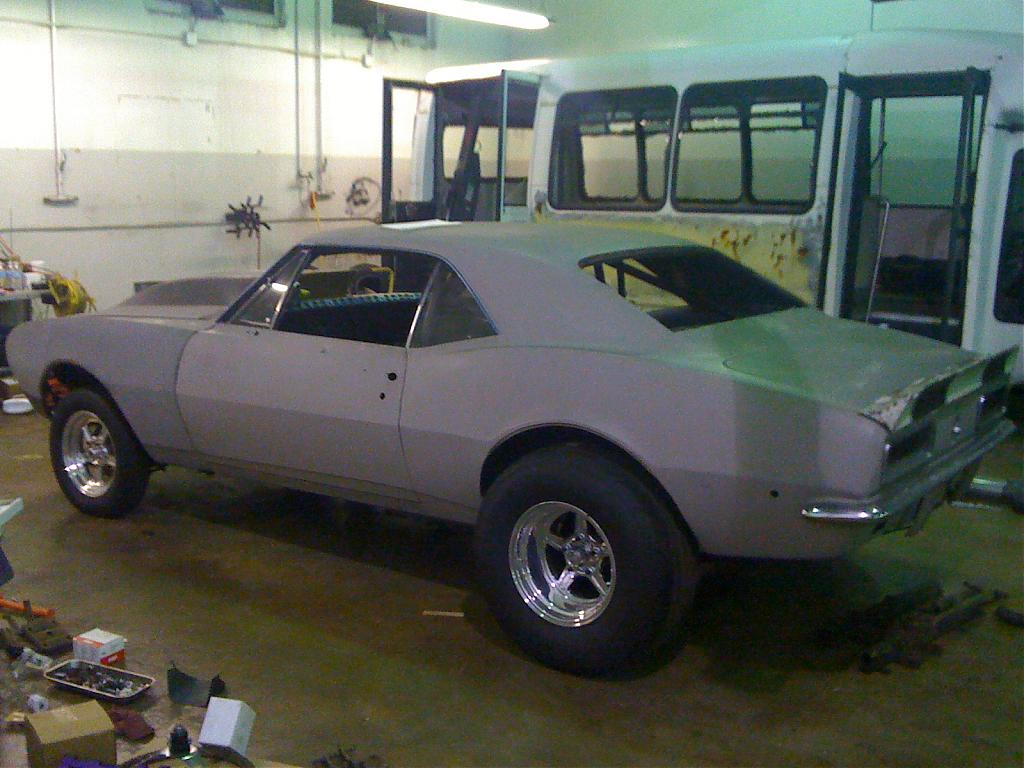

This car has been a bracket car since early 1975 so it has absolutely no rust ever but the rear wheel openings were clearanced for 13X31 slicks and by the way it is really a firebird that has been turned into a camaro, every panel that was different has been changed....even the taillight panel

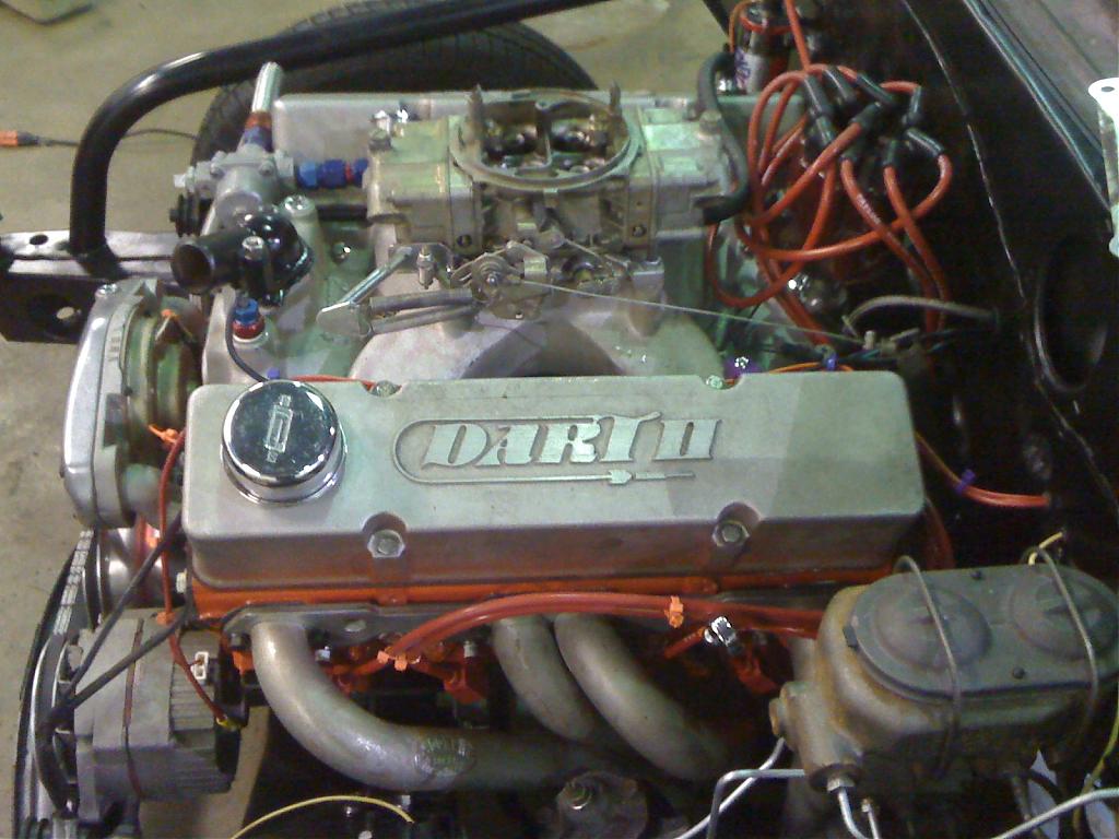

Time for an update.....I finally got the motor and trans set in ....... and I got it fired up.......YAY.......nothing renews interest in a project more than getting it running if you ask me.. My best friend from kansas came down and helped me this past week .....And I do have to say without him being there and pushing me it wouldnt be to the point of where it is now. We scratch built the wiring harness....mainly because it will spend most of its time on the dragstrip and we added an electric waterpump , fan, line lock , trans brake and all MSD ignition. Still waiting on rear differntial pieces to show up.....they ordered the wrong pieces and are reordering them. Have a little more plumbing to do for the rear brakes. Starting to hang all of the sheetmetal back on it now....I can actually see the light at the end of the tunnel now that almost all of the fab work is done....Then it will be time to make it look good, but I think we will work the bugs out of it first. Here ar a few pictures too....!
New update....Got some more done, hung the front sheetmetal and doors, still have some alignment to do, But we are getting closer..
J2 I dont think I will be changing the front suspension, I just rebuilt it with all moog parts and the subframe is now welded to the rear by way of frame connectors....I do have another 67 I would like to put an aftermarket subframe in tho. Here is some updated pics , The hood is a glastek 6" bolt on for those interested in what it is.....Yes it is TALL....!
Cool. I didn't know if you were going to change control arms to like the TRZ units. Making the car have alot more negative caster is a good thing on the drag strip.
J2
Once I recover from all of the money I have spent lately on this car I will eventually go to some kind of aftermarket control arms and other lightweight pieces......just need to save up some more money... The paint plans are 67 Camaro Plum Mist Poly and then a white nose stripe and parchment deluxe interior with seat covers for the kirkey seats to match factory deluxe seat covers in white with a black stripe, I plan to badge it a SS-RS Big Block once I get the 427 I have freshened and installed...........someday
