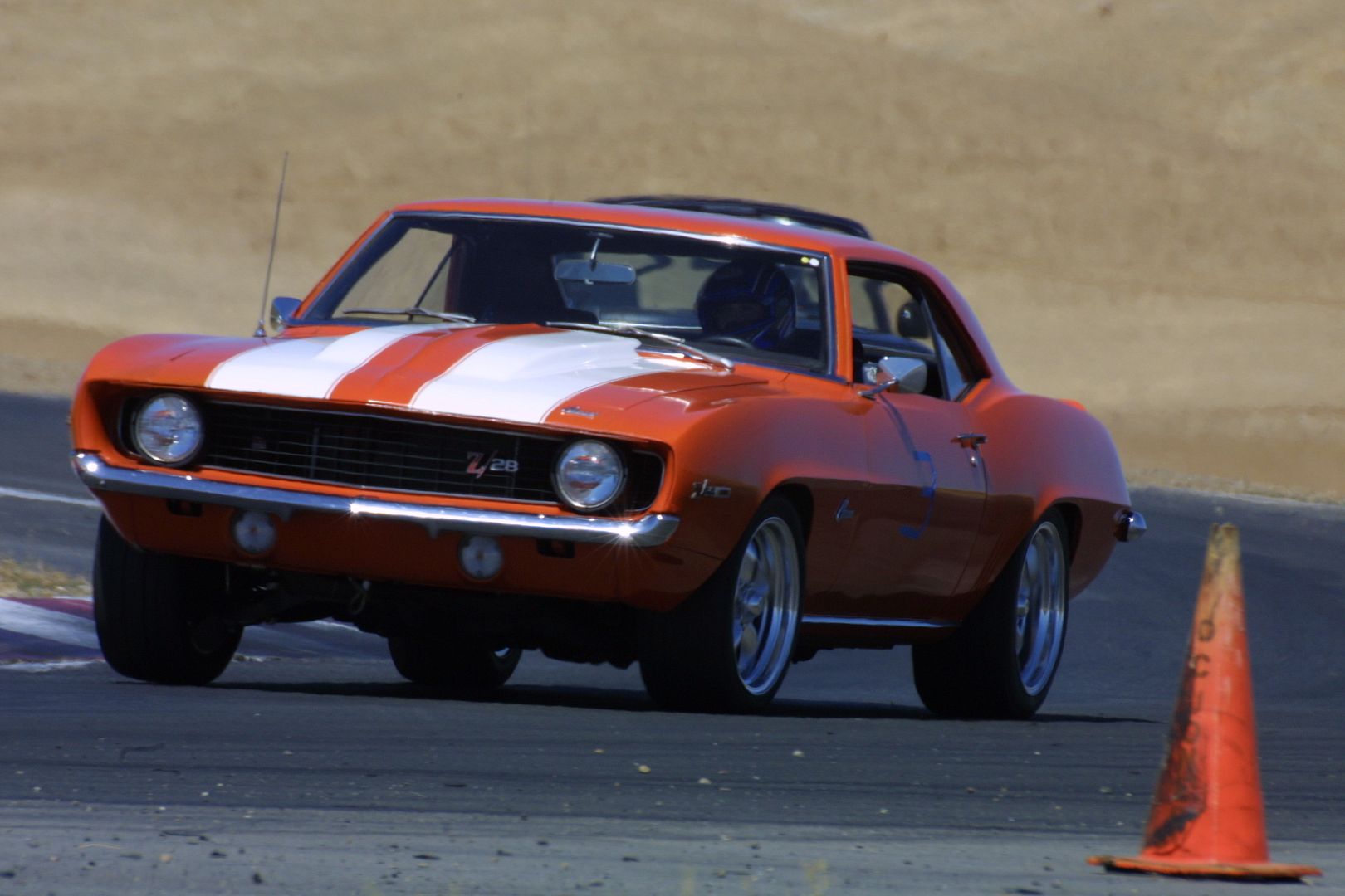

I ran NASA HPDE's up until 2004 or 2005 and then they started the Time Trial group.
Here's a couple of pic's running Time Trials in 2006. By this time the roll cage, DSE subframe connectors, and new 383 with 500 hp was in.
2006 would be my last year racing the car as other priorities would take place.
